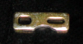

The Day of Gremlins!
  • Before I headed out, or tried to… I screwed around trying to figure out how I am going to get an 11T on the freewheel. Finally after fussing about I just went ahead and put the DNP Epoch 8 Speed Freewheel 11T Small Cog that I had laying about. The original plan was to rip off the 11T and put it on the Shimano, but they are made by different manufacturers and have zero-interchangeability. For all the times I’ve taken the rear hub off and played with eh disc rotors – I had a good idea how to fix the spacing problem and nailed it on the first try. The DNP Epoch 8 Speed Freewheel is now mounted and spins fine; we are good to go on gearing ~ not optimum, but good enough.
  • Loaded the bike with the Hitch to take back to the Machinist for rework. Also loaded the charger so as to top off before heading out to Seattle Fabrics. Also took with me the Timbuk2 bags cos I think it’s faster to adapt them as 6-gun, er 6-battery holders; just needs a under-over sling and power cabling.
  • Reprogrammed the Primary-Front controller to 14A Battery/35 Phase from 20A/50A. I’m ready to go. :)
At 1:30 PM - head out the door and on down the hill, then pull out onto the main road. I could tell the launch acceleration was way down. Not a bad thing cos economy settings are often underwhelming, though the top-end was still viable. Hit a bump and lost all Throttle; dead in the water. WTF? :cry: Well – when this happens it’s typically the eBrake – and it was, only now the eBrake microswitch had lifted off the mounting. Arrrg! :x I grabbed the little leaf-part of the micro-switched and squeezed: Throttle returns ~ yea! :D OK – one hand on the throttle and one finger on the leaf-switches and try to turn around AND engage mechanical brake with other fingers to fight my way back to the hidden urban Bat cave.
  • It turns out there is more wrong than just a buggered eBike/Stop-light switch: My running light (aka Taillight) is also out. Now I have to tear into the whole belly of the beast to trace this out. Finally found the break right where the signals fork to go to the Trailer connector; broken solder joint.
  • Also all auxiliary voltages were periodically going out during this time. Crapola: Traced that to a cold-solder joint that enabled Aux power on the DC-DC converter.
  • Next – tried to superglue the microswitch pairs back onto the brake. Wouldn’t take, so I clamped it. This worked fine but now the switches were dead from compression. Grrrr. :x Pull the switches off. I have replacements as roller-leafs. This is about the 4th time the micro-switches have pulled off the brake lever. Resolved to use the two-hole mount – but I don’t have screws small enough. What to do? OK – mother of invention kicks in: I had some extra spokes and they fit the holes. Took the broken switch and using it as a template, drilled two holes into the brake lever. Next, took two good switches and as guides ran the spokes through them (butted ends up and threads down) and sorted out how they would integrate into the brake lever; it’s almost a tight fit mainly cos the drilling was slightly imprecise and creating tension – which is good. Pull this assembly out, apply superglue to the holes and surfaces, and reinsert the switches/spokes making sure the threads are in the holes; the mounting takes! Superglued the second switch down on top of the first. Took a cable-cutter and trimmed off the protruding spokes; it left a 1/8” high nub and I ground that off and filed it down nice. More superglue into the mounting holes; suck it up bugger! Now we have a firm fix on the little f@#ker. Tested the swithes – they are a little flakey. Grrrr. :x Test test and more test. OK, I think it will work so I solder them up, heat shrink, wrap tape, and test: nuttin. Arrrg! Test test and more test – finally they work.
  • Hook up the bike, put everything back together except the front faring and go test. Nuttin works. More hair falls out – and I only have three skinny hairs on this pointy head. Fiddle about fiddle about fiddle about – finally switches work… some of the time. Go for road test, up the hill (economy-level kinda sucks compared to yesterday). Then the controller kinda figures out “Hey, I got an ebrake!” and begins to work consistently. I swear to all the sacrificial barleys that I have consumed in the past week that these controllers have two more brain cells than me and are conspiring to frustrate my process. I think we need to sacrifice more barleys tonight.
  • Did the horseshoe loop up the hill and down and back up again (it really is a good torture test); everything seems back to normal… except the Time: It’s now 5:30 PM and I have lost the initiative of the afternoon. :cry:
D'is is da pesky critter after rework. The two "posts" that secure it to the brake casing are just beneath the electrical tape.

  • The Hitch Bracket – now with the bronze bearing is slightly wider due to the flange and washer, AND the hub axle in shorter than my custom axle (now mounted on the Trailer). Took a while to sort out the absolute minimum washers that could go on to the axle. As it turned out, I didn’t use washers. Instead I used the flat file and leveled the surfaces of the stamped-steel torque arms and put them on first, then the bronze washer, then the hitch bracket, and finally the nut; that’s all the room there was, and no threads left to spare. This was all tightened down and then I worked it over making sure the nut would not back out.
    Right side rear stamped steel torque arm, modified to miss the rear derailleur mounting.
  • Also I removed the EBikeKit torque arm cos it was pointing in a direction that was not useful. Instead I used a modified stamped-steel torque arm, leveled on both sides, and then cut out a link from Aluminum angle and fabricated the clamp. These items were planted flat black and heat cured in the oven one the paint was dry.
