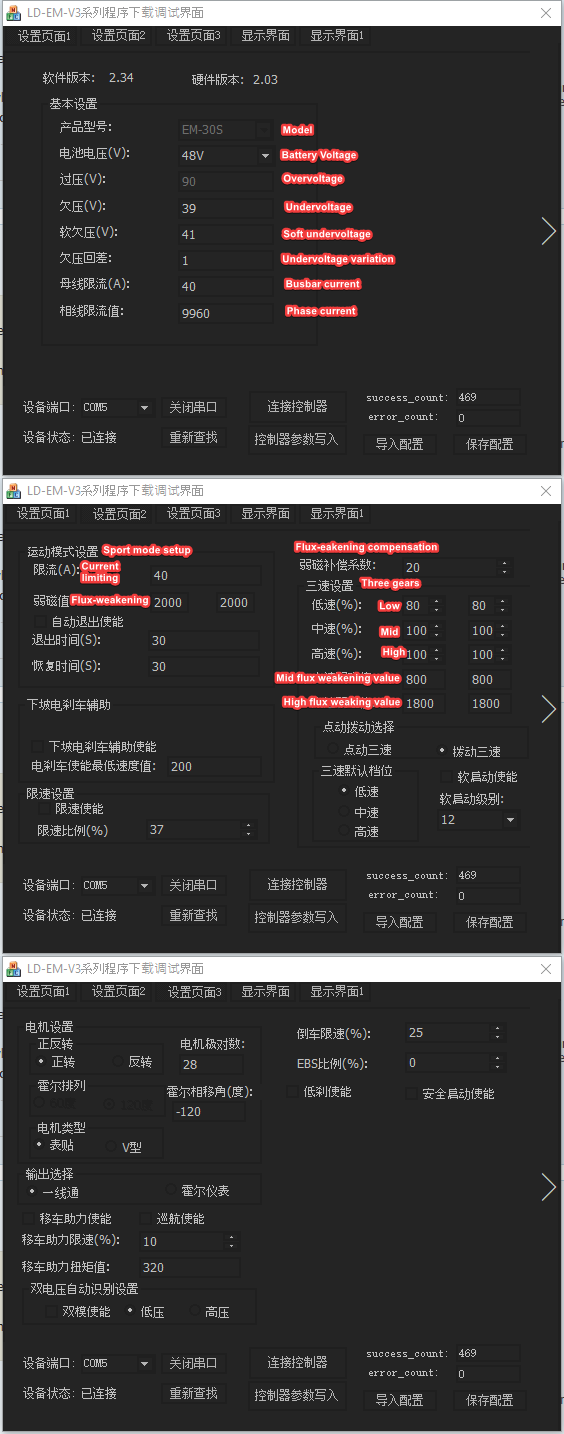

Hello everyone,
I have Xiaoniu U1 Pro e-scooter and I have replaced original controller with VOTOL EM-30S.
Currently my hardware set up as follows:
Engine: 800W
Battery: 48V40.3AH (54.6V max. charging voltage, 39V min. charge voltage, 45 A max. discharging current, 12 A max. charging current)
Controller: VOTOL EM-30S
I'm not a techy guy and do not know much about deep modification of e-bikes, as well as electric circuits. Originally a seller of the controller helped me to set up all the data. I use e-bike to get to work and back home, the route/distance is the same each day. Originally, when I have just bought the battery, about 7 months ago, I was able to use one charge for 3 days, but recently I'm experiencing an issue when my e-bike forcefully cuts the power off when there are still 20-22% of battery charge. I have changed Undervoltage & Soft undervoltage to 39V and 41V (originally: 41V and 42V), and both Busbar current & Current limiting to 40A (originally: 45A both). But it didn't solved the problem of force power cut with 20-22% battery charge.
So I have two questions:
1. What I should change in present controller settings (see the current data on the image below. I do not have English version of the flash app, but I can help with Chinese translation if needed), any way to optimize them?
2. What could be an issue that there is a force power cut when still 20-22% battery charge left, while at the very beginning I was able to ride on one charge during 3 days and use the battery up to 0%? (need to mention that most of the times I charge the battery on the second day, when there are still 40-45% of charge left. There were like 3-4 times when I ride on one charge till 0%).
Any help would be really appreciated.

that depends partly on stuff we don't know about the battery, like what kind of cells are really used in it (specific brand/model) to look up their manufacturer specs, hwo they're connected, etc.
but assuming these specs are "real" (not just marketing gibberish),
then 39v is a reasonable shutoff point (lvc), but you could change it so you are more like 3.3v/cell or even 3.4v/cell, which means for 48v pack (13s, 13 cells in series) would mean setting the controller lvc to something like
42.9 to 44.2v...but this will decrease your range at least a little.
if you could alter bms settings iw ould also change the balance start point to 4v instead of 4.2v, so it doesn't have to charge as full to do the balancing.
those two changes would, together, help the pack not have to swing as widely in voltage and state of charge, and would probably keep it balanced a little easier.
but you likely can't change the bms settings; it's probably all hardware with no programming. you can buy a new bms to replace it that does do this, but requries opening the pack to take the old bms off, and put the new one on. ther'es always risks doing that sort of thing, though minimal.
changing the charge rate to something lower, perhaps half of the present rate, would make some difference to pack life, though ti's already a pretty low rate for many cell types, so i don't know that it would be a lot of difference. would require modifying your charger; somteims tha'ts just a pot adjsutment, sometimes it is mroe complicated.
changing the discharge rate (controller battery current) to something lower, would also help, by decreasing the heat generated inside teh cells, and decreasing the voltage sag.
but...it will decrese the torque you get from the motor, and slow down your startups and decrease our hilclimbinb agility.
to maintain 800w you only need 18-19amps at 48v; if the controller is presently set for the max the battery can do 45a, then you actually get about 2000w, dependign on voltage sag.
since the battery is the heart of the system, then if it's not up to the task, the rest of the system performs poorly.
similarly, if you reduce the system's requirements like the above, it performs less well than it did before,
so, you'll get less range with the lvc/hvc changes, and less startup torque/hillclimbing with the main current change, and longer charging times with the chagre current change.
it's al a compromise, so you have to descide which things are more important
