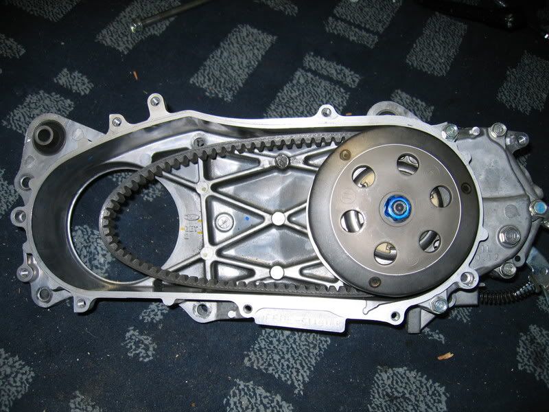

Here's my plan - I've done a smidgeon of research, and I've decided I want to keep the most 'stock' look as I can. Rather than swapping in a swingarm and a hub motor, I want to mount something like an ME0708 right where the stock motor was. I have a shapeoko3 dialed in for aluminum and don't think I'll have much trouble fabricating a plate to mount the ME0709 on the stock swingarm. I'll ditch the belt, retain the stock final drive gearset, remove the centrifugal clutch, and direct drive from the output shaft of the ME0709 to, say, a 12 toothed sprocket, then to the final drive shaft something between 60 and 70 teeth, whatever fits and works well.
Here's the inside of the swingarm in question:
The hole at the far left is where the motor mounts, the swingarm sits on the left side of the bike. At the far right is the centrifugal clutch, and behind it is the final drive. The final drive's output axle will mount to a stock wheel. I think with the CVT cover on, I'll be able to have the sprockets and chain invisible. Alternatively I could mount the variator on the output of the motor, but I can't imagine the stock CVT is going to be beneficial versus direct drive.
Before I start buying expensive parts, I wanted to make sure I'm 1) not off my rocker and 2) on the right track parts-wise.

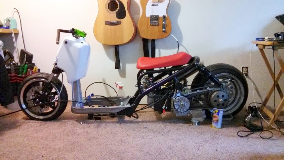

Sorry for the bad photoshop work but I didn't want to spent a lot of time on it. Knowing the wheels are 12'', it should be close to scale. So this is where you could make a steel or aluminum box to put the battery in and suspend it from the chassis underneath the seat. It might even be possible to install it a bit more forawrd if you need more room for the motor.
This sounds very good if you can make it all fit, and if you have really good fabrication skills to make it last.
Calculate the gear ratio to get the speed you want, rather than letting the space determine the gear size. I wish the top speed on my honda elite hub conversion was higher. This shouldnt be as much of an unknown while you build as I let it be.

Ruckus is ~3kw, 50cc drivetrain will not handle this power according to previous builder who tried a 80100 motor (7kw) scooter conversion with a dream to manufacture conversion kits. His bottom line was he had to scratch the idea - drivetrain too weak. Not sure it was belt, clutch or gears. Even if you get rid of clutch, you still use the gears - consider upgrading if you do. (The guy was russian, you should find if googling.)
Take the whole CVT unit off, build a swingarm to accept a 13'' 8KW hub motor? 120 km/h top speed, and you get up there very fast with 350 Nm of max torque. It simplifies the build and minimal maintenance needed.
