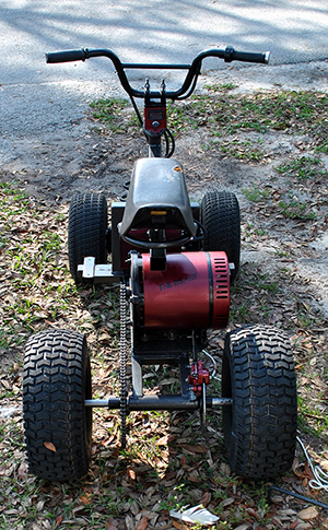

Last year I did a Razor Dirt Quad build, where I rebuilt the rear swing arm to hold a 54lb 9.5hp industrial motor and 4 12v 18ah batteries:
This is the motor next to a Unite 1000w 36v motor:
The build was a lot of fun and I ended up calling the project "The Beast" because of the size of the motor. In reality, however, I should have called it "The Wild Pig". It had a high center of gravity that made it handle like a pig on straight roads! I never got to open up the throttle on it, so I was disappointed with it in the end. I was thinking about lowering it by rebuilding the front suspension, but ultimately, I decided that it would be to much work.

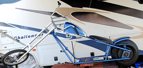

I decided to find a go kart frame to drop the motor on to and I went out last weekend to a 39 mile long yard sale down here in central Florida to look for a frame when I saw this:
It had a 5hp gas motor on it that I told the owner I didn't want. After bargaining with the gentleman, I got the frame for $40.00! Since I'm putting most of the hardware from the The Beast on it, I decided to call it "The Spawn of the Beast".

I got some work done on the frame today. There are a lot of holes from what appears to be two different gas tanks, as well as several others that I can't figure out what they were for:
I welded them up and cut off the fugly arsed repair job someone did on the foot pegs:
OK, I'm not the worlds greatest welder, but seriously? Whoever did this didn't even clean up the left over mig wire! Then I went at the paint with a wire brush attached to my angle grinder and a flap disk:
And then some black primer to keep it from rusting while I figure out my design plans:
Purdy!
The axle was a PITA to get out. One of the worm screws is rusted in. I tried using a propane torch, but that didn't work, so I'm going to drill out the center of the screw and try to use an easy-out to get the rest. I'm hoping to save the mount to reuse.
