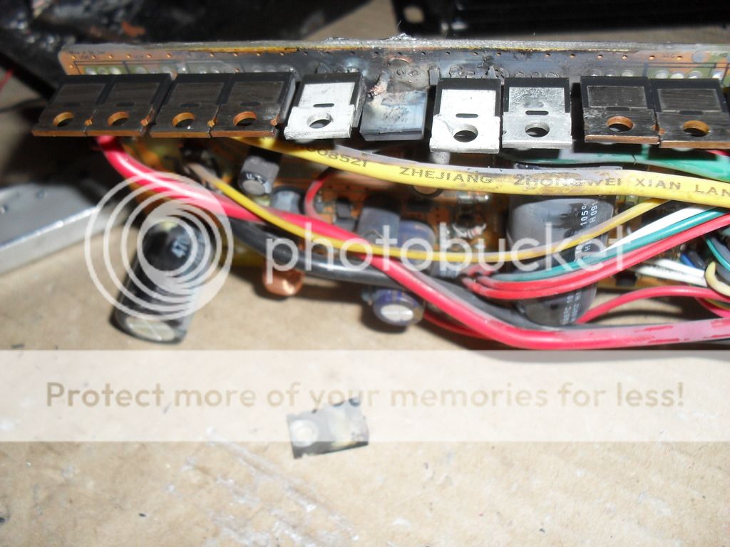

OK, I'm making some progress:
  • - I got the two (now new) USP500s to current limit with a breadborded "Version 3 Mini Meanwell Limiter" clone (many thanks for posting the design, Fechter!)
  • - charged nicely to 91.5V (for now) without popping a breaker, very satisfying 8)
  • - with that I could resume test drives, suddenly hitting massive cutouts on even medium acceleration...
  • - programmed the little 12FET to think it is a 18FET, 100A battery & 175A phase
    now you need to remember that it thinks it has three shunts, but actually still has two so we're scaling down by 1/3
    this nets 66A battery and 117A phase, CA shows peaks of 8-9kW
  • - this made medium accelleration reliable but on the occasional "reflex" WOT in traffic (bike is taxed and insured, thanks MCE!) the cutting out makes it too dodgy to use
  • - test drive went OK, but after 1km uphill the bike died, CA showing 10240W
    I thought I pushed the controller too hard and blew some FETs, so pushed the bike home
  • - tested the controller's resistances (=/- vs phases) and didn't find a fault...
  • - opened the controller and found the yellow CA connector cable (shunt+) disconnected - see http://www.ebikeschool.com/add-cycle-an ... ontroller/ for details
    that meant obviously the CA thought I had an overcurrent situation and "grounded" the throttle input
    in retrospect the 1024 (2^10) scaled by a factor of 10 do make a different sense now...
  • - soldered it back onto the shunt, took her for a spin in the neighborhood, only to have the same failure occur again, controller still working with the CA unplugged
I'm a little worried about heat now inside the controller (outside maybe 50°C at the FET mounting), as the soldering joint is solid here on the table at room temperature.
Any comments?

Post by marcexec » Jun 25, 2015 1:26 pm
Well I noticed a imbalance in the motor heat and pulled the top controller which needed a "nudge" in one out of three attempts, here's why:
