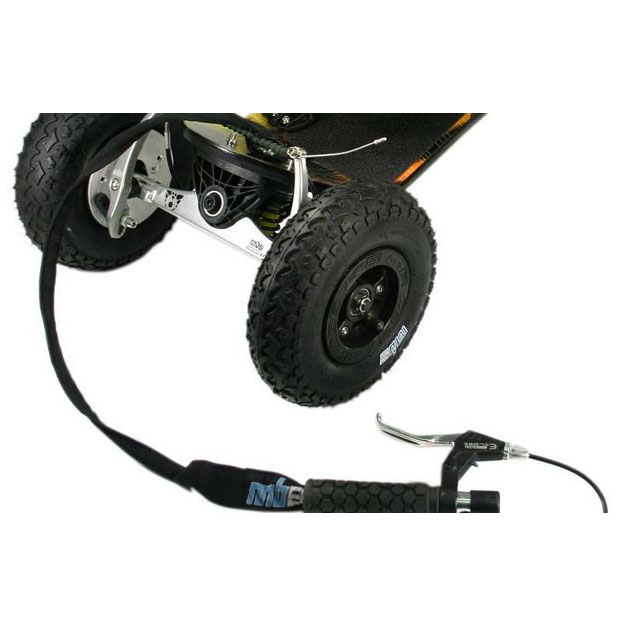

Fortunatly, given that the board was pretty fun even with its faults, I went and bought one of these a few days ago...
which will hopefully be here next week sometime. Then I'll mount up the 2nd motor (which should be easier with the brake parts I bought with it) and put the new controllers to good use!

their magura trucks looks perfect for adapting a motor mount plate...
they do, however the price is rather painful... about 4x the price of a standard truck. I got a good deal on a standard truck setup with the brake disk, bolts and spacers (to make mounting a sprocket easier, compared to fabricating all that stuff myself) and I've got a pretty easy way to mod the trucks to take 2 motors. Just have to hope now that the pictures ive based the idea off weren't too misleading.
Trampa boards, by the way, were fantastic. Answered all my questions, were knowledgeable and helpful, then when I ordered at about 11am their time... shipped by 3pm THE SAME DAY, including drilling out the deck to my custom requests. :shock: :D :D :D
