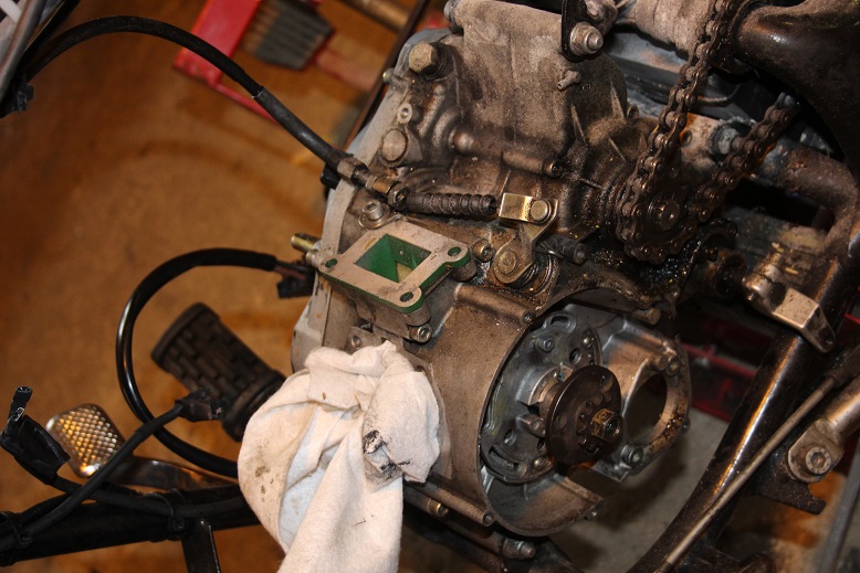

In early 2015 i began to "transform" my old small D.I.Y Costum Moped into Electric drive, meantime 2016 i made some improvements .
Orignally it was a APRILLIA RED ROSE 50cc also Called... Aprillia Classic
Now i called it the "Transformator" :lol:
For my Project i order a HPM3000 48volt 80amps Motor from GM and two 52volt 20amps Lifepo4 (Factoryname:Wolong) (Delivery Time was about 60 days in realtime!?)
Meanwhile i work with a smaller Test Motor .
The first Prototype (test phase) works with a cheap 1600Watt(Input2000W) BLDC and a EVO- OKW16P-4 Controller .
I only take this Motor and Controller for testing the self made construction of gearboxadapter and sprocket

Before the Bigger Motor arrivied i rebuild (tunnning) the Evo Controller .
I cut of the 12 Fet´s and wired the new Fets directly.
From the tuned Shunt the Minus(-) is wired directly to the Fet .... and the Plus(+) is also direct Wired so there is no real Power on the Platine so the thin Soldering of the Platine cant get even warm or melt down and shot the Circuit.
i know it looks agly but it work :roll:
Usually if a Controller was tunnend we use more Fets . I take less Mosfet i take six Fet but bigger one´s (TO-264 I=550A ,RDS 1,6mOhm(IXTK550N055T2) )
The tuned Controller works perfect i can touch the Mosfet under full load and the even get little warmish .
Also the RPM goes up to 4750 rpm before it was around 4150rpm .The Bikespeed goes up to !!

*) I change the front and rear Sprocket from 13/46 to 15/44(gearbox/tire) .
*) I change the sprocket from BLDC to Gearbox too ! Before it was 11/14 now 14/11

Thats true the first Motor(1600 watt) would fit perfectly inside the crank case .
But the HPM3000b was too Big for the crank case .
First i want to make Direct drive without Gearbox .
Later i read a article that says" little E-Motor run better with Gearbox" ......Big motor need no Gearbox they strong enough .
So i take this way .
