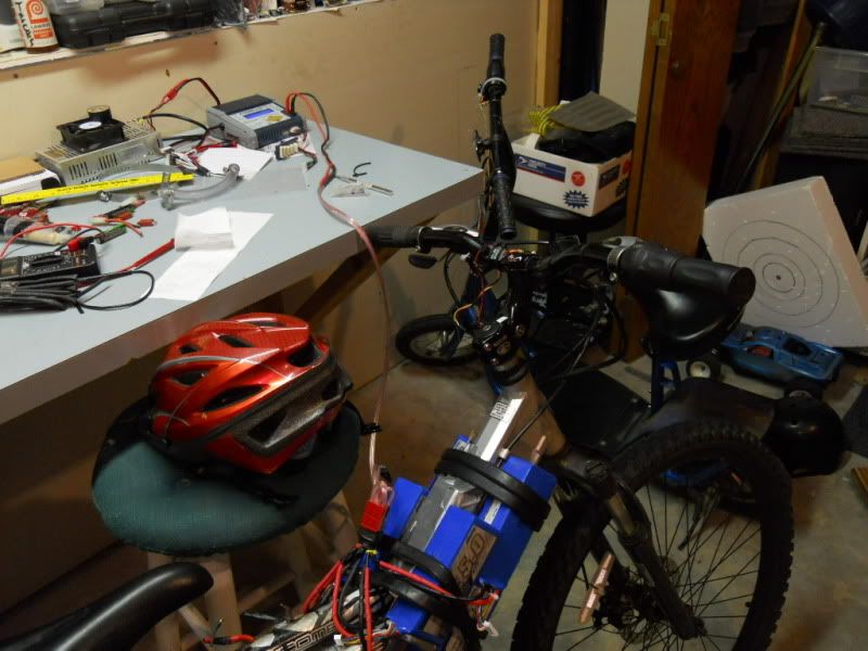

Do you ride your bike with these Lipo Packs exposed like you show in the picture?
DH
Battboy
Posts: 177
Joined: Wed Mar 04, 2009 4:15 pm
Re: Show off your lipo setup!
Postby Metallover » Sun Apr 25, 2010 5:25 pm
ATM I have a towel I wrap around them and I duct tape that to secure it.

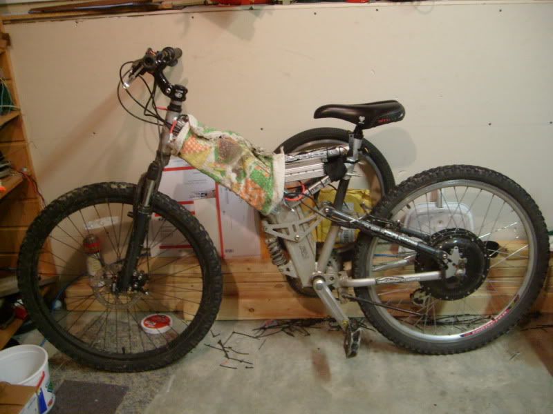

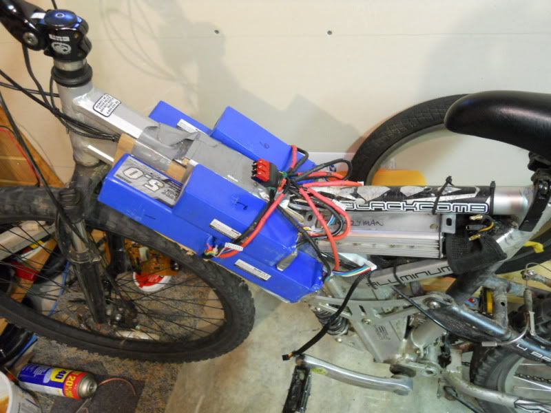

I (currently will be increasing) use 6x22v 5000mah 20c Turnigy packs 44v 15ah
weight is 11 pound or 5kilo. I use GGoodrum parallel adapter boards (see sig for link)
Here's a pic of my pack
And the cable I made to parallel the packs in series.

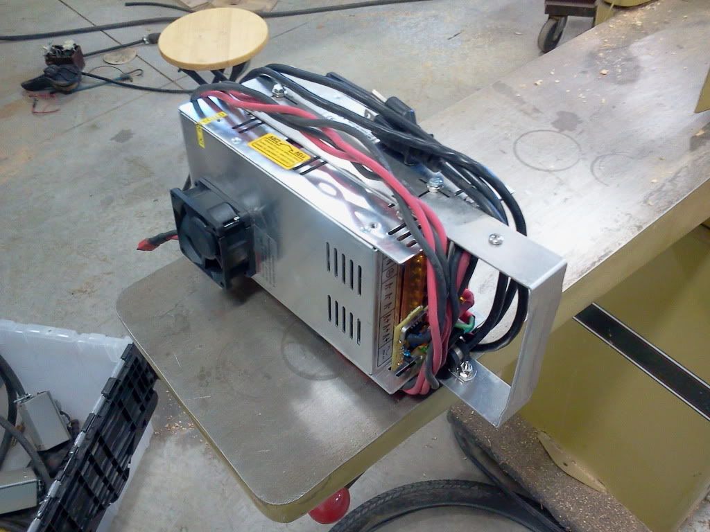

I use a meanwell 320-48v PSU to charge the pack (in series/parallel config) and a Battery medic to balance (will soon
have GGoodrum charge controller and battery medic mod .see link for these also)
Lipos are housed in a custom fiberglass enclosure i made.

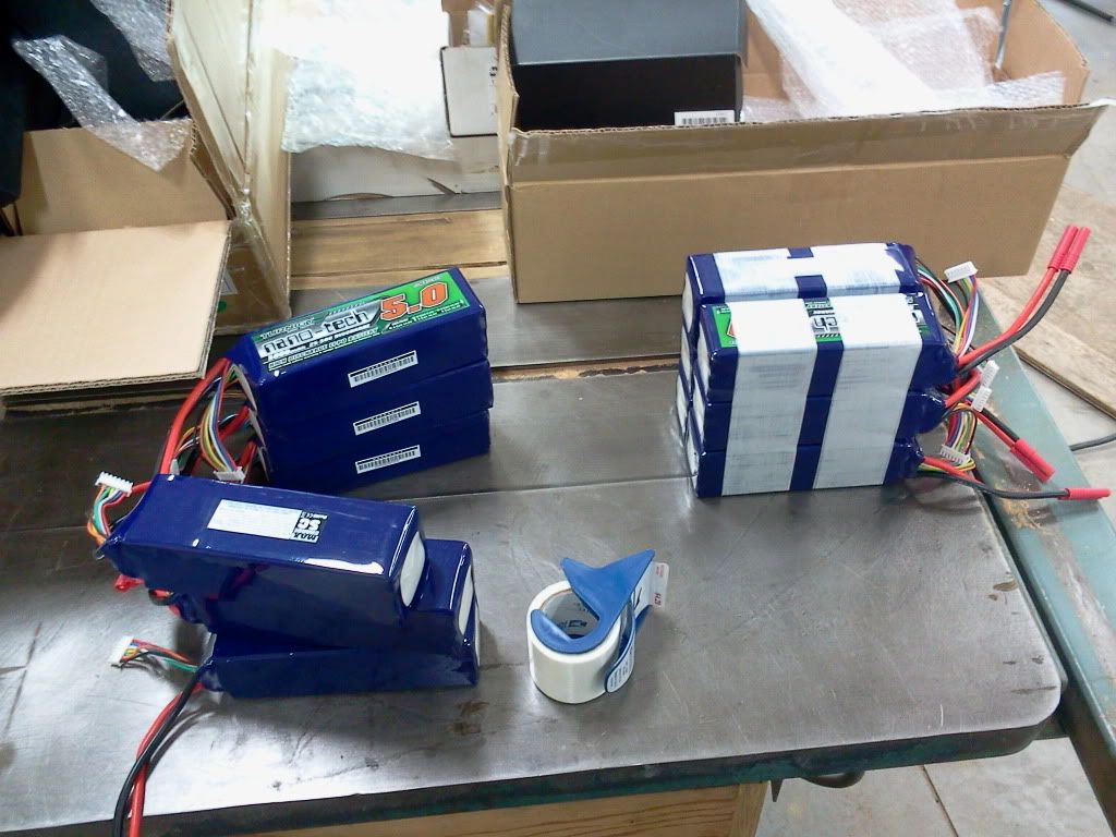

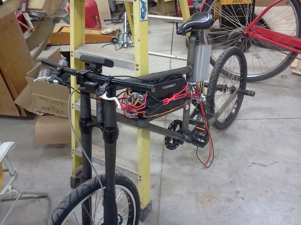

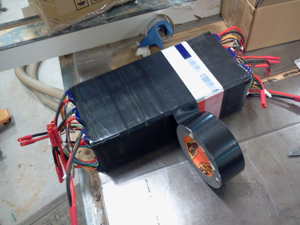

Postby Farfle » Wed Feb 08, 2012 12:33 pm

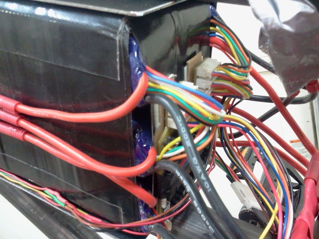

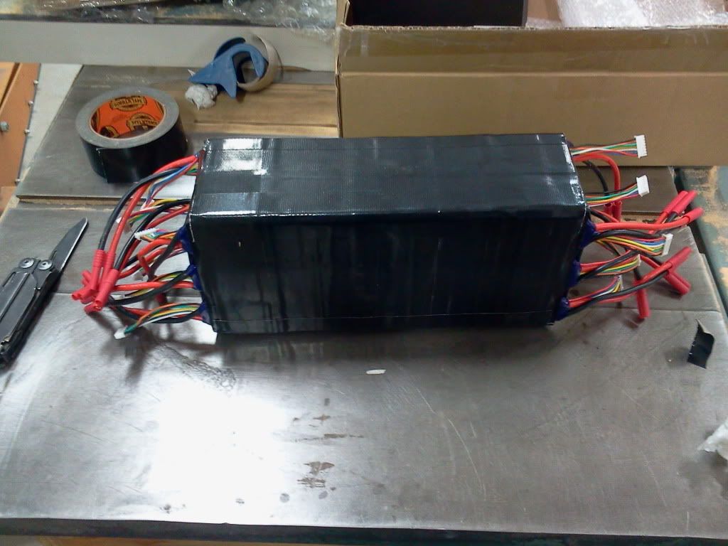

Heres my battery setup, 24s3p of turnigy nano-tech 50c packs. First wrapped in fiberglass tape to prevent expansion, then a layer of aluminum is added to the top and bottom, then the whole thing is wrapped in gorilla tape. it measures exactly 4"x12"x6" .Everything battery side is wired with triple paralleled 10 awg, and everything motor side is single 6awg. Its all charged with a ggoodrum/fechter "lite" BMS mated to a pair of 48v meanwells.
The race bike:
24s5p 50c nano tech
Peak power in : 318A at 91v
Peak power out: 24 Hp and 151ft/lb
