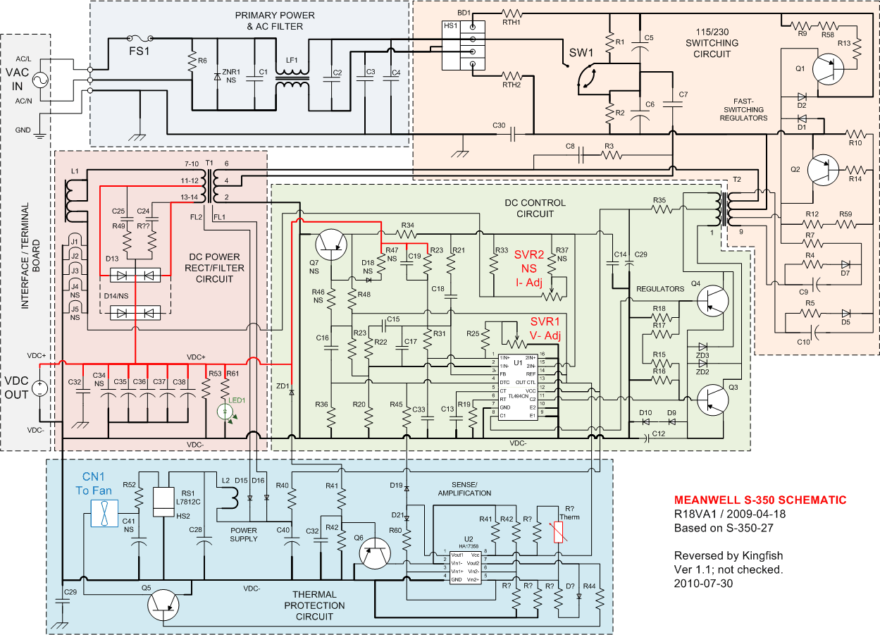

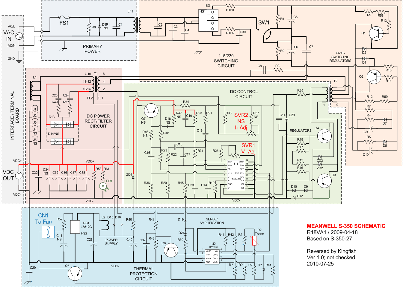

Shortly upon my return home I ripped out the S-530-27 circuit board, opened up Visio, and began to reverse the circuit.
Top-side of S-350 PCB. SVR1 is at the top-left, and SVR2 is at the top-right. The disconnected R33 mod is still visable.
In the center of the PCB you can see the 1k POT mod across the Thermistor.
Back-side of S-350 PCB.
Allow me to state that Visio is a flimsy bit of software for creating schematics; I miss the days of OrCAD, PADS, heck even AutoCAD could do a better job. But it’s the tool that I had on hand. So without further ado, here is the schematic for the S-350 series boards.
Click on the image to view the full size.
Interestingly one board serves all the models within this wattage range. Please note the board revision as yours may be older or newer. I can’t speak for clone boards; I bought the genuine Meanwell article, genuinely made in China.
:idea: With schematic in hand I now had a map to the device: The first thing I noticed is that there production adjustments to this design; little things give it away such as the ordering of resistor numbers and culling of parts (NS). It’s also possible that there was a cost-reduction performed, though clearly some pieces belong to other models (D14 lends a clue). One item not installed on my unit is the SVR2 and R37 which affects directly how much current the unit produces. Maybe early versions or models didn’t use R33; it’s all speculative. Regardless, after reviewing the schematic and spec sheets for the primary components (U1, U2, RS1, and Q1/2) I set about to put SVR2 back in.

Schematic Warrantee:
The diagram provided has not been cross-checked; being human I am certain that there are errors. If someone would be so kind as to check me I would be truly grateful. Also, there is no plan to create a parts list, however if you forward the values for components then I will add them. Lastly, I apologize for the lameness of some of the symbols I used; Visio falls short on electrical shapes and I just did the best of what I could with what I had. All the transistors are presumed to be TO92A and PNP; they need to be checked. Jumpers are not shown on the schematic (there wasn’t a convenient Visio symbol available).

Re: How-To: Meanwell 63-84V CV/CC Charger
Postby heathyoung » Sun Jul 25, 2010 10:05 pm
Kudo - Nice job, especially on the reverse engineering.
Postby mwkeefer » Mon Jul 26, 2010 2:46 am
Kudo,
Thanks for the schematic work... odd that your mods didn't work like the rest of us, perhaps you did the current limiting before the fan mod... the fan does draw current screwing with the compensation amps (op amp inputs)
I'll double check your schematic against my S-350-48 to confirm they are close or identical - document the variances and post and delta to what you have already :)

Postby Jeremy Harris » Fri Jul 30, 2010 6:40 am
Nice job, thanks for taking the time to make this diagram. I've spotted one snag though, LF1 isn't a transformer, as drawn, but a line filter. If you turn it 90 degrees in the drawing, so that the line and neutral terminals connect to the switch part then that would fix it.

Postby Kingfish » Fri Jul 30, 2010 1:56 pm
heathyoung, thanks for the suggestion; I will certainly check that out :)
Jeremy Harris wrote:Nice job, thanks for taking the time to make this diagram. I've spotted one snag though, LF1 isn't a transformer, as drawn, but a line filter. If you turn it 90 degrees in the drawing, so that the line and neutral terminals connect to the switch part then that would fix it.
Jeremy
Many thanks Jeremy! I know it's still kinda goofy to look at, but how's this? :)
And thank you to all for your support, KF

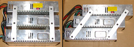

Postby Kingfish » Mon Aug 02, 2010 11:53 pm
Hydro,
The answer to your question is: I pulled a “Kirk” and changed the game towards my advantage. :lol: Allow me to direct you to the image below:
Left: Ready to operate. Right: Collasped for travel.
Firstly, I don’t care about the thermistor now because the lid is always off ~ as in forever, except when traveling (and even then it is not screwed down least it bar me from siphoning from a Pepsi machine…but I digress).
Secondly, I do not allow the vents to be covered: To ensure this, my assembly travels intact and ready to operate for any clandestine operation – I affixed four flat aluminum bars, two to a side as indicated in the image on the left, and allowing for a generous 1/2 inch air gap in-between. When traveling, to reduce space the whole assembly collapses nicely as indicated in the image on the right. Placing a small sheet of closed-cell foam between the units when collapsed reduces vibration damage.
And there you have it: Simply, effective, avoiding any possibility of fire, and yet still entertaining the hazard of electrocution which leaves some modicum of thrill when manipulating the device whilst it is energized. Hmm, yes, exciting is it not? :twisted:
The aluminum bars were made from one single piece of flat stock purchased at Ace Hardware, AND they have a good selection of metric fasteners. Best to take one of your units in for a proper fit (which is what I did). The screws are thumb-tight. Winged- or knobbed-screws would be a better choice than my dinky machine screws; meh ~ it’s on my Christmas list.
So to completely answer your questions:
I never place the cover on the unit when it is charging so it never gets hot enough to attract a moth. OK – I lied: I did find a dead moth snuggled up tight next to the heat sink when I went to extract the PCB for the shots above, but it was his fault for falling asleep and not mine. :roll:
If you block the hole whilst it is charging and you walk away… then someone should take your toys away. I mean it. :P
CYA: I never leave the room when the unit is charging even when the lid is off. Luckily I haven’t had any issues with batteries or electronics going south; when the unit is charging I am as attentive as a mother hen watching over her chicks, and this includes frequently checking the batt-pack voltage. When it is done, I unplug it. End of story. This is the way I use the device, and it is pretty fool-proof. :wink:
Since the mods, I have rapid-charged about every day; it is wicked-fast! I don’t let it approach the top voltage limit though; I don’t want to leave the unit running to find out if it will stop on its’ own. A smart BMS will help here. :idea:
Postby Kingfish » Tue Sep 28, 2010 8:34 pm
Schematic update:
L1 is linked to the center-tap of T1 (per suggestion by commanda)
Enjoy, KF

I'll repeat here what I posted in another thread on this topic.
The best way to have the fan run constantly is simply to pull Q5 & place a link Collector-Emitter.
This way the thermistor over-temp protection remains intact.
Amanda

Postby NeilP » Sat Mar 05, 2011 9:13 pm
Hi Amamda
yes, I had see that and it was going to be one of the mods, I have read all that thread you refer to (Switch Mode PSU Mod thread). Will look at the board and the schematic and see which is collector and emmiter when i get the boards out.
Rather than removing Q5 and linking the collector - emmiter holes on the board, I did wonder about attaching flying leads to the transistor legs and running them to a simple switch, so the permanent fan on can be enabled/disabled, just put a switch across C-E rather than a hard link.
Other mods were going to be :
SVR1 switchable between two values to give 38 volt (running iCharger) and 41.5 volt for direct charging
R37 SVR2 resistor chain also switchable between two values to give two current limit values, relating to the two different voltages.
Seem to remember my present R33 is 330 Ohm, so the value of R37 SVR2 for one current limit was around 2k..(.combined 282 Ohm) and 7k to give 315 Ohm. giving current limits of 9.4 amp at 36 volt and 8.4 amp at 41.5 volt. If I use a 4PDT switch for this, I can switch bot PSU at once, giving instant switching between voltage and current limit.
May add a CC/CV board in future from ttpacks when they become available ..again switchable in/out to use when I have the two PSU's in series ( 2 x 41.5) to act as direct 20s pack charger
Postby Kingfish » Thu May 12, 2011 7:45 pm
Addendum
Upon reflection, I had difficulty understanding why the current measurements came out the way they did, so I drew up a little schematic to explain to myself how and why. There’s a slight flaw in my spreadsheet, however the bottom-line remains unchanged.
  • Point-1: Total A/C current was measured.
  • Point-2: S-350 current was measured. This is incorrect: The measurement here is the entire SP-320 subassembly current.
  • Point-3: SP-320 (2nd in line, designated as “B”)
  • Point-4: SP-320 (3rd in line, designated as “C”)
Redoing the math:
If we presume that the 3.01A erroneously assigned to the S-350 unit was instead the total SP subassembly then it is clear that the S-350 unit consistently pulls about 1.5A (180W). Still well below the rated current. :wink:
In the earlier measurement at Point-3 where the value was 0.15A, I presume that the “B” unit never engaged, leaving the “A” unit to pull the load. When we added the “C” unit and placed a load onto it, the load could be split between B & C, without A carrying any. Regardless, none of these units are operating at rated currents.
:?: Why? :?:
Second Test
I went digging around and found my other battery pack, the one I strap on if I know I’m going 100 miles etc. This pack is 15S4P, and it still had a good charge on it since the New Year, though there was enough off the top for a quick test of the theory.
Just imagine the schematic above with the SP-320 units B & C disconnected. Made the inital measurements without a load and all was fine. As soon as I connected the battery pack the SP-320 (Unit-A) fan was off on a tear! The S-350 unit doesn’t have a fan; the cover is removed permanently. I had enough time to make the loaded measurements – but just barely, beginning with the total A/C current of the assembly. The battery was at 62.3V. By the time I got back to checking the total A/C current it had already dropped to 3.3A – indicating to me that the pack had already reached 63V and was now in the final conditioning phase. 8)
The behavior from this point forward was not at all like the previous test; the assembly continued to push hard to charge the pack and aggressively dropped the current. I noted at 0.54A that the fan had finally slowed down – maybe 15-20 minutes since charging began, and five minutes later I shut the whole process down as the fan turned to a whisper with the current drawing little more than 0.36A.
Therefore, I must conclude that paralleling Meanwell PSUs to create additive current does not pan out, and in fact may work against the individual sense circuitry to bring about a quick and resolute end to the charging cycle. :(
This brings me to my next hypothesis:
I no longer care about the thrift of my charger when the utility of the concept is an impediment to the goal and ultimate personal economy, the cost of which is measured as “my Time”. This leaves me free to entertain replacement in whatever form can be had.
I am still keen on Meanwell; they have a great product line and to date have served me well enough considering the pseudoscience of their employment in the present configuration (paralleled; that I can assure will change). However I am affirmed that placing these devices in series does work, though maybe not to the fullest extent by reasons yet to be discovered. Nonetheless, I am going to bite on this lead and configure anew with just two units, money no-object. It’s now a question about weight, size, speed, quality, balance, and cutoff – with alarm optional. That’s what I want, and I’m going to get it before I leave on my summer trek. :)
Stay tuned. KF
Postby NeilP » Fri May 13, 2011 12:29 am
Back to the Meanwells
Seems to me there are basic flaws in how you have them setup, and how you are measuring
First off, you have nearly 1000w capacity with the 3 in parallel. You then go and stick a 350 w unit in series with the parallel output, limiting the output of the 3 in parallel to that of the single 350.
The idea of putting them in parallel is to give greater current, then you have stuck it in series with the 350, so the max current through the parallel string is never going to be more than what is going through the 350. The NEW one in parallel will achieve nothing
Secondly, you are measuring input current. Measure the output current instead. I have two Meanwell S -350-48 in parallel, and the only way to get them to load share nicely is by setting them up monitoring output current of the two simultaneously while under load and tweak the output voltage of one unit till load between them is balanced.
You may find if you have not modified the voltage adjustment pot on the front for a multiturn unit , then it is almost impossible to balance the current. This is because the adjustment is just too course and inprecise with the single turn trimmer pot. I have 16 turn cermet pots on mine and even using them, a quarter turn or less either way, can be enough to push the voltage of one unit up enough to make it take all or almost all the load.
So, monitor output current, drop the new supply, it is not helping. In fact having even two in parallel with the one 350 is a bit of a waste. Try two series strings in parallel
