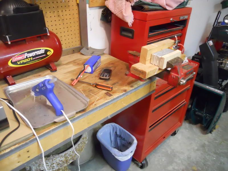

I had 4 x 22v packs that have been accidentally overcharged cellls to 5 volts
they have been sitting on my workbench for around 8 months i guess, i thought
i would salvage the cells still good today since i have stalled waiting for parts on
my 2 speed cruiser build I have also been asked about how i go about releasing (de-puffing) the gas from individual puffed lipo cells that have been over charged, by a handful of people now, so rather than explain it i
have made a small video showing the procedure i use. Nothing fancy, i HIGHLY recommend
though NOT using anything conductive like i show in the video a tooth pick is perfect
for this, you only need a small 'prick' to release the gas, you absolutely
don't want to press the pack too hard that fluid is released, you want just the gass out.
You can prolly gauge the pressure i apply in the vice, the lipo cell drops
from the jawz of the vice soon as the gas is released.
Now, I don't need a lecture on how "dangerous" this can be i am fully aware of the dangers of
lithium polymer, that said... I have been using ~12 de-puffed cells in my 44v 20ah pack now
with great success for the last 6 months, the capacity of the cells isn't noticeably different and
they all remain well balanced, PLEASE NOTE these are the new
Turnigy cells from HobbyCity NOT old no name brand lipos from years past
i would HIGHLY recommend not trying this on any old lithium polymer packs...
Hope this has been informative anywayz...

The gas is highy toxic and flamable by the way. So take em outside for the initial pressing. Once you get the first fart out in the wind, then bring em inside to put on the vise and seal up.
My puffy packs are doing ok, but not too puffed, and I cover em up with a bbq grill cover to charge, or charge outside. Not that many cycles on em though, less than 20.

You dont want to get oxygen or water vapor in the pouch, so doing it with Kims method is pretty good.
Definately for the bold only, but from Kims pioneering work in doing it sucessfully with good long term results, it seems to be a viable option.

One thing I wonder is hot melt really the best glue to use?
I assume it is good in that it seals the hole quickly keeping in as much solvent as possible but I wonder about long term stability.
Could it be covered with something more durable once the hole is sealed?
I know there is a higher temperature orange hotmelt we use to use at a former place of work that set much harder and stuck really well but not sure where to buy that stuff.

Ricky_nz wrote: One thing I wonder is hot melt really the best glue to use?
It seems to be holding up very well, the trick i believe is to lance/pierce your cell right on the crease line of the seal
of the cell, you then have the glue sealing the hole and it also glues the over lapping seam/flap down in the area your make the cut providing that lil bit extra security ;-)
What i also do with all my packs is wrap them 4x times as tight as i can with kevlar tape, it is near zero stretch tape, i then assemble the pack and again wrap the entire pack with 4x wraps of kevlar tape before connecting the pack up in my fiberglass highly flammable container for charging :wink: I shall keep the forum updated on any changes etc, but thus far after dozens of cycles they are performing as they should... Best of luck if you give it a try anywayz :-)

All the pressure you can get on them is great for the cell. As the layers get closer, Ri drops, and everything works better.
I put a cell in a large vise, was putting all my weight on the handle, then hit the handle with a sledge hammer to squeeze it tighter, and still it wouldn't short through the seperator layer, so I think it's safe to put some squeeze to them.

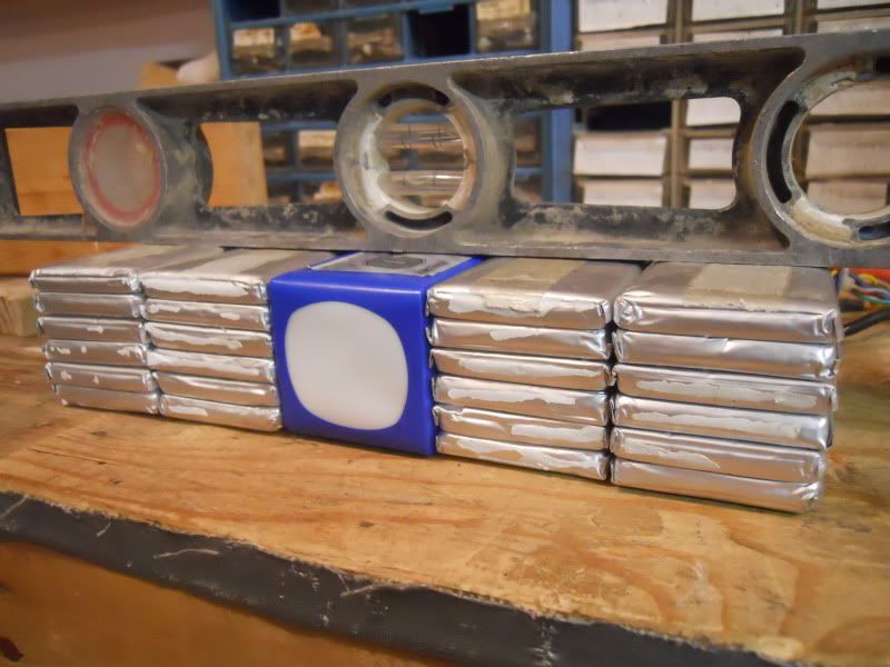

I used some ABS between my packs, gave them the squeeze with a clamp and filament tape to keep them tight.. so far so good. !
(51.56 KiB) Downloaded 275 times
(59.4 KiB) Downloaded 275 times

That is a supurb way to do it Ypedal.

Taking inventory this season I had 4 puffed packs that I really didn't want to completely replace. I would call them moderately puffed-- When the shrink wrap was on you could easily see the puffing
I tried using toothpicks at first but the wood was too soft to pierce the packs, so I resorted to a razor blade. This worked well, especially after I put a little pressure in the vice and the sides swelled up slightly. They deflated almost like a balloon; I could hear a little faint hiss with some cells.
Here was my setup
And them all afterwards
They turned out awesome! I balanced charged them about a month ago to 3.85V. Without touching them since they were all +/- .01V after I de-puffed them. I think of the 24 cells, 6 weren't at 3.85V. :D
We'll see what capacity turns out to be. I'll do a couple cycles with my hyperion RC charger.
