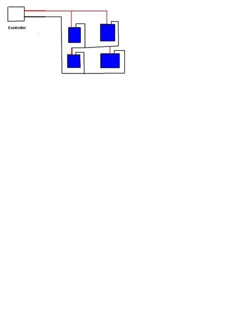

TC, I sent you a pm, and I don't think one string of two batteries will get you very far. Remember, don't overcharge, don't overdraw, and don't forget to grin. Brian L.

RallySTX wrote:TC, I sent you a pm, and I don't think one string of two batteries will get you very far. Remember, don't overcharge, don't overdraw, and don't forget to grin. Brian L.
Hi Brian,
I got your PM but it was after I seen this post. In your little pic there areonly 4 batts, im planning on using 6. I'll let you use your little pic setup on your bike first and wait for the results.
Your probably right that 1 string of 6 batts wont get me very far BUT a string of 6 batts will get me a lot further than the 2 iv'e been using for months :D

Postby mattetjus » Fri Jul 01, 2011 9:45 am
hey TC,
It will work, BUT, as i understand it (anyone feel free to correct me):
in case that the battery cells are not equally strong, e.g. capacity differs slightly between the individual cells, they may go out of balance.
A rule of thumb it is to parallel lithium cells first, then put them in series;
as you have the packs in your figure, (i'll name your cells, from left to right, A1, A2; B1, B2; C1, C2, attached png-picture) , I'll call this
CASE A
you have the two packs A1 and A2 in series (likewise, B1+B2 and C1+C2) and these will then be paralleled with the B's and C's;
When/if a cell in e.g. A1 goes bad, as in internal short circuit or something, or if it simply runs out of juice before the others; the B1+B2 and C1+C2 strings will have higher potential than A1+A2 and will discharge some of their capacity through A1+A2, meaning: all cells in B1, B2, C1 and C2 may go below their acceptable Low Voltage.
CASE B
Now, if keeping the cells paralleled (for you, this could be, connecting the balancing cables of A1+B1+C1 together, and likewise A2+B2+C2), you will 'only' endanger 3 cells in the case of a single bad cell.
for example, Cell 1 in pack A1 goes bad:
in your figure, potentially all the cells in B1, B2, C1, C2 could go below their preferred Low Voltage Cut Off -- 4 of 6 packs may go completely dead + pack A1 lost 1 of its cells.
If paralleled first, you'd discharge the first cells in B1 and C1 through the bad cell in A1 -> you now have 3 of 6 packs which have one bad cell each. (a bit better than the risk of 4 completely dead packs)
(155.36 KiB) Downloaded 2 times

Postby TopCat » Sun Jul 03, 2011 9:35 am
I done another diagram, hopefully someone will chip in and tell me if this is right?
6 Turnigy 5000mAh 5S 25C Lipo Packs wired to give 36v for more range on my bike.
Regards
Tom

Postby docnjoj » Sun Jul 03, 2011 11:17 am
Yep! Much better. Parallel first then series. Those series wires should be maybe at least 10 ga. depending on the amp draw you desire and the speed you want.

Postby RallySTX » Sun Jul 03, 2011 5:03 pm
I don't think the drawing is correct. I hope I'm wrong but the easy way to tell is to check the controller leads with a voltmeter when it's done.

Postby mattetjus » Mon Jul 04, 2011 2:09 am
yeah, the drawing is a bit hard to decrypt ;)
Hope this helps:
rename B1 -> A3, B2-> B1, C1 -> B2, C2 -> B3: A1-3 and B1-3
Connect First three packs in parallel (incl. balance cables), connect last three packs in parallel and then do the two paralleled blocks in series (see fig.)

Postby docnjoj » Mon Jul 04, 2011 7:23 am
Oops! On closer inspection it looks like the 2 sets of 3 are also in parallel. Perhaps make it simple with 3 packs side by side in parallel x 2 and then series wire the 2 sets to get the 44 volts. For parallel all the + leads and all the - leads should be together. Then put the 2 sets of 3 in series.

Postby RallySTX » Mon Jul 04, 2011 5:30 pm
TC, if you haven't blown yourself up yet! :D I will redo my little drawing for you, so you can see what I was driveing at. I need to wait til tomorrow to do it, cause my desktop pc died Thursday and that took all my files down with it. This laptop has a touchy mousepad. No good at all for design work. And the mouse for the pc was a ps2, and this laptop is usb. basically just use your original design, but don't forget the polarity of the strings. All you need though is to visualise one more vertical pair of batteries wired up like the second vertical string and you have the design I am on about.

Postby RallySTX » Mon Jul 04, 2011 5:52 pm
Sorry about the crude drawing but there is what I meant. I added it to my last post.

Postby TopCat » Mon Jul 04, 2011 11:47 pm
Hi Brian,
Looks like I have 2 different options of wiring up my lipos to get a 36v longer range battery.
Mattetjus has come up with this version....
And you have come up with this version...
are both options different - its 5.00am and im still half asleep :) is there one option better than the other?

Postby RallySTX » Tue Jul 05, 2011 1:31 am
Actually TC we both drew the same thing, they just look different. The circuit is the same. He just layed all the bbatteries in a line, and I stacked them to conform to the visual idea of rows. His drawing presumes that you know that the connections are color coded and do not hook up to the other horizontal line. Proper design rules state that each connection should be represented by a round ball at the point of contact. Thus wires crossing each other without that ball are presumed to simply be passing over each other. That's why I drew mine as a layout of a simple pack, with no crossed wires, because I have trouble getting paint to cooperate, and most folks don't care about electrical drafting, they just want it to work! So there you have it, two guys that say the same thing. This is how the harness I showed you is set up, and how I plan to build the big one for my Spoiler. Happy day to ya, I'm going to bed now!

Postby RallySTX » Tue Jul 05, 2011 2:02 am
Two more ways to look at the same circuit.
and finally
