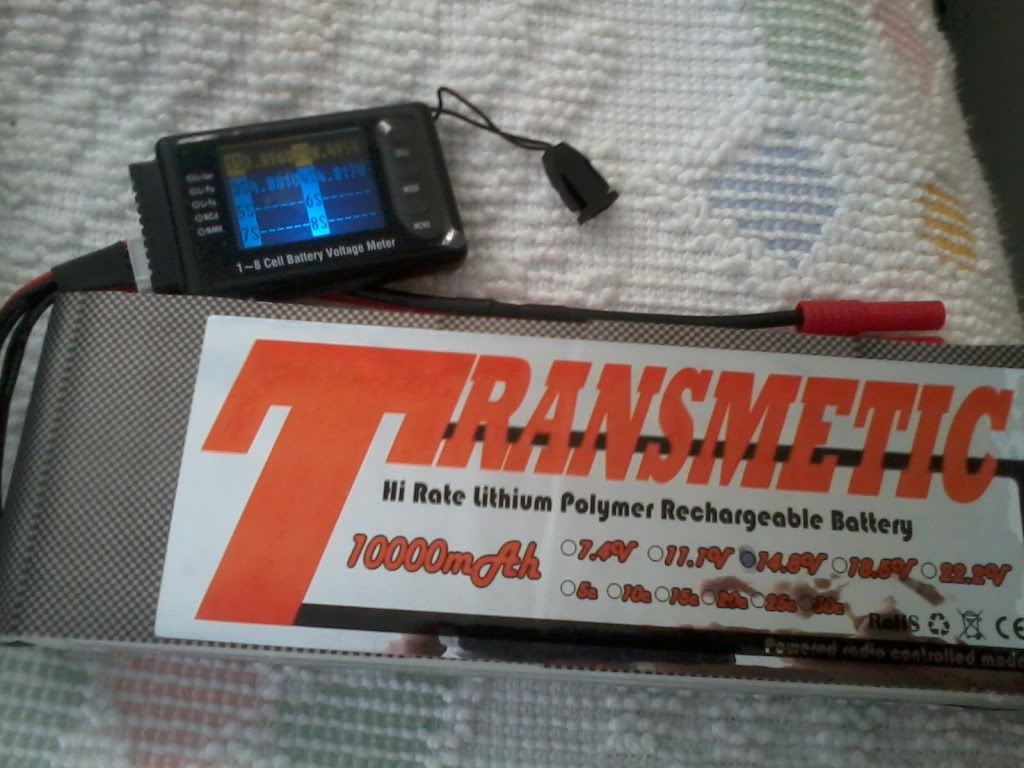

Postby cor » Fri Jan 20, 2012 3:22 am
OK, I returned home to find a lot of mail and a box with 4x 4s LiPoly Transmetic 10Ah batteries.
Since the BVM-8s had also arrived, I decided to unpack the batteries and plug the monitor in.
Wow - bubble wrap was stuck to the foil that apparently was wrapped very recently around the stacks of 4 cells.
The foil was not particularly well cut, so jagged sides and general sloppy finish, but there seemed to be no puffyness of the cells.
NOTE that the cells are virtually unprotected in these packs, that is why they are so light - you are looking at the bare sides and
the flat sides are only "protected" by a thin layer of foil...

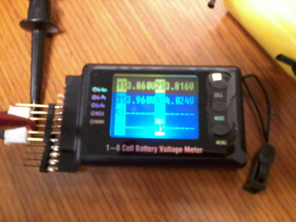

Anyway - plugging in the monitor showed that one pack had a bad cell (0.6V and falling quickly) and another pack had a bad connection in the monitor plug.

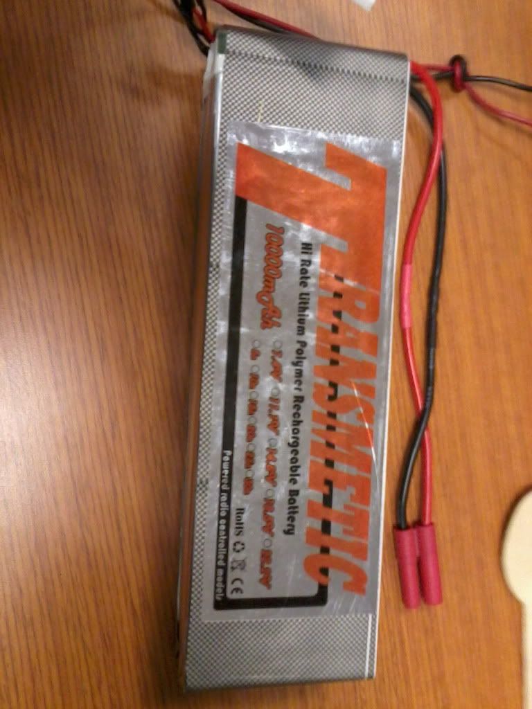

The pack and my $11 Battery Voltage Monitor. It is hard to see, but the 2nd cell is at 0.5V and falling...
This is how a good pack looks like - even though it has all the characteristics of a sloppy hand-assembled pack: jagged cut foil, pasted on by hand (that is why the bubble wrap was sticking to it) and the label is sometimes put on one side, other have it on the other, so power wires can come out on right or left side...

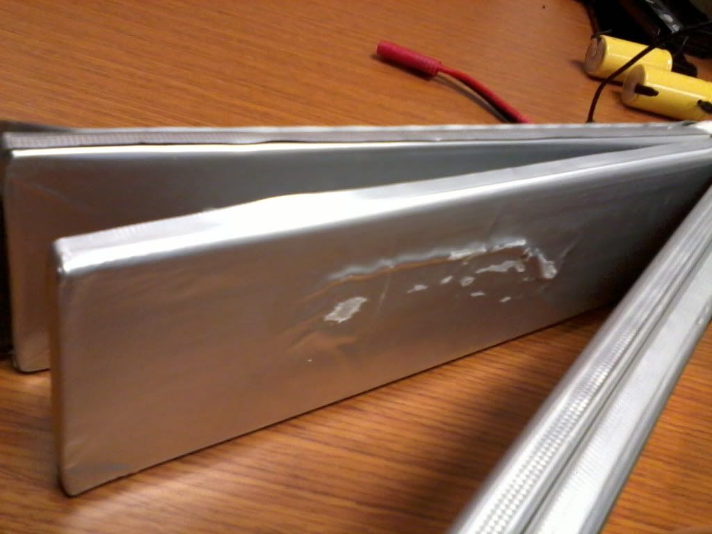

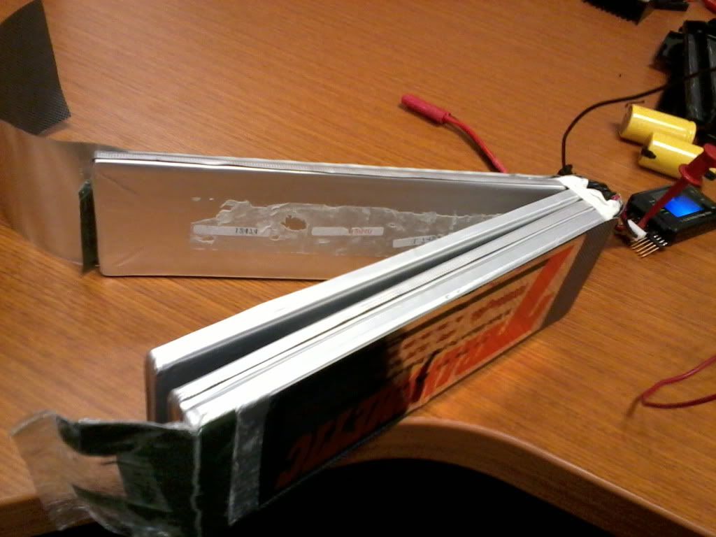

The bad pack I tore the label and foil loose, then split the cells apart (did not disconnect the tabs) to look for markings.

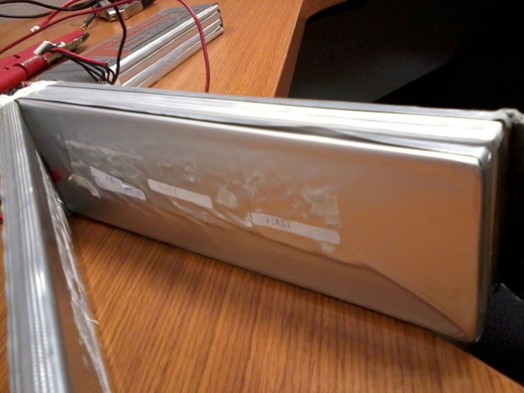

As you can see in the picture, there are 4 different printed and hand-written labels on the cell, on top of or under the double sided tape that holds cells together, but not the dreaded Tekocell printing of an old 1C ancient-technology variant of LiPoly. I might actually have a second generation cells or so???
The front of the second (bad) cell.... looking OK, except for the large "fold" in the cell pouch due to the pulling of the double-sided tape and the cell is not exactly straight any longer, it is curved in length and over its width. Not sure if that is going to be a problem in future, because even though the cell was shipped at 0.5V it appears that it is taking a charge and showing reasonable internal resistance, in the same order of magnitude as the other cells...
Just for completeness - the back of the second (bad) cell, again no printing or marking, only pulled together foil from the double sided tape.
OK, now for the kicker:
It seems that the cell was at 0.5V because *it was never charged*!
The manual labor to assemble these packs makes the process vulnerable to error and it appears that they forgot all the normal checks, so one cell slipped through without being charged - ever. And made it into my pack. And that pack was shipped without ever being checked.

OK, for your entertainment - here the voltages on the 4 Transmetic 10Ah 14.8V (4s) 10C LiPoly packs:
The first list is from the pack with bad cell 2, which I charged to 4.25V for a short while, now 4 hours at rest
Please understand that I manually balanced this pack already (charging cells individually) because the differences were much larger when I received it.
Originally cell 4 was the highest and hit 4.20V when charging all 4 cells at the same time. After that I have charged cell 2 separately, cells 1+2 and cells 1+2+3 but it looks like I now need to go back to the originally strongest cell 4 and prop it up a little too.
4.163
4.074 <- this cell was at 0.5V when I received the pack
4.173
4.111
This pack had a bad monitor connector. I discharged this pack at 5A, dropping to 4.5A until cell 4 hit 3.000V
Then I recharged the pack back to 16.6V (4.20V at cell 3) at max 8A until current dropped to 1A. No balancing done here (yet).
4.091
4.070
4.136
4.026
The last two packs were untouched, except plugging in the BVM (Battery Voltage Monitor a couple times and
a brief discharge test with the 5A load to check if every cell had decent internal resistance (every cell dropped about 0.1V at 5A discharge)
4.039
4.023
4.009
3.976
4.013
4.091
4.017
4.059

Since I discharge-tested the 2nd pack without first charging it, I took pack 3 and charged it to 17V (starting at 4A dropping to 1A at the end), after giving a few boosts to individual cells to better balance them. I did notice that one cell (nr 3) has twice as much internal resistance as the other cells and was the first to go to 4.3V and the lowest on discharge. So, this pack is certainly not going to give high discharge current, but I am not planning to use it with very high discharge, so let's see what the capacity is while discharging it with an easy 5A. I tested my trusty fog light on my power supply to see how much current it draws and it is actually pretty flat, as you might expect from an incandescent bulb: 4.5A at 12V and 5A at 16V.
After an hour it seems that the capacity is not too bad - Cell 3 is still the lowest, but all cells are within 3.59-3.64V.
After one hour, 50 mins the two middle cells are at the same 3.40V level and start dropping faster, the difference with the other cells has increased to 0.1V at that point.
At 1:56 cell 2 is lowest at 3.30V and the difference with cell 4 has increased to 0.15V
At 2 the hour point cell 2 dropped through 3.2V
It reached 3.000V at 2 hours, 8 mins. This means, assuming that current was a conservative 4.7A that the capacity was exactly 10Ah.
Cell voltages at the switch-off moment: 3.31 3.00 3.10 3.37V and as you can see, the middle two cells went down rather close together, while the outside two cells stayed closer to the 3.4V level where the voltage drops less fast.
I am sure that at higher discharge levels, this pack (and especially cell 3) will hit the 3V threshold much quicker, but it is good to see that it has the claimed 10Ah capacity at low discharge level. With the high internal resistance of cell 3, even at full charge level (4.2V) that cell will never be able to give a peak 3C discharge in the first moments before falling below 3V, since I estimate the internal resistance at about 40 mOhm, so 3C (30A) will give a 1.2V drop. Nowhere near the claimed 10C discharge capability anyway.
Funny that while recharging at 10A, all cells are within 0.02V at 3.75-3.77V.
I finished the charging when at 17.1V the charging current dropped to 1A and the highest cell (nr 3) was at 4.304V.
After resting half an hour, all cells are within 0.03V again: 4.236 4.250 4.265 4.234 funny that the first and last cell are lowest - apparently they have larger capacity than the two middle cells. Oh well.
