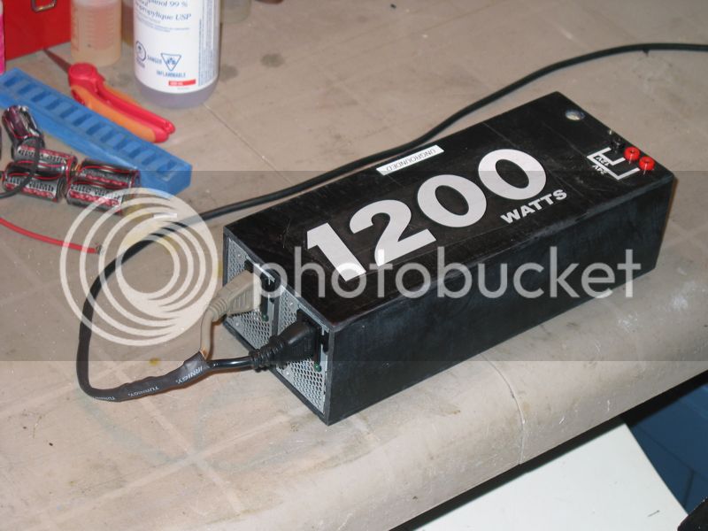

You can get two in series and have a 12V/24V power supply, you can then charge your batts to the max the 1420i will allow, 20amps. There's a section on the TJinguytech site that shows how to do it. This is mine, works awesome. Just a box made of hobby grade plywood so the PS don't touch each other.
You won't get a full 550 watt charge rate with a 12v supply, even with 47a output. You need a supply with at least 24v. I use a meanwell 27v power supply.
It supplies 47A which is more than the Hyperion 1420i needs so you're fine. It would be bad if you were to use a weaker supply since the Hyperion wouldn't be able to put out the max current it's capable of...

I'm building the 2x server power supply route right now, using the same supplies. They are cheap and work well. For those concerned they run 2x them in parallel stock in servers (redundant) in case one fails. Putting them in series is fine, as long as either the input side ground is floated, and the supplies don't touch metal to metal, or (a better solution but more work) is floating the DC ground on the secondary supply and attaching the chassis together. This gives you a setup of 12v and 24v @ 47 amps.

Isolating the chassis ground from the circuit board. This is required when wiring 2 supplies (both having a grounded chassis) in series. Otherwise the common ground of the second supply in the series chain will result in a short circuit across the first supply.
It looks like most of these guys are cutting the AC ground and not modifying the supplies for series operation. Thats really quite sloppy and can lead to issues.
It's not terribly hard to isolate the DC ground and keep the supplies safe for parallel and series operation.
I even happen to have one of these in the FS section. ;)
I second what Zomgtek says above, dont sever the AC ground less you want to experience main voltage shock. My prof of Electrical engineering at uni said the same floating AC grounds is BAD m'kay
Floating The DC ground is basically severing the DC connection to the case. My PSU's from my thread are connected through the pcb to the case via the case internal mount screws. So to sever the connecting in the 2nd supply ie 12-24v to "float it" i replaced the screws with zip ties (not metal) and insulated between the case metal and the pcb with rubbers (literally and eraser chopped into little pieces.) dont have pics to hand but its easy todo.
