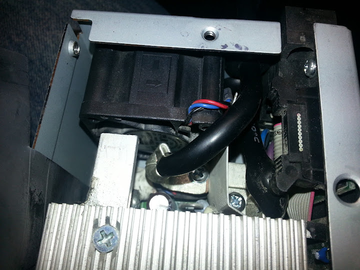

Remove the various chassis screws holding the sheet metal panels on and remove the top panel.
Pry the insulation layer's sticky goo adhesive off the other panel so it can be slid back from it's attachment slots. It will still be tied by the fairly short fan wires, so be gentle.
Remove that screw I'm pointing to. (all ready removed in picture)
With that screw out, drill that pressed in nut out of the sheet metal from the back until the little stand-off body is free.
Pry the little stand-off nut you drilled out from under the board so that corner of the PCB is floating not contacting the chassis.
Drill a couple of holes in the sheet metal next to the fan sized large enough to fit your wires through. I used silicon 6awg wire (because it was laying around), I think 8awg would be fine and you wouldn't need as large of holes.
This is what the back of the supplies connector looks like. See that mess of pins in the middle? You need to connect just 3 of them together, and make sure the other pins are shorting to anything else.
Now the three pins are bent so they are touching, and ready for a bit of solder. It's the lower left corner pin, and the middle two pins on the right side that need to be shorted together for the power supple to believe it's in a server and needs to power-on. Thanks to some RC groups guys for finding out which pins to connect to power these up.
A few supplies with the pins bent and soldered.
The PCB has 2 jumpers right where the tip of my dikes are pointing, you gotta snip them both and ensure you have no connection between those two sides anymore. This isolates the other point where DC was connected to the chassis.
I crimped some ring terminals on and bent them to route decently from those two nice stand-offs. You can see my screw drive on one of the stand off screws you want to bolt one terminal on, the other is just down and to the left by a cm or two. These are the positive and negative output terminals of the power supply.
All bolted up.
I slid some shrink around the wires in the area where they pass through the holes drilled in the sheet metal, just to help avoid it cutting the insulation and shorting. If you wanted to do it right, a grommet would be a good idea.
That's about it. It took me about 3hours of fooling around to do the first one and figure out how to isolate them and how to cable to them. Then doing 3 more of them took about 2hours of medium-easy work.
I would rate it about a 3 out of 10 on a DIY difficult scale. I would rate a 9.5 out of 10 on a value in power supply vs money spent scale. :-)

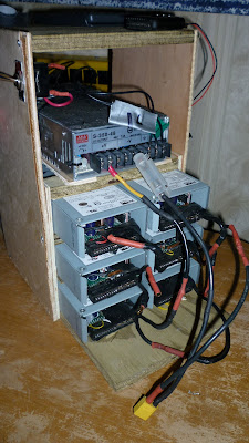

I'm powering on with creating a scalable charger using these power supplies in series with a lab supply with adjustable voltage and current.
Here's where I'm at, just starting testing:
The image shows the $330 power supply I've just bought which has 0-16v and 0-40A both adjustable. On the Cycle Analyst, you can see 2 of the ESP-135 are in series with the Powertech unit adding ~12.5v each. The supplies themselves are not visible in the photo. Next step is to add big terminals at the back and test at higher current, and mod more of the ESP-135's to run in series.
The lab supply is working perfectly as expected in my limited testing, connected to a 10S Li-Mn battery. I can charge the pack with the lab supply in either CV or CC.
voicecoils
Posts: 2288
Joined: Sep 16, 2007 6:31 am
Location: Sydney, NSW, Australia
Re: Testing the HP ESP-135 Server supply and isolation moddi
Post by voicecoils » Jun 14, 2012 6:15 am
Well, this thread's gone a little quite but I'm still powering ahead to make my 75-90v 0-40A charger.
Here's what's in the photo:
1 x Lab power supply 0-16v 0-40A (640W max charge power)
6 x ESP-135 (500W charge power @ 40A limited by lab supply)
2 x power boards with 8 C13 (10A) inputs and a C20 (16A) output
7 x C13 to C14 short leads
Each power board has 8 inputs, so I could have used just one, but having a total of 3.6kW of charging power is too much for a single common Aussie 240v 10A outlet. Instead, by splitting into 2 powerboards, I can connect to 2 wall sockets and have plenty of headroom.
I have plenty of work to do for a rainy day - change C20 plugs to standard Aussie 10A plugs (AS 3112 or Type I) & make the DC series wiring for the front side. I'd also like to package everything into a nice little road case.

I finally got around to doing this to some supplies and thought I'd share a couple of things based on my experience:
I screwed around a bit trying to see if it made sense to attach the output leads somewhere else, like removing the "hot-swap" connector and soldering them somewhere, or something, but I ended up deciding it made most sense to do it just like Luke recommended above. I used some 6ga / #10 stud terminals that were a bit too big, I had to remove some material to make them fit on the terminals. I used an angle grinder.
This is what the terminals looked like before installation:
and installed:
I initially didn't like the idea of drilling out the stand-off out of the case, and tried doing it like voice-coils above- but I ended up cutting through a small trace that runs very close to that pad. I tried drilling out the stand-off instead and found it to work out really well, the standoff is aluminum and is very easy to drill out, works out really clean and tidy.
The step-drill that Luke shows in his pics is the best tool I'm aware of for cutting holes in the thin sheet metal case- I don't have a step drill here at home so I decided to do it differently- I have some grommets I threw into a mcmaster order a while back and I just used the angle grinder to notch the case so I could install the grommets. The 1/4" ID 3/8" OD grommet fits very nicely around the 8ga HK wire. There's much less chance of bending the case up with the abrasive cutter than with a drill bit, in general.
Other than those things I did it just like Luke wrote above, and agree that it's pretty easy and fun!
Now for the punch line: I was planning to use four of these and a Mean Well RSP-1000-24 as a ~3kw charger for my big 18s/40AH hobby-king battery pack, powering the power supplies from my "prius generator"- the outlet I installed on the HV battery in my prius- (170-240vdc ish)... most SMPS work fine from this power source and the prius makes a really nice quiet, clean, mobile generator.
These ESP-135 power supplies do not appear to work on DC power - They power up similar to how they do before you solder the enable pins together- the fan spins slow but the main power supply won't kick in. Too bad. I have tested several other power supplies on this HV DC with good results: Mean Well HLG and RSP, a Lenovo laptop charger, some Mean Well S series supplies (with the dual voltage switch set to 240), even a DeltaQ charger all seem to work fine.
