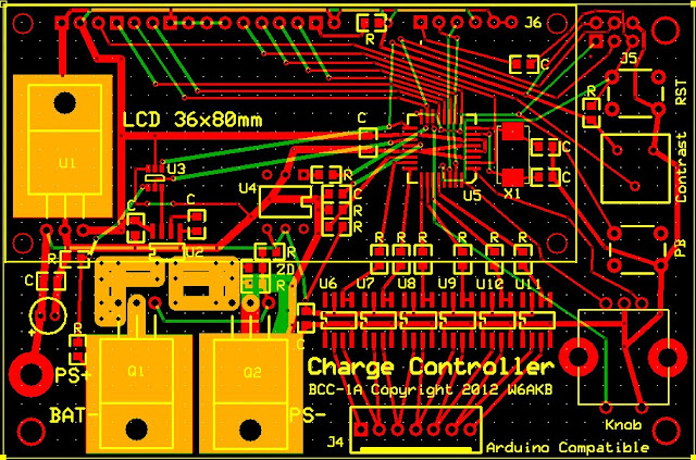

So what to do. It would be nice to have a purpose designed little board that had a CPU, LCD display, voltage and current measurement hardware and high current switch. How about an Arduino?
Sure, could do that, but would have to build or hack together most of it anyway, so why not toss the whole thing on a board, and make it Arduino open software compatible? This gives a lot of options for programming it. Then folks can customize their software for their own needs.
It might look something like this:
The board layout is not complete, but it is probably 75% there, though this rendering is earlier in the process. Basically a 16x2 LCD, a current sensor, some voltage sensors, a high current FET switch, an Arduino compatible AVR CPU, a knob and some pushbuttons.
I was thinking it might be nice to use this on the other available bulk chargers (or power supplies made into bulk chargers) to provide extra monitoring and safety. If we made some hardware with sample open software folks could do their own customization for various purposes. I can think of a few other uses for this hardware as well.
Comments? Suggestions? Worth completing??
