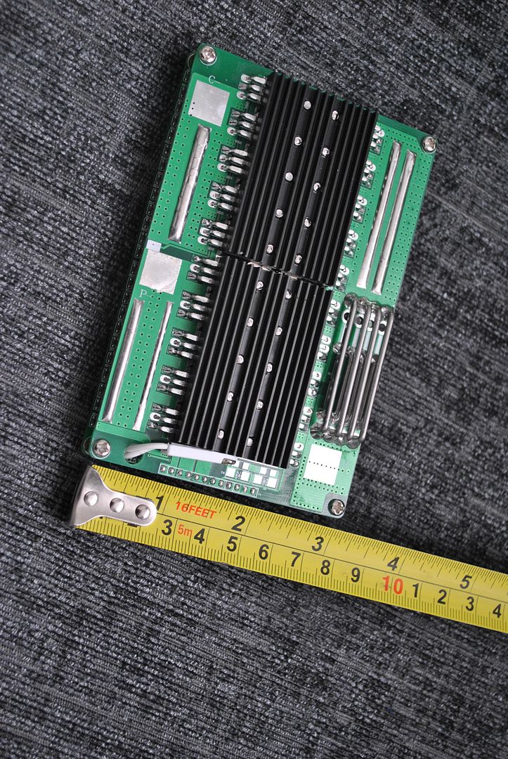

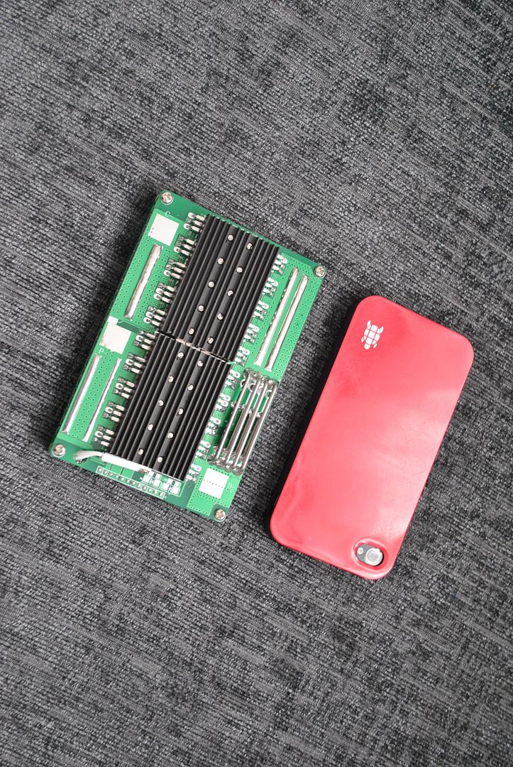

These could be quite popular, so thought I would put some more information up about them.
http://bestechpower.com/888v24spcmbmspcbforli-ionli-polymerbatterypack/PCM-D131.html
You must specify your desired parameters before you order
The unit itself is a lot smaller than I had anticipated, that is an Iphone 4s in the pictures for comparison.
Balance voltage for single cell: 4.20V±0.025V
Not good enough, still need a balancer/balance charger. But it will do nicely for LVC/HVC

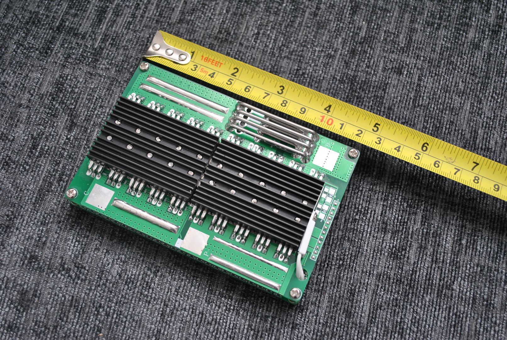

bought one 24s lifepo4 (the very exact same one like in the 1st post except it's not lipo but lifepo4).
had some good conversation with henry, and even tough they didn't send the tracking# as requested it arrived within a week.
connected it to my battery, and charger and startet charging. no fire, no flash, no bang. that's a good sign ;)
my charger is set to 86.4v end voltage, and starts to lower current afair somewhere near 84v.
the whole pack is about 50mv out of balance when the first cells reach 3.6v, and the bms is fully balancing at that time. the backside of it (the side w/o heatsink) get's up to almost 100°C. this is REALLY hot, and i'm not sure if i can mount it directly to the any surface as i was planning to do it. of course balancing is not finished when the whole pack reaches 86.4v, and some cells are 3.66v, and some are 3.48v by then.
there is a question left: how can i assure that the pack has enough time to balance?

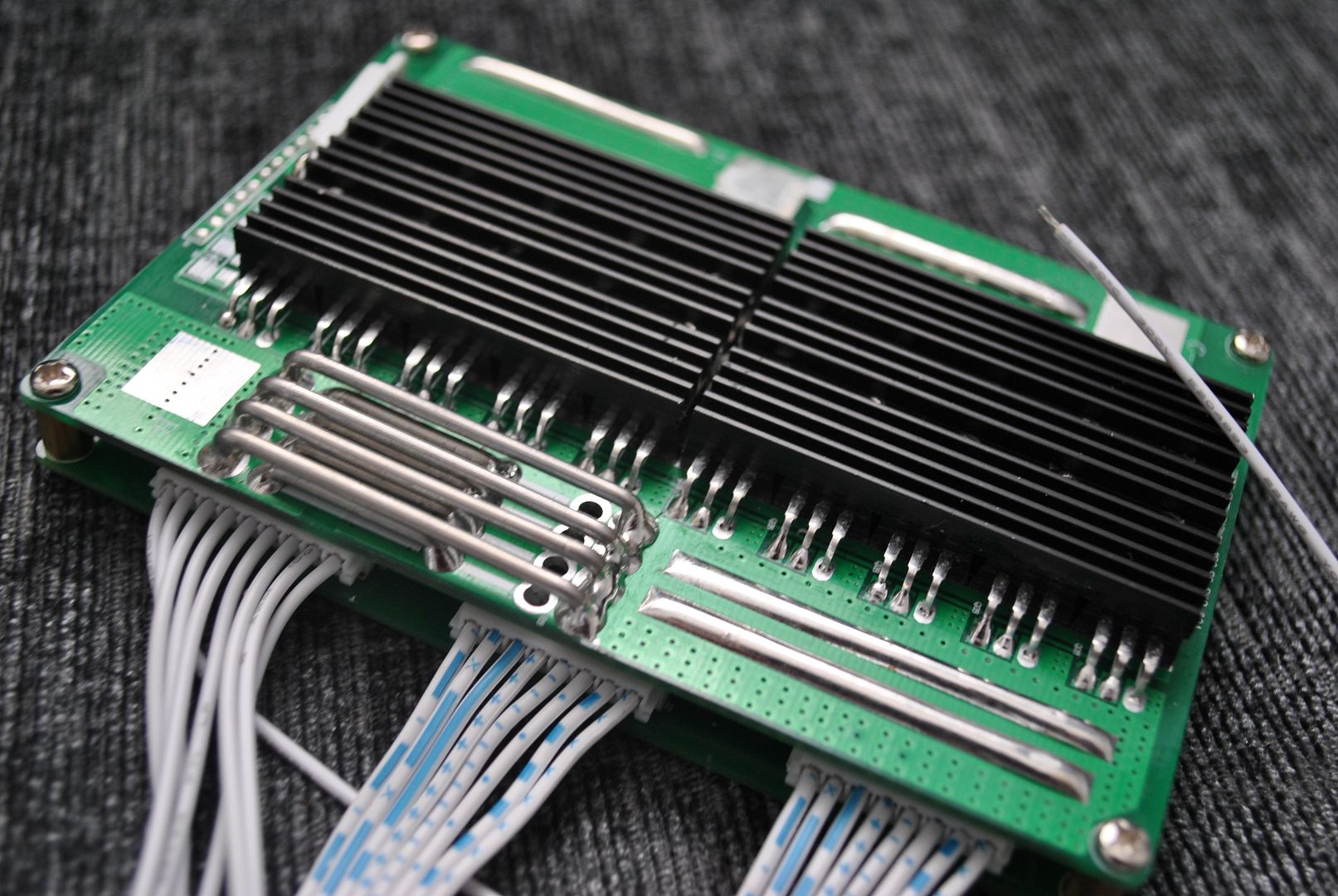

no, don't change anything now. the reason it is hot is because it was balancing a a lot of current. it has a balancing current about 3 times as large as the ping signalab so the heat is much higher. you wanna have the resistors exposed to the air for sure so they can radiate the heat.
the 15S lipo BMS i ordered has just one 100 ohm resistor so it is only 40mA.
you have 4 of the 100 ohm resistors in parallel so it has an equivalent resistance of 25ohms. at 3.9V the balancing current is 156mA.
balance current is quite high. i was wondering how it would handle the heat as i saw the product data.
the question is: as i understand it balancing voltage of 3.6v means that all cells above that value will get pulled down to 3.6v. but what happens to those lower cells that are still below that border voltage even at charging end? they stay there, and will never balance? should the kingpan charger restart charging after some time? or is it off for ever as soon as it once stops? so i would need to start the switch from CC to CV earlier, or should i raise the HVC? because if i don't do anything cells will never get balanced. correct?

izeman, the charger shoud go to the final voltage and continue at CV delivering a small balancing current that is used to charge up the low cells. if one cell goes to the HVC then the entire charge is turned off as that cell is drained down to allow the charging to turn back on again. this continues happening until the cells are high enuff that when it cycles back on again after the last of the HVC cutoffs, then no cell can reach the HVC and the charger continues charging at the low balancing current rate so the low cells continue receiving charge and the full cells have the current bypassing them and going through the shunt resistor.

but as i mentioned earlier: balancing resistors get cooking hot. i hope the bms was designed with isolation in mind? all batteries with bms installed come in an isolated pack. i will NOT cover the heat sink, but it will be located in the battery box. some space there, but NO airflow. we'll see how long it survives. ;)
jimmyD uses a sheet of plastic above the BMS surface when he built the headway packs with the signalab BMS, and underneath too but there was space for the air to flow around the BMS surface and allow the shunt resistors and the mosfets to cool themselves.
dr Bass uses a big sheet of copper attached onto the end of the BMS and solders the mosfets to it for a heat sink and it is the drain connection for the P- spot.

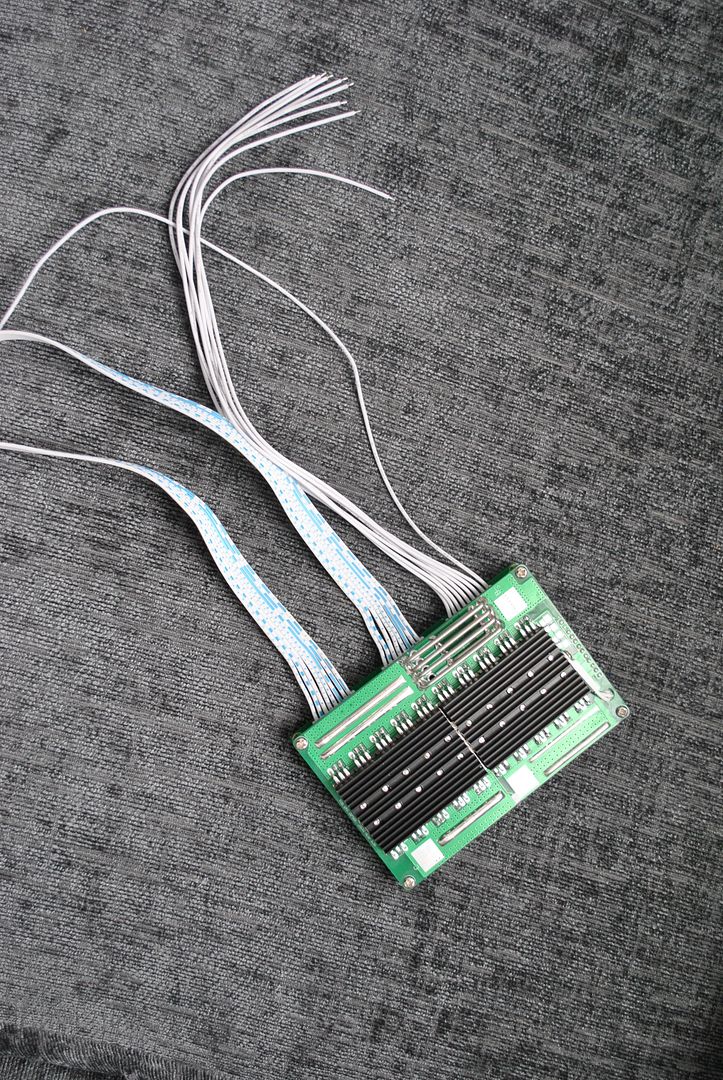

for the 24s there is one 9pin connector and 2x 8pins. making 25 wires (those come with the bms). yesterday when installing it i thought a long time how to connect everything. i already had 4x 6s jst-xh connectors installed. good to connect celllogs for monitoring them or for balance charging with my bc168. i thought of removing those and to only direct wire the bms to the cells. but decided against it.
second idea was to make a wiring harness: 4x male jst-xh on one side and the 3 male plugs to the bms at the other side. decided against it as this would mean: bms or monitor. but not at the same time. as the bms shows no sign of activity (leds, lcd, usb monitor, ...) i need the celllogs for monitoring.
so i wired all wires the bms comes with directly to the cells leaving the jst-xh untouched.
now i can charge and monitor at the same time.
