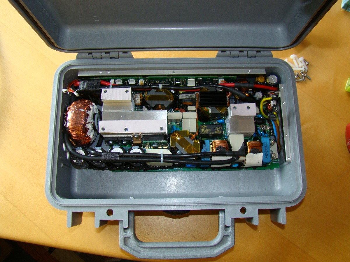

The charge mode of Adaptto controllers is a very nice feature because it makes it possible to use one charger (PSU + coil) for many vehicles with different battery configurations.
I decided to use the Eaton APR-48-3G server PSU. Like the name says it has 48v nominal so it should be possible to charge any battery that has above 48V when empty up to 100V. It has a maximum continuous output power of 1800W and it features CC/CV limiting what would mean it also could be used for bulk charging (up to set voltage, maximum is about 58V i believe).
We could place the coil either in the vehicle or at the charger side, but if its placed at vehicle side, its necessary to unplug it everytime when riding - otherwise the controller could get damaged.
This is prone to errors and more cost intensive (we would need to buy a ciol for every single vehicle), so the only wise decision was to put the coil together with the charger into a case - of course as small as possible to keep it transport friendly :)
After disassembling the Eaton PSU and some measurements i decided to use Peli 1170 case as it has the closest dimensions.
I have shot many pics during the conversion so you can see what parts you need and what work exacty i have done on the psu and the case.

thats how it looks:
Now lets start.
sharped M3 bolts to copy bolt position to peli case bottom:
mount the 6x6 Alu profile to the sides (exactly onto the prejecting parts), drill holes for air outlet etc:
work on the Eaton PSU:
adding wires and one capacitor, small wood plates sticked to bottom as spacers, shorted the board a few mm at output side (to have more space left for the coil) and drilled holes for the wires,
drilled holes to the heatsink and cut M4 into, remove the LED's and add a connector,..
next the work on the coil:
pull out one wire from the middle and make it look like below. i believe one half turn less will not be a problem :)
intalling coil and capacitors:
soldering wires, add connectors to the wires after to coil, i have added sikaflex (the black stuff, its like silicone) to all larger componetns on the board for better protection against vibrations:
aluminum spacers, screws and thermal foil, i have broken a drill two times thats why the spacers have useless holes:
NOTE: the two heatsinks on the left are electrically connected to the board (same potential), the heatsink on the right has also connection but with DIFFERENT POTENTIAL so you need to make sure they do not come in contact. If they do, something will blow! thats why i used the thermal foil two times below and on top of every spacer and plastic screws.

The fan is very silent. It's no comparison to the bugging noise the original two little turbines have made.
where the cover is attached to the heatsink on the left i measured a temperature of 50-55°C at full power. the fan still doesn't operate at full speed so it should not be critical, but as i do not want to someone burn his fingers there i'm going to install an additional heatsink thereon and drill holes between the fins for more airflow.
the coil doesn't get above 45°C and the cover on the right only is warm to touch, so everything OK.

Adaptto controllers have a built in charge function which basically works like a step up converter.
Any step up converter needs inductance (and capacitance) thats why the coil (and additional caps) is needed.
For easier handling i installed the coil together with PSU into the case, but it could be placed also near the controller.
