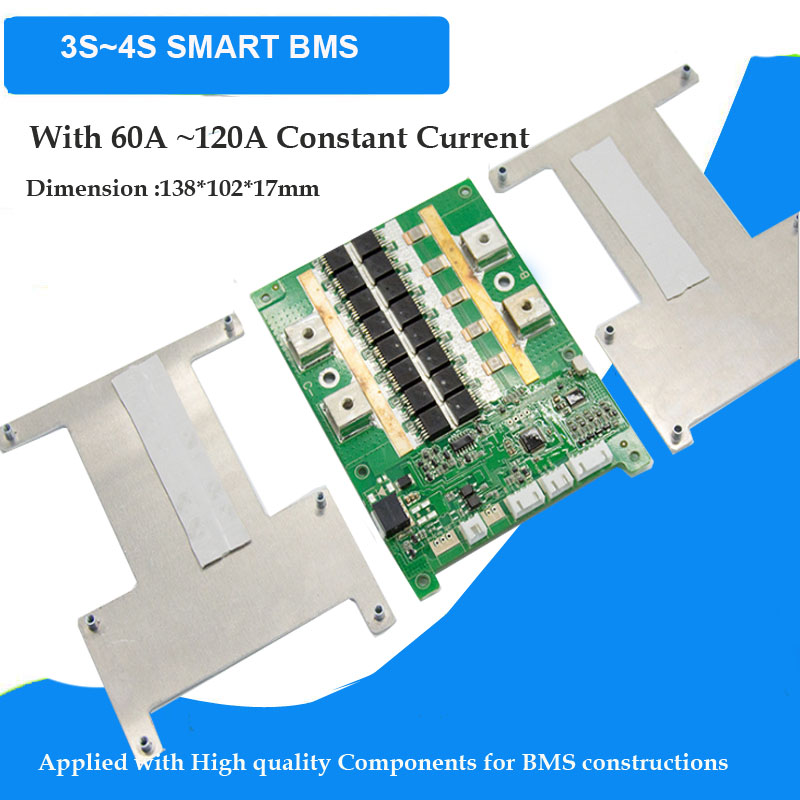

izeman wrote:
Jan 31, 2018 12:42 pm
has someone found a way to turn the bms on/off with a switch?
i contacted the seller and they told me to use the temperature sensor. unfortunately the question if it will restart automatically once the "temperature cut off condition" is released, is unclear. do you need to connect/reconnect the battery to reset it?
i have a new a 14s5p pack of 30Q cells made.
if you dont use it...you will lose ~ 0,1v in 14 days
thats alot and you have to be carefull if you give this battery to friends or customers who arent that fit about batterys/cells and stuff like that.
pic 1 is from 09.01.18
pic 2 is from 25.01.18
battery never attached to a controller.
