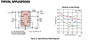

I need to step down an arbitrary battery voltage down to 5V.
I need burst power of 60mA or so @ 5V - maybe as little as 30mA but better leave overhead

Lower Power Switching Option
LTC3639 + external components
4V to 150V @ 100mA
You can get about 70% efficiency out of it with an epic drop from 150V to 5V
I imagine cooling will be an issue - have to read the sheets closely

So... lets play it safe and start with a typical application:
This wont be the best
Not the most efficient
Not the least ripple
Not the fastest to recover
But it will work... and there are some part numbers to pick through.
We will use those to run through the calculation exercises that they post.
-methods
Input cap
250V 1uF
$1.43
http://www.mouser.com/Search/Refine.aspx?Keyword=810-C5750X7R2E105K
Output cap
10V 10uF
$0.39
http://www.mouser.com/ProductDetail/TDK/C3216X7R1C106M160AC/?qs=LcTL/5vFEzHmDUPbB3OzqQ==
Inductor
1mH 340mA
$1.60
http://www.mouser.com/ProductDetail/TDK/SLF12555T-102MR34-PF/?qs=g8DL0B6GkTlprquS2TaDEw==
Uh... now that was not so hard right?
The actual part is $5
http://www.linear.com/purchase/LTC3639
(lots of flavors tho... need to look into that. I want the best heat sink variety)
And... now to reverse engineer the $200 demo board for ideas:
progress...

Power stackup is starting to look like this:
Which boils down to about a 10uA burn (if I implement only Sleep and not a true Dead Man or latching relay)
Peak draw (not including balance) of 100mA - with 86 of that coming off of our 100mA DC-DC
Considering that it is not a complete list... I may need to bump up to a larger DC-DC
Or... Eliminate some options...

Sweet.
Thanks for your help along the way.
I agree that the tiny regulators should end up as a daughter board, potted, and made available...
Tho I suspect many would want more current.
Reference the LTC sample board with jumpers for select.
They are going for $200... we could do them in tiny for $20
