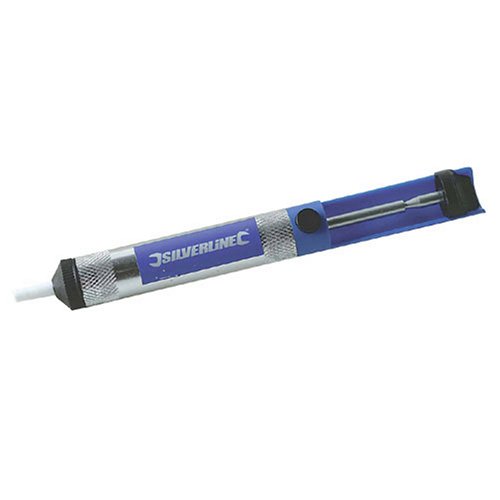

Also, I have a little experience with soldering but only with wires and not with pcb board. I have this silverline solder sucker but it's really not working well, doesn't seem to suck anything:
- Any recommended solder sucker I should buy?
I'm using for now this cheap 60/40 solder reel: http://www.ebay.co.uk/itm/SILVERLINE-SO ... _817wt_989
Is it ok?

the solder suckers get plugged up and you have to clean out the clogs of solder in it to make it work.

I never use a solder sucker to remove components. I melt the solder around the component and then I tap the board on the bench and all the solder jumps off. You have to be quick and it takes a bit of practice, but once the technique is mastered, it's quicker and easier than a sucker. If a tiny bit of solder remains and holds the component and there's not enouh to melt, add a bit more solder before tapping. To remove big lumps of solder, turn the pcb upside down and work from underneath. The solder will melt onto the iron, and you then shake it off - no need for a wick.
