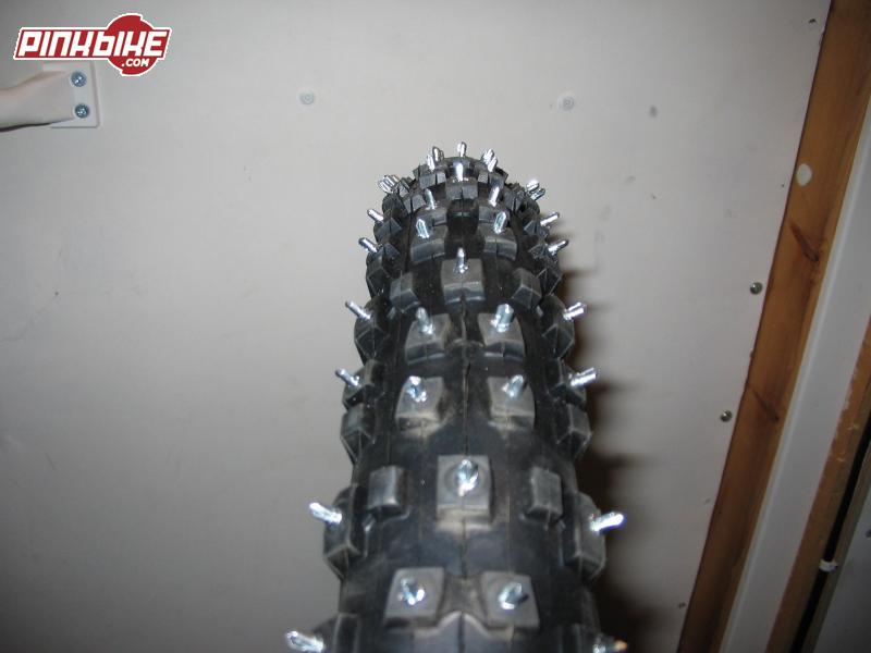

There's a cheap and extreme alternative.
photo borrowed from somewhere
Buy 200 short screws, drill holes for them on your tire from outside (so you can choose locations), instal screws, line the inside of tire with gorilla-tape, spare tubes, or special liners to prevent punctures or what ever you find.. perhaps some elastic glue with screws to keep them intact.
Screws should extrude only few millimeters at center and a bit more at sides. If the are longer, they will bend the tire and rip it.
