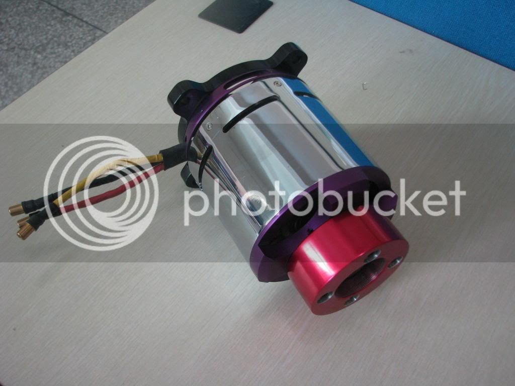

Heres the deal: i will probably be able to get two 12 kw rc motors .
SPECS : 60V 200A = 12 KW
75 KV
also - got a deal to put best quality bearings and ADD hall sensors
QUESTION : 1.WHAT KIND OF A REDUCTION HAS TO BE ADDED FOR NOT OVER HEATING THE MOTOR
2. WHAT DO YOU THINK ABOUT KV LIKE THAT
ALSO , FOR ALL YOU GUYS THAT ARE CONSTANTLY INVENTING NEW STUFF , I WILL BE GLAD TO PUT LINK
OF THE FACTORY AND PRICE OF THE MOTOR AFTER TESTING . BELIVE IT OR NOT : AROUND 250 BUCKS :)
3. BECAUSE THIS FACTORY IS VERY GOOD , I DONT ASK MANY QUESTIONS . DUE TO BAD ENGLISH I WASNT ABLE
TO UNDERSTAND THIS BUT I THINK SHE TOLD ME THAT THERE IS PLANETARY GEAR ON TOP OF THE MOTOR , SO
THAT BRINGS US TO SECOND QUESTION : THE MOTOR IS TOO SMALL TO HAVE GOOD PLANETARY REDUCTION INSIDE : YES , NO ?

This is the motor

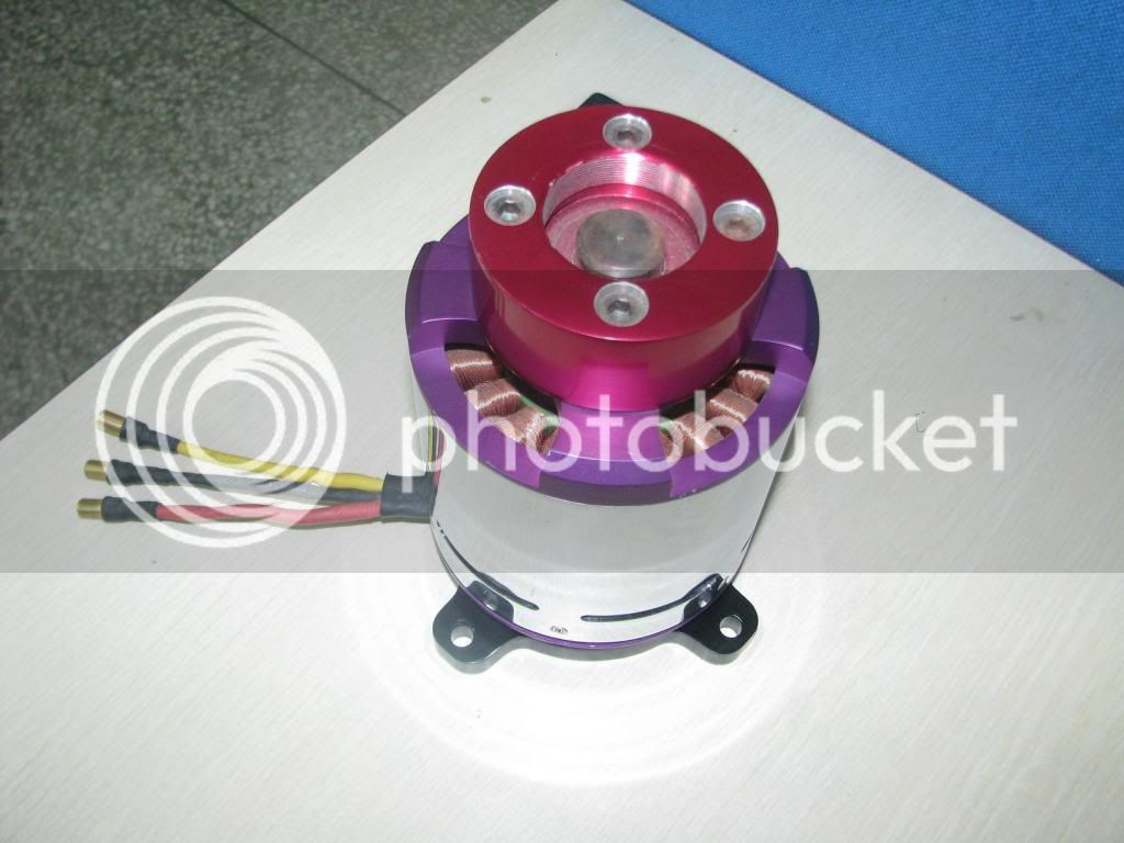

Dimensions? It looks like it uses a bell skirt bearing, which is great. Can you confirm that? Any chance they happen to know the stator diameter, width, number of turns, and winding resistance?

Souds like an good motor for the money. About the kv,I think it is low enough to do a direct drive to the rear wheel.
Do you have some dimentions from the motor? Also a picture with the motor next to a soda can ore something, for size comparison

75kv does not mean 75rpm but 75rpm/volt. With 60 Volt you'll have 4500 rpm. Way to much for direct drive!
The planetary gear is designed for airplanes where there is no load during startup. No way the gears can handle the huge start torque of a bike. Maybe when you add a clutch closed by centrifugal force, like 50cc scooters have.

Postby HAL9000v2.0 » Fri Mar 05, 2010 6:20 am
Hey,Marko. THis motor on picture definitly does not have planetaray gerbox. It doesn't have any gearbox. It is a normal outrunner.
This is the one you asked me about? I must have been looking at the wrong picture. 75 is definitly Kv not rpm for this one but the price is good.
