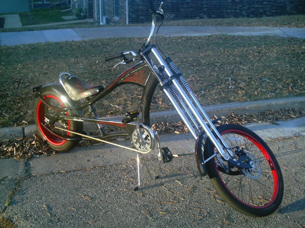

Hello all, Brian here with a project in progress. I have a adult size Stingray that I will be modding myself at home.
I have many questions and can show pics if needed. After looking over this and many other sites I have learned much, but now, I am even more puzzled about the viability of this project. A gentleman who seems quite inteligent on the Amped Bikes site states quite clearly that ebike motors are pedal assist only! He also states that kits sold with high wattage ratings are just overvolted, abused 500 watt motors. I have seen videos of 72 volt bikes hitting over 30 mph on level ground, with 500 watt motors. Well, it's time to ask the experts. My chopper has springer forks, so a front hub is a bad idea, right? The bike weighs 45 pounds naked, I weigh 210 naked, oops, adding groceries, [on my back in a pack] batteries, lights, motor, all add up to about 400 pounds. Next hurdle, the route will be about 20 miles with two 20 percent grades about one city block long. The last grade will be about a mile from home. Also the store isn't likely to let me recharge while I shop. As if the water wasn't deep enough, I live in WI, so there will be days filled with snow, ice, and brutally cold -20+ temps that will bring out the wanderer in me. Lastly, there's the dificulty of modding this bike to begin with, from the perspective of a guy with only one arm, and a bum leg. That should explain the need for power. I can't pedal the thing to begin with, but can ride it well downhill. Now, I'm not looking for speed, or brutal acceleration, but I need tourqe and range. I'm looking to get 20 mph, for 20 miles in all weather, with a 50 lb. load on my back. When you quit laughing, or shaking your heads, I welcome your feedback. My tentative plans are for 48 volt LIFEPO4 30 AH cell in a framebag, between my knees. A 750 watt rear mount motor with disk brake setup. and a controller mounted to the back of the seat tube. My biggest issue is the rear dropout width is longer than standard. About 158.6 mm from inside of dropout to inside of dropout. A website selling replacement wheels for the bike states that the width is 177? mm from locknut to locknut. I read somewhere that this issue has been solved by at least one manufacturer. Also, I wish to keep my 4 in wide rear tire and rim involved as well. So I need to have a motor with disk brake, 12mm spokes, [ the biggest right?] and 4 inch wide rim, to fit a 20x4.25 tire. I sent an email to Crystalite earlier today asking if they would lace up a wide rim to a motor for me, but I forgot to stipulate the disk brake part. I expect this project to take about a year to build, mainly due to limited funds.

Welcome to ES RallySTX,
My short, non-expert, answer would be to build on a bike that's more suitable for an e-conversion. You can often find a suitable steel framed MTB or Cruiser for less than a $100 (my first build started with a new $75 Walmart steel framed Road Master hard tailed MTB). You can also find some great deals on much higher quality used bikes for not much more than a hundred. You will, imo, need to go with at least a 48v lifepo4 battery of no less than 20ah/2C and a hub direct drive motor of 500-1000watts. I'd go with motor wound for good all-around torque and moderate speed (figure on a top speed of about 20mph) . You'll also need a controller that can handle at least 20-25 amps continuous (with a peak of about 30 amps). A Cycle Analyst would also be a big help in configuring the proper setup so as to meet your requirements.
Long answer would be to have an hub motor laced to your Stingray rim by an experienced e-bike shop (or mechanic). Ebike.ca, etc, should be able to "cut" a set of custom spokes for you. Excessive spoke angle could end up being your biggest problem with this "lace up" so, be sure to address this issue before you start.
Good luck and good riding!

Problem one , after money, is likely to be getting the motor laced. A good choice for the motor may be a crystalyte 5304, which can take the heat of lugging that weight up a hill. I think you have a 24" rear wheel? That combo will get you some power to get up hills with 48v. Holmes Hobby is the guy to talk to about the lacing.
I suspect your grades are not quite as steep as 20%, but some places have that steep. No less steep route you could take? The 24" rim 5304 should eat anything up to 10% alive with no problems. With ehough volts though, you'd fly up that hill.
Battery will cost ya, but 48v 20 ah should get you 20 miles, even toting a big load with a big clyte motor. But you will need batteries that can handle the amp rate that motor will demand. You might want to look at lipo batteries if you don't make the trip everyday.
How's your back? Mines not good, so 20 miles nonstop on a chopper would be like having sombody pound me with a sledgehammer.

The front triangle is nothing like a regular bike. Its not even a triangle but 4 sides and the chain cuts thru there too. So a regular battery or bag designed for the front triangle won't fit. The back wheel looks real sturdy and the center of gravity puts more weight on the rear. As you add weight forward of the center of gravity it goes more onto the front wheel - via that extended chopper fork - which looks considerably less sturdy than the rear.
48v X 20AH LiFePo4- About 8 quarts volume and 28 pounds. There is usually also a speed controller somewhere - usually built into a finned heatsink/box like a small car stereo amplifier - should go somewhere with airflow.
12mm spokes - You probably mean 12ga which is about 2.7mm and 2 sizes thicker than usual spokes. Check the spoke gauge with the hub maker. Also the hub and the rim have to agree as to how many spokes - usually 32 or 36.
Wide wheel and tire - regular hub. Though you have an axle long enough you could have trouble with the chain rubbing the tire? Maybe some dishing required - where the spokes on one side are a bit shorter than the other so the rim is shifted to one side of the hub - away from the drive sprocket a bit and towards the brake disc.

There is one advantage the extra wide bottom bracket and extra wide rear hub gives you alot more width to fit in a battery box, something lil like this one
that uses the same same rear wheel and same bottom bracket...easily fits 44v 20ah of lipo, but could get 30ah in there easily...

you know what irks me about the electric motor kits that schwinnchoppers.com site has is that they look like they just electrical tape all the components together and zip tie it to the frame. couldn't these guys have tried a little harder?
while they have a super slick little smoker kit, looks like all the components belong on the bike.
pity too, cause it's such a great frame to start out with for a build. nice fat rims and tires, bitchin springer forks and that classic style. though I personally think that the seat that comes with it has to go. welcome to the sphere and good luck with your build!

RallySTX wrote:I welcome your feedback. My tentative plans are for 48 volt LIFEPO4 30 AH cell in a framebag, between my knees. A 750 watt rear mount motor with disk brake setup. and a controller mounted to the back of the seat tube. My biggest issue is the rear dropout width is longer than standard. About 158.6 mm from inside of dropout to inside of dropout. A website selling replacement wheels for the bike states that the width is 177? mm from locknut to locknut. I read somewhere that this issue has been solved by at least one manufacturer. Also, I wish to keep my 4 in wide rear tire and rim involved as well. So I need to have a motor with disk brake, 12mm spokes, [ the biggest right?] and 4 inch wide rim, to fit a 20x4.25 tire. I sent an email to Crystalite earlier today asking if they would lace up a wide rim to a motor for me, but I forgot to stipulate the disk brake part.
Brian L.
Brian:
Have you seen this posting?
viewtopic.php?f=6&t=7710&p=196417
It is possible to make perfect fit electric chopper bike with rear motor, the key thing is to have the right components.
- customer axle had been replaced
- axle spacer was used on this project
- freewheel coupler was used on the project
The components allow proper spacing and alignment to the chain ring correctly.
Another chopper bike that used the frame bag for battery mount:
viewtopic.php?f=6&t=17095
Ken

Thanks Gestalt and Itselectric for your response. I think the Smoker kits are cute but not relevant to my situation. You're right though, they look ok. There's another company with a better setup, they use four stroke motors!. I still couldn't use one as I live in a second floor apartment with no garage. That means I must bring the bike upstairs with me. Itselectric, you definitely got my attention. Nice website as well. I love the left hand twist throttle, and the triangle frame battery bags.

Your rear dropouts are hand-sized plates and further apart than normal. You could attach a steel plate to the insides of them - a custom HD torque 'arm', but instead of attaching to one chainarm it could wrap around that dropout plate at several edges.

I am trying out one of the new aotema motors from hitekbikes. I will let you know if it has a long enough axle for your conversion. I think it would be a good compromise between a 9c and a clyte. Besides, a 9c won't lace into the chopper rim because of the narrow flange width.
I don't trust the stock 4" wide rims. They have gaps in the pinned juncture that can be seen through. They are cheap, weak, and not up to the task of 30mph riding IMO. You would be better served with a decent 16" motorcycle rim and 12 gauge spokes.
_______________________

Thanks again Samba, and JRH for you interest, and support. I cringe at the idea of drilling into the frame of this bike, but there's no real way arround it for tourqe arms. John, I really admire a good Wheelwright. It takes patience and skilled work to build a good wheel. I hope to put you to work soon.
