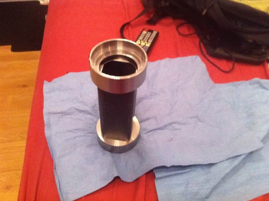

Re: Super sized stand-up Scooter project. Build thread
Postby Goped ESR750 » Sun Nov 06, 2011 10:53 am
offered up the headstock with the stem to see how it looks. It is quite a bit higher then it was originally. At least the length of the bearings cup. I could not fit the stem in the lathe to skim the step off, So I made a paralleled step to press on, it's not on yet. I am thinking of grinding the welds off, machining it.. The get it welded again. Think I will have to make a jig to ensure it goes back the same.
I need to get the bearing cup as close as possible though. Will need to cut some of the tube down anyway.
Here is few pictures of where I am at.

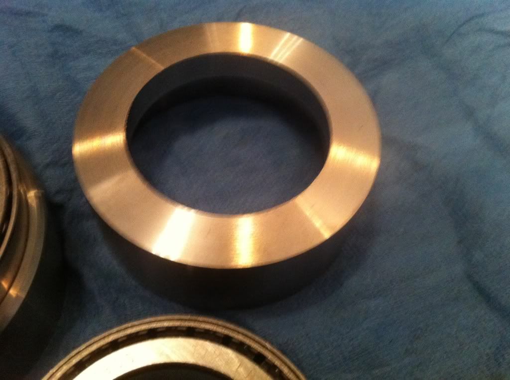

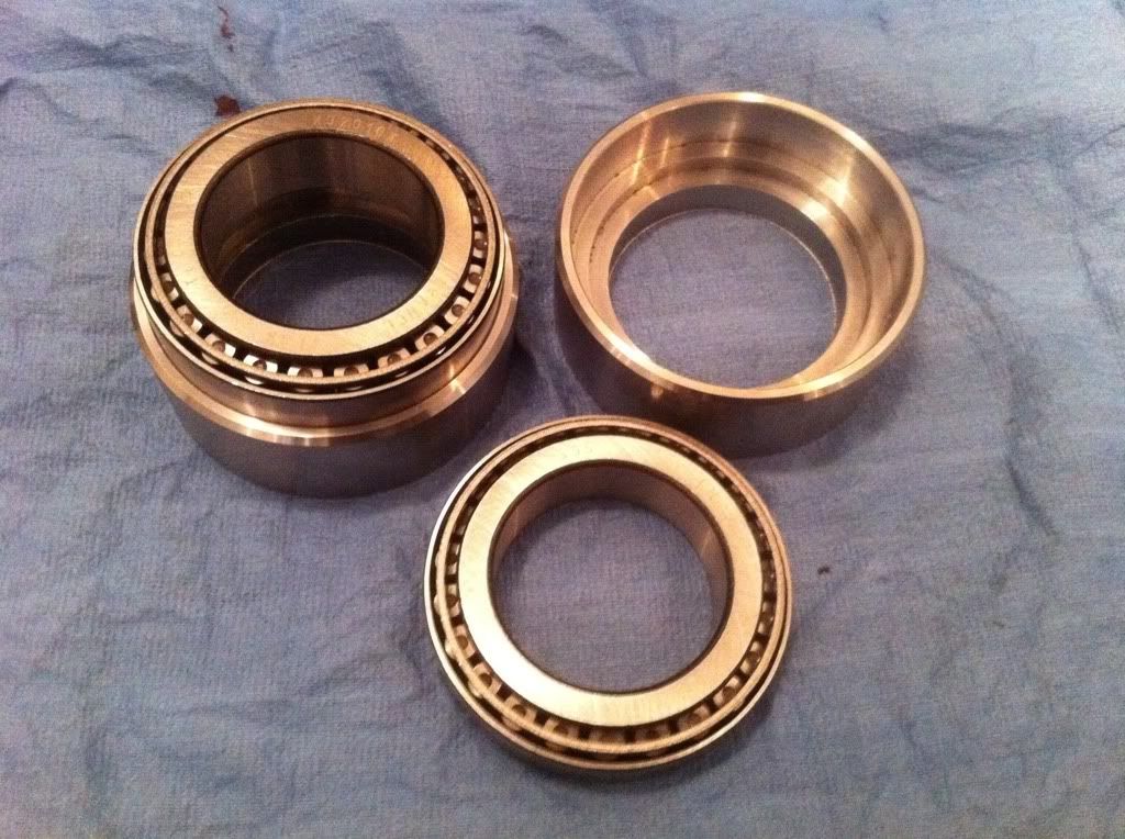

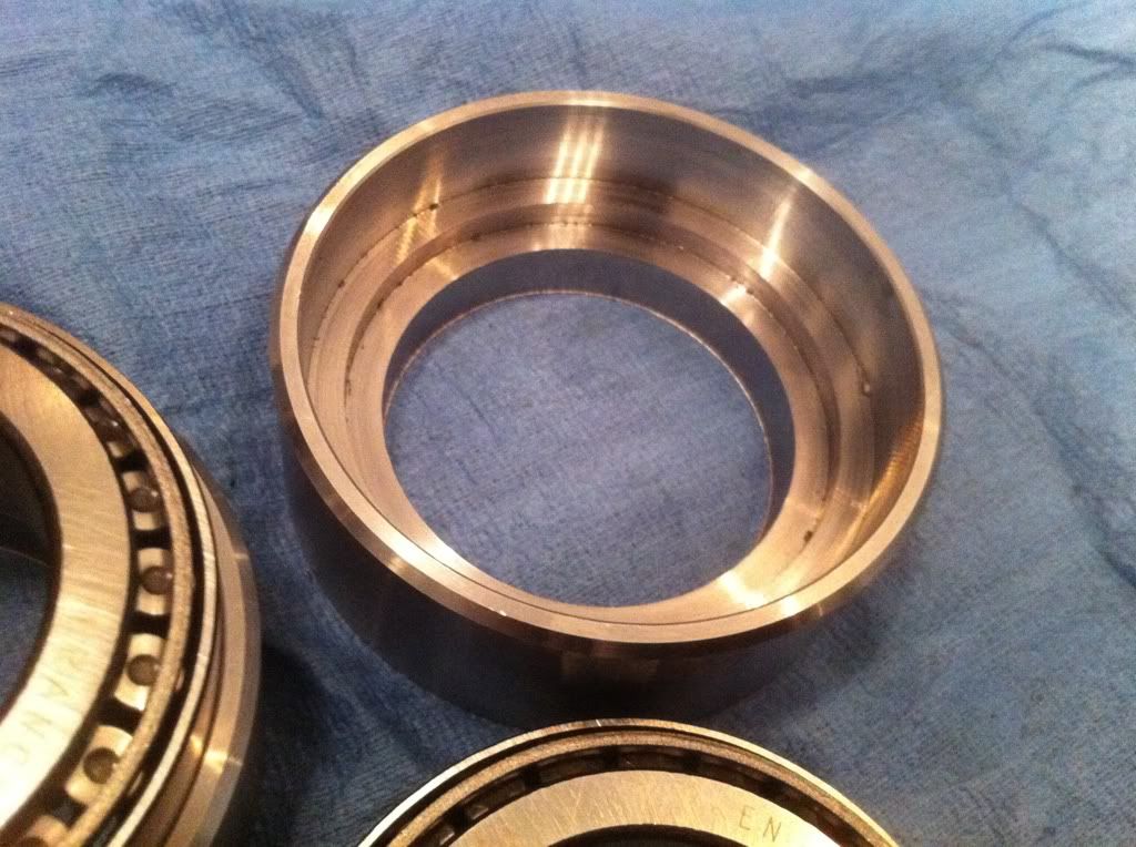

Postby Goped ESR750 » Tue Nov 08, 2011 3:44 pm
Finally got the bearings cups finished for the CIDLI today. Which was handy as this is the day I had set out to see the guy who is going to weld this for me. I am seeing a custom harley fabricator, who makes all sorts of big bike frames from scratch. So I am getting him to sort the frame welded to the original section I have and then a bend and then weld to the CIDLI knuckle.
Sample block of polyurethane arrived today. I got a 70A shore rating 25x25mm block. I am going to test it a bit, but I am thinking this should be an ideal rating. It bends easy but under compression is good. I am going to see how it reacts with different loadings in a manual and hydraulic press. Manual for rebound shock loading and use the hydraulic press to dump 30 tonnes on it to see what it does.
Probably use rods as opposed to block when it comes to it. am undecided yet. Look forward to getting a rolling frame sorted though.
