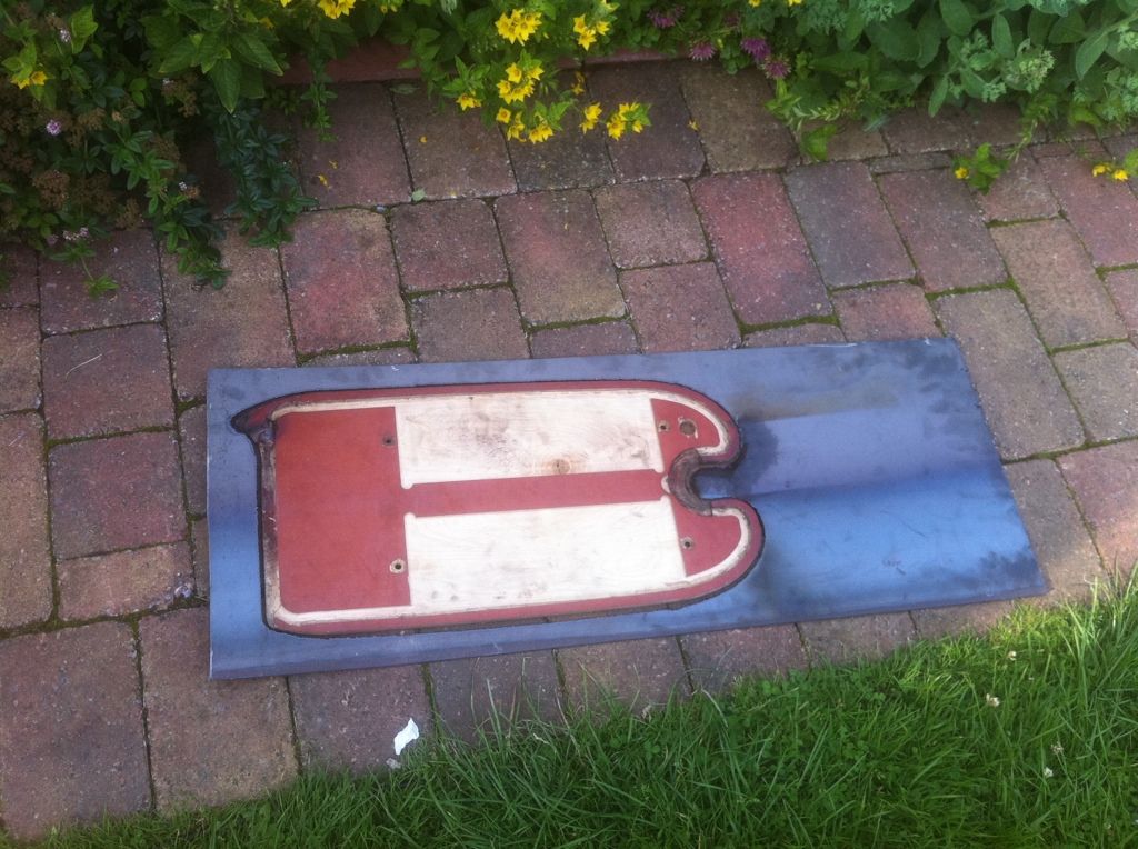

Re: Super sized stand-up Scooter project. Build thread
Postby Goped ESR750 » Sun Jun 24, 2012 10:54 am

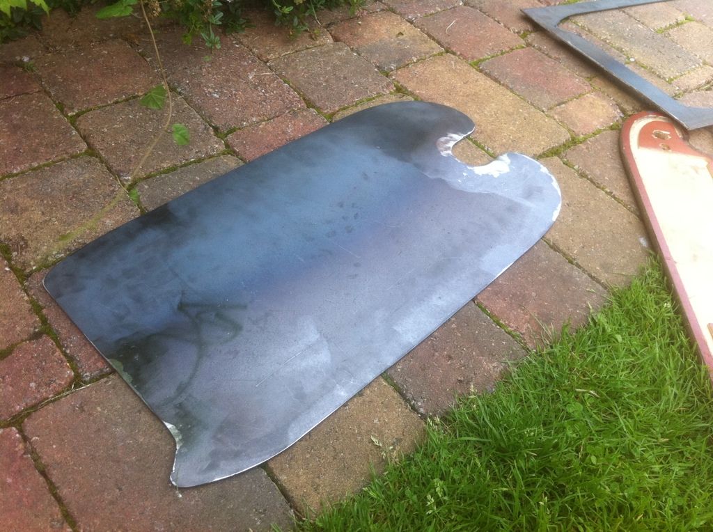

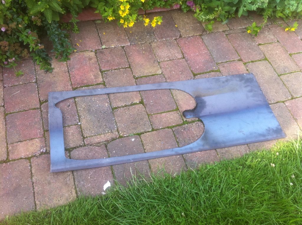

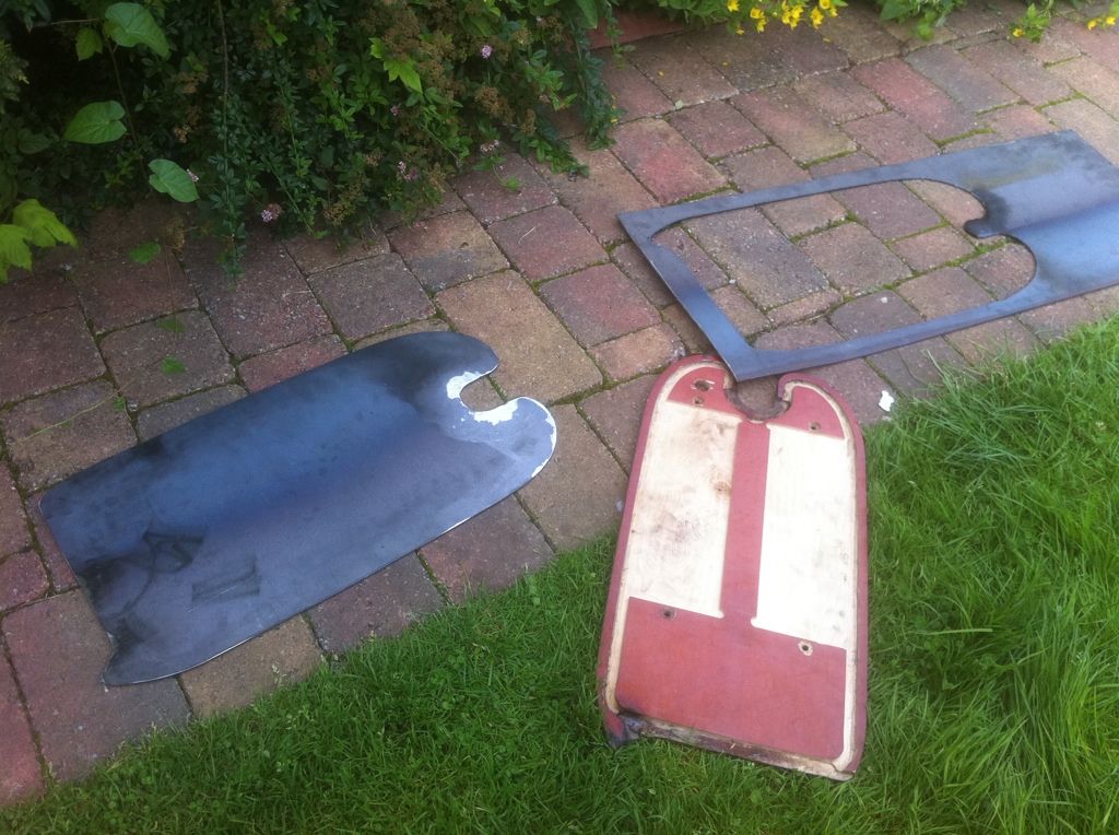

Tried the Go-Ped board on my frame for size. Seems to fit nicely. Will either use a new goped deck, or at least make one using my deck as a template. Certainly start looking quite Go-Pedy with the deck on, which is good as my inspiration was my original Go-Ped hence why I went through the trouble of making everything single sided swing arms, just like my Go-ped.
Been deciding which way to guide the chain through the frame, it either has to go under or over the suspension knuckle. The chain looks far betting going under the suspension knuckle, but being underneath the pivot point of the suspension does this mean that the chain will be fighting the suspension when it pivots?? Or is it perfectly fine to route the chain underneath the pivot point. Any opinions??
My feeling that it would be better to route it over the knuckle so that when it pivots it does not tension again the load side of tha chain.
Here is a few pictures of where I am at.
Goped ESR750
Posts: 89
Joined: Wed Sep 22, 2010 10:52 am

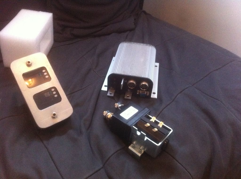

Postby Goped ESR750 » Sat Jul 21, 2012 1:58 pm
Tensioner seems to works, have not had a real test on it yet as I still have nothing to power the scooter with. I think the tensioner works better if it is tight with the top sprocket before 12 o clock. Have had a busy few weeks. Got new hoses for the brakes, and bled them. Only to find that the rear hose is too short, I ordered replacement ones for the scooter I took the brakes off, I think where I need to run the hose low it makes the route further than it would of been on the scooter. Need to order a 2.5m custom hose and replace the rear line.

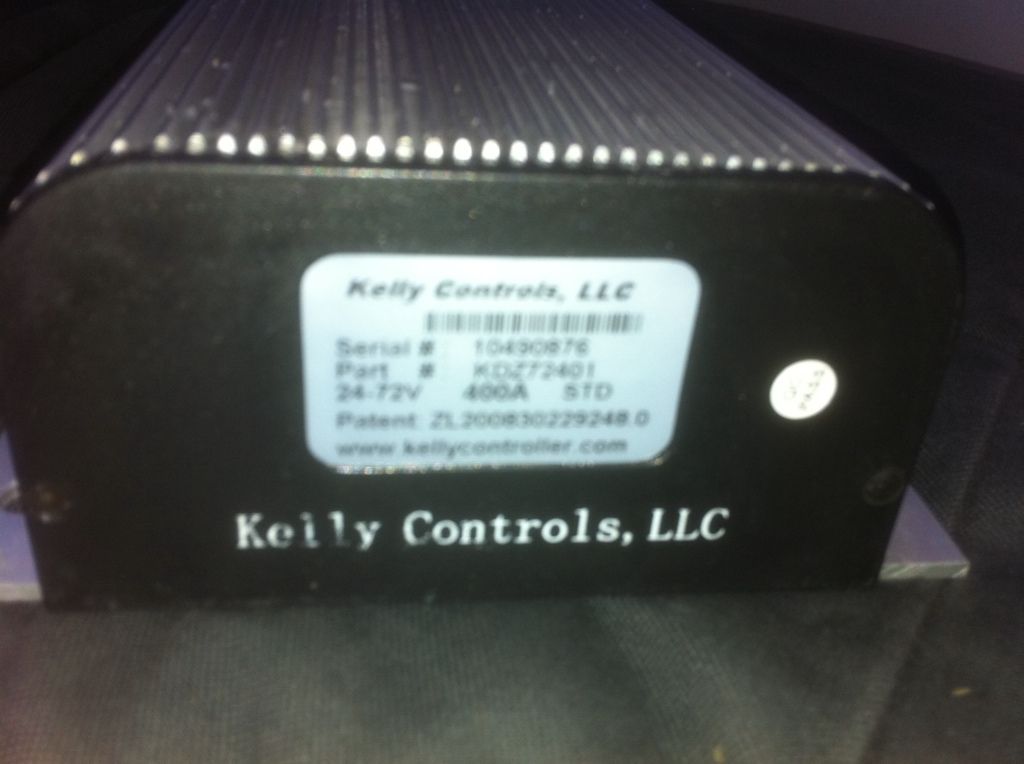

Have ordered the majority of the electrics now. I am using turnigy 8s 5AH nanotechs. The configuration should be 2s4p giving me 60volts and 20AH. The monitoring system is two handlebar mounted cell logs. One for each bank of parrelled batteries. These means that each the cell log will monitor four paralleled cells.
The banks will be charged in the same manner. Am using amphenol plugs for the monitoring and balance circuit. Will simply unplug to switch the cell logs off. Similarly the same port on the battery box will be used to balance during charge.
I hope for a four mile range. I opted for two chargers so I can charge both packs at the same time. They are 10AH charges so should be looking at a very quick charging time.
Have not yet received the batteries which is unfortunate as I want to start work on the battery boxes. This is pretty much all that needs to be done to finish the frame. I cut out the deck with my plasma cutter today, used the original go ped decks as a guide. Which makes my decks the width of the nozzle larger than the original go ped. Think space may still be a little tight, especially as the controller is a lot bigger than the last one I used. I selected the waterproofing tab on the controller and plan on mounting underneath the motor mount, external to the battery boxes. Or on top of a rear mud guard if make one.
Got three weeks off work now so progress should be quick.

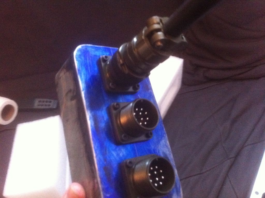

Postby Goped ESR750 » Sun Jul 22, 2012 12:46 pm
Been doing some electric work today. Soldered a few sockets and crimped the other end to fit the cell logs.
Also made up one end of the monitoring plugs. I have ordered some stainless steel braided sheath to go other the cable to make it look better, so won't make the other ends off until this arrives.
The controller needed two led's on the display, so added these too.
Few pictures of what I got.

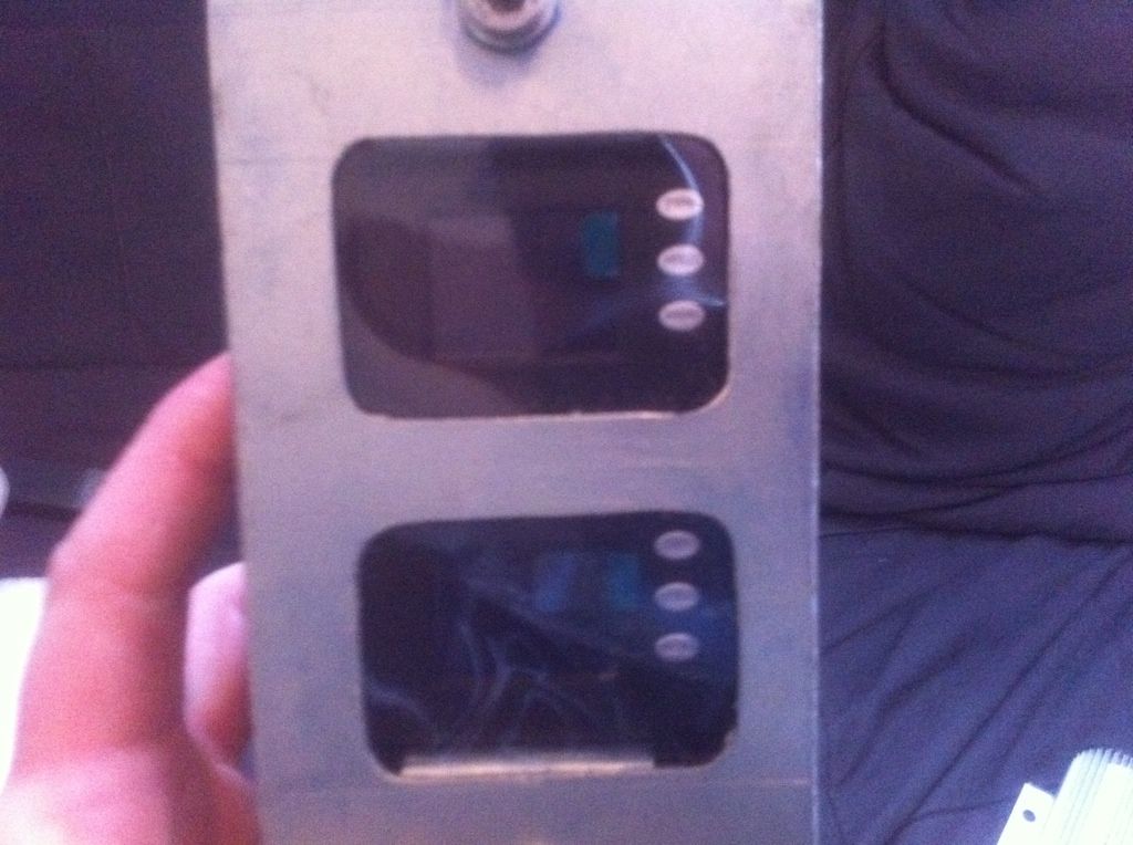

Postby Goped ESR750 » Tue Jul 24, 2012 4:48 pm
Been working on finishing the electric for the dash box. Added a pot to adjust the regen, a key switch and a small switch that put a pre charge resistor across the contacts. In the manual it just shows in the diagram it always being on, but it draws 10W so decided to make it switched. Just push it for a few seconds before I turn the key to bring the main contactor in, this stops any sparking.
Few pictures of the set-up.
