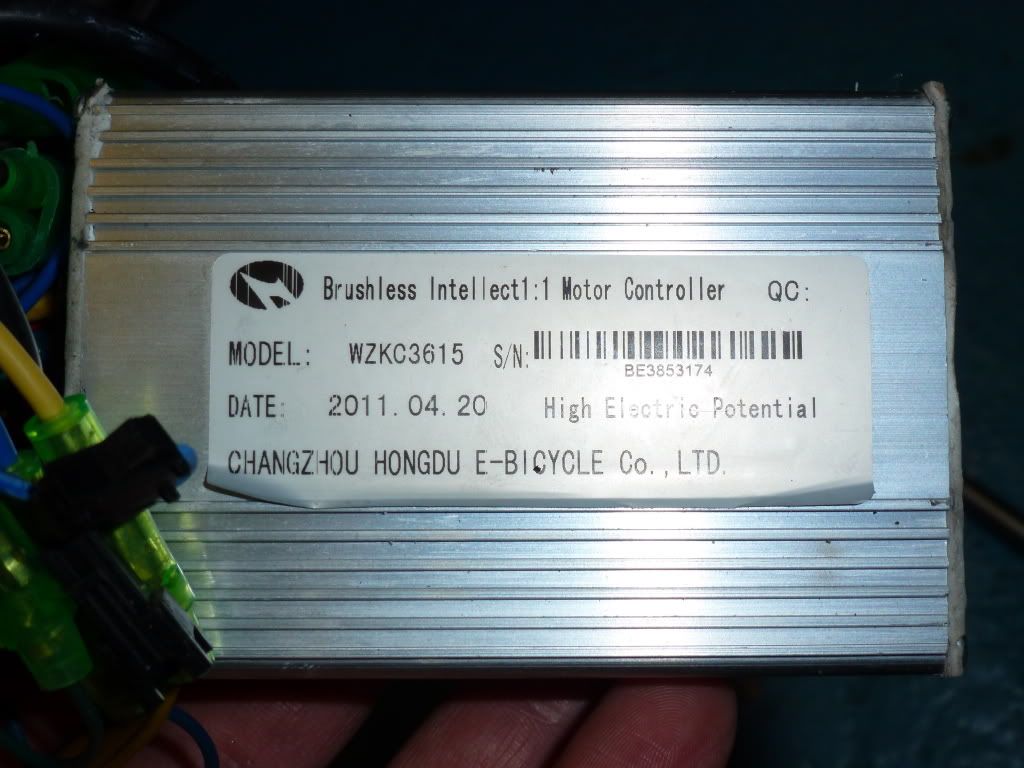

hi i am buying a pro rider
( heres link)
http://www.proridermobility.com/detail. ... ductID=332 VOYAGER ELECTRIC MOUNTAIN BIKE ( heres link)
i asked for some info on the bike and this it what they said
We can confirm that it is a 36V 15Amp controller. There is no need to fit a bigger controller as a 250W peak motor(maximum allowed by LAW) at 36V is just under 7Amp at maximum – Ok peak can be a little higher on load but you are also restricted with a 10Ah Battery.
is the anything i can do to derestrict it ,i beleive it will do 18/19 mph but restricted to 15 uk law ( i will take pic of controller later) i can i change anything on controller to get 10amp or buy different one its only for work but would like to go 18/19 mph thanks in advance

Postby Russell » Mon Mar 26, 2012 12:15 pm
Stesteste,
If you have one of the controllers mentioned in the original post then it comes equipped with a pair of speed limiting wires. With the wires connected the speed is limited, with them disconnected it is not.
-R

Postby Tench » Mon Mar 26, 2012 2:42 pm
I only added some solder around the legs of the single wire shunt to build a small fillet up, when this was too much i just melted it again and some was taken back on to the soldring iron, i reduced it untill it would not trip the BMS. I didnt disconect any wires as speed was not my concern, the small wheeled wayfarer model is fast enough at 20mph. They do pull more than 250w during accelaration as standard, it is quite sprightly now and fast enough, you would probably want more than the BMS will allow for the mountain bike though but taking it to the limit like i have is a good improvement.
I imagine that the cells are 1c so the pack is restricted to a 10a max current? 10a x 40v is 400w, this is about all you will get from the std battery BMS.

Postby d8veh » Wed Mar 28, 2012 4:05 am
On these sort of bikes, it's not the controller that limits the speed. It's the motor/battery.
Some controllers have a pair of wires to fix the speed to 15mph max. They're easy to spot because they're single wires. Most of the other wires are two or more to a connector, so, if you find two single wires connected, disconnect them and see what happens. The most you can expect is to go from 15mph up to about 18mph
You can increase average speed by adding some solder to the shunt in the controller, which gives more torque, as has been indicated above, but often the battery can't give much more and you run the risk of early battery demise and frequent cut-outs.
A very easy way to increase speed is to get a higher voltage battery. A 12s lipo pack at 44v will work with your existing controller and will give about 20% increase in speed (as long as the controller doesn't have speed limit wires connected). You might be able to go to 48v without burning the controller, but you'll have to look inside to see the rating of the capacitors. They need to be 63v or more. 48v will give a 33% increase in speed.

Postby Tench » Thu Mar 29, 2012 3:20 pm
Hi, i have taken some pics of the shunt with the solder added, any more than this caused the bms to trip, and of the controller label, it doesnt have the white wires but there was a single blue wire that came out of the controller and also another it would plug into, these where allready disconnected, they could be alternative timing wires?
Did you get your bike today? are you pleased with it?
