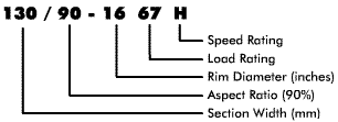

most motorcycle tires are coded as such:
i'm not sure why some like the shinko dual sport are measured 19 x 2.75.. but according to this code, that would be more like:
70 / 90? - 19 ....
when looking for 19" tires, i see tons of 100/90 tires... but since 100mm = 3.93", those are primarily rear tires, and nevermind getting them in a bike!
the shinko 244 has only one tire in the 19" size, but many in the 18"... so if someone wants tire variety, they're better off getting an 18 or 17" mc rim...
