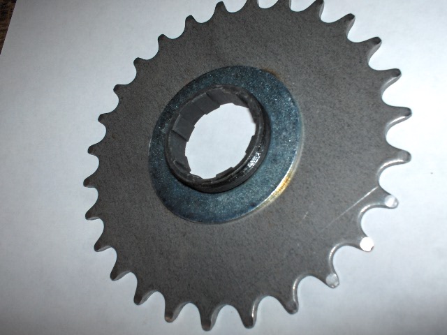

There are 3/32" and 1/8" chains, and there are 3/32" and 1/8" chainrings. Single speed freewheels, coaster and gearhub sprockets, and fixed gear cogs also come in thick and thin versions. However, multi-speed freewheels only come in 3/32".
For a single speed chain drive, you can't use a thin chain with a thick sprocket, but you can use a thick chain with a thin sprocket. So 1/8" chains work with both sizes of single speed sprockets. Multi-speed cranks and freewheels only work with thin chain.
When you get more than 7 speeds on a freewheel or cassette, you have to use a chain rated for that many speeds or higher. 8-speed and up chains get successively thinner on the outside, while still remaining roomy enough on the inside for any 3/32" sprocket. So yes, a 10-speed chain will work just fine on a single speed setup as long as the chainring and rear sprocket are 3/32". But then, so will a 1/8" chain or the much less common 3/16" chain.
For these reasons, I always go for 3/32" sprockets when I have the choice. They give me the option of using any chain available. I use 1/8" chain when it works, because it's cheap and it lasts longer than 3/32" chain.

I'm thinking bad chainline, insufficient wrap, insufficient/inconsistent tension, or a combination. Whatever it is, it's not likely related to chain width, so it'll probably reoccur with a different chain.
That said, there's no harm at all in matching the chain width to the sprockets.
Edit:
Be sure to let the B tension adjustment on your derailleur all the way out, to maximize wrap. The chain should be shortened compared to that of a multi-speed cassette, but not to the very minimum. Leave enough length to get your wheel in and out without a fight. That should result in a good balance of wrap and tension.

Post by WoodlandHills » Nov 04, 2016 11:39 am
Harold25 wrote:I just purchased an Sturmey IGH RX-RK5 for my bike, however I'm having trouble with the chain slipping on the front kog. What kind of kog do you use on the front? I know the RX-RK5 uses thicker chain, because we could not use 9-Speed bike chain on it. However, the new chain we're using keeps slipping on the front kog. I've got a new front kog meant for 7 speed chain on the way, and we've got the rear derailleur tentioned nice and snug. Do you have any suggestions? I'm curious about your setup.
I noticed that the thicker chain seems to float on the front kog, so I'm hoping the new kog will be thick enough to alleviate the slipping problem.
What motor and what chainwheel are you using?
My front chainwheel is a Luna Mini 30 for the BBSHD and I am using a heavy duty single speed chain by KMC. With 180 degrees of wrap around the chainwheel, I cannot see how you would get a slip with new parts..... The only time I ever had a front chain derailment was using the Luna Eclipse, the long gear teeth did not get along with my setup, all my other chain issues were at the back and were due to the misalignment between chainwheel and IGH cog. Adding a chain tensioner/guide fixed everything by guiding the looser lower chain onto the cog on the hub. A Surly Singulator is what I used.
Chainline with Luna Mini 30 and homemade cog
Modified cog for 3-speed IGH using AN hardware to improve chainline
28t BMX chainwheel, similar 28t chainwheel modified for use as a cog, SA 18t cog before welding to 32t cog
