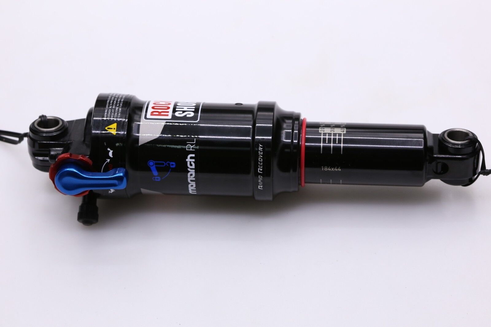

On my bike, I have a 9C rear hub motor and the battery is on a rack over the rear tire, so all the weight is on the back of my bike. I mostly ride on the road but sometimes I have to ride on the sidewalk. Currently I have a 2 month old Rockshox Monarch RL on the bike with a RST Omega front fork. The front is fine, but on the rear, it's still a little bumpy and stiff, even with me adjusting the settings and running low air pressure in the shock. I am looking for something that has more cushion. Need recommendations.
The Monarch RL is a great shock, but I think it's better for mountain biking - trails and xc.

I think you may be correct on this. I spent 200 bucks on that Monarch RL and expected more since I paid that amount of money on it. I dont plan to spend anymore if it won't yield the results I want....to have better small bump sensitivity. I may try a cheaply coil shock with a very low spring rate. The one that came with the bike is way too stiff at 850lbs.

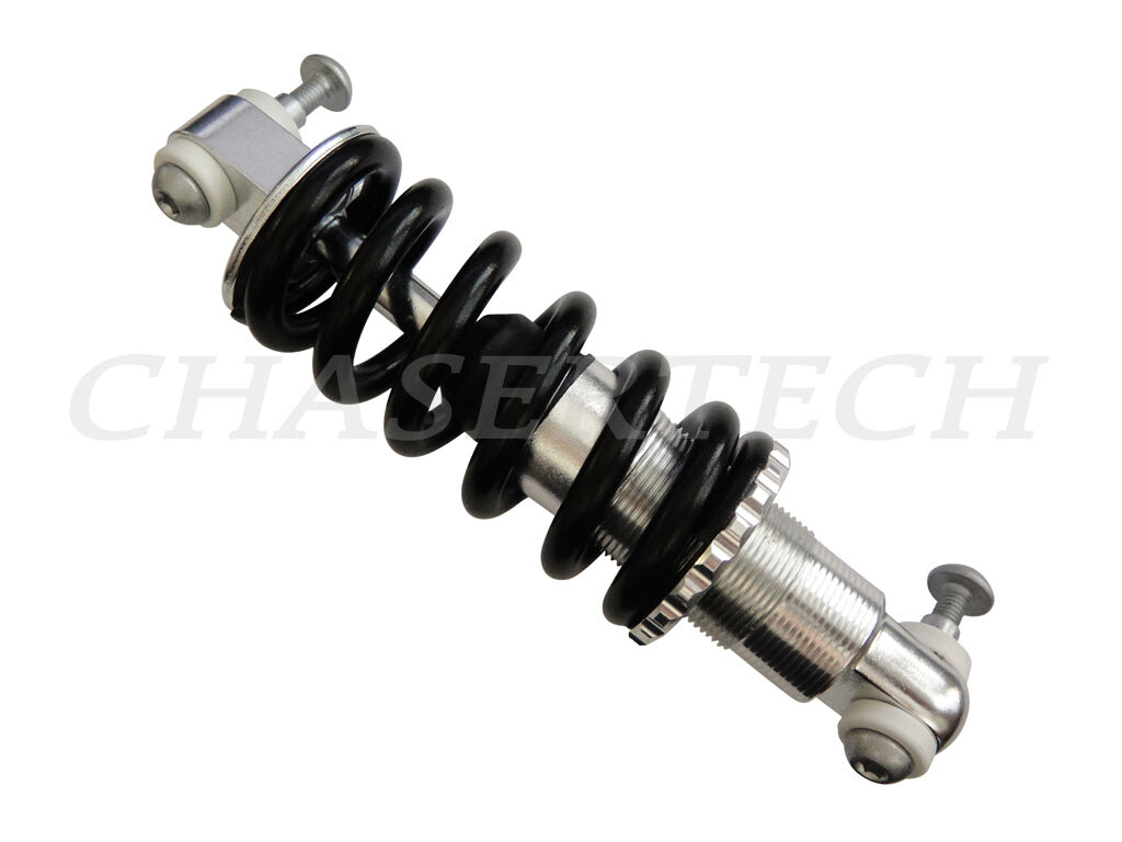

So I bought a cheap $20.00 coil shock off of ebay with the lowest spring rate I could find, which was 350lbs/in.
Anybody want to guess how it performed/compared to the Monarch RL?

Grider wrote:
Jan 11, 2018 9:53 am
UPDATE:
Superbly!
(Over road ripples; less well over big bumps.)

YES!!! It's just overall better!!! Now I am going to try to "dial" it in!! The 20 dollar part did the job. But the $200 modern high tech shock just didn't work out! On little and small bumps like the sidewalk it's not as harsh or sensitive. And on bigger bumps, its fun because it's springy!!
The winner!!!:
The loser!!!:

Yeah a coil will always win. Especially on a frame that isn't designed for an air shock, leverage ratio/curve, etc.
At least get one with dampening though That one pictured is like Walmart quality. I'd imagine it won't be great at high frequency impacts and the lack of rebound dampening could potentially send you over the bars in the right conditions.

Works great all around for me. Cheap shock suprisingly got the job done over the brand name.

cheap coil shocks can be simple w/ no damping
but some cheap ones w/ some rebound damping have primitive designs that have "spiking" issues i.e. very harsh on high-speed hits
