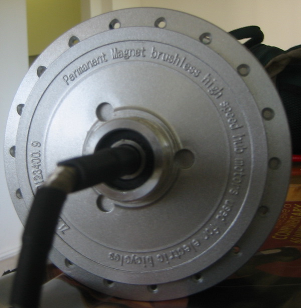

Has anyone opened one of these up? It doesn't have screws like the black one.
The screws at the top are just for the disk brake.
There are three dents in the drive side. You will need to put a spanner wrench in them and screw off the cover- counterclockwise like a normal screw.
Hey - thanks a lot for all the help John. These are the 3 dimples I take it.
Is the spanner you used one that is for the bike world, or just a typical automotive one?
Any spanner that fits snugly will do. I am sure the factory has a special one with a backing nut to hold it down.
I picked up some 20 inch channel lock pliers today. They adjust up to 5 1/2 inches. Sweet :!:
Just want to confirm that it's counter-clockwise before digging into the soft cap.

zukster said:
John, I just wanted to confirm that it's counter-clockwise to take off the Bafang motor cap?
Zukster, if it is not CCW, then normal pedaling would unscrew the motor case. By inspection, it must be RH threads, normal CCW, lefty loosey, righty tighty.
