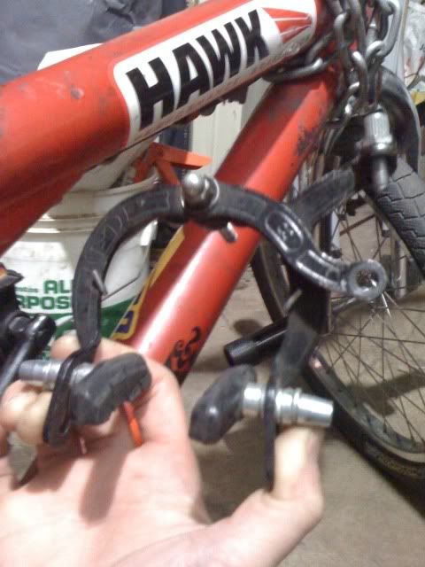

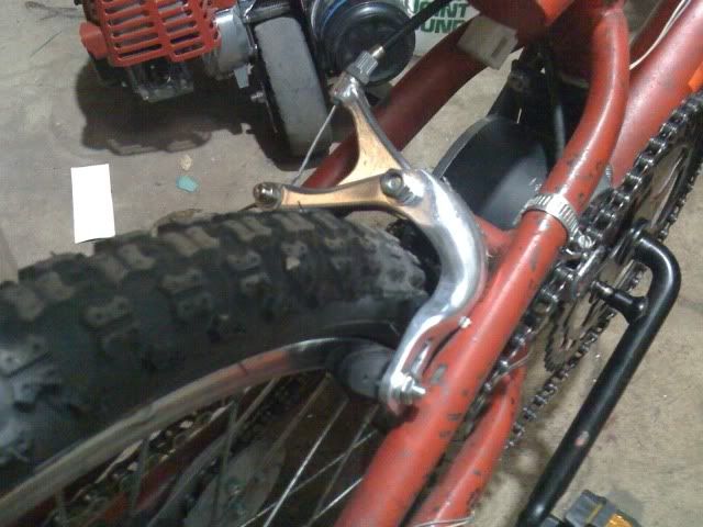

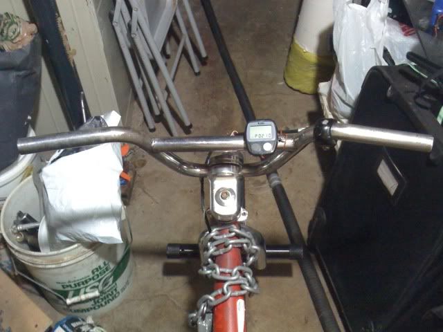

Postby def215 » Sun Nov 28, 2010 1:40 pm
so its been down for quite a while now :cry: , so i havent really messed with it for a while. just playing with the propane goped i have. last time i really remember riding it was when i met up with another fellow ES member, mwkeefer, which was like more than a month ago. well the weather is too cold to do any of that anymore in this season, so i guess i gotta wait till next spring, unless i ride in the snow :twisted:
still waiting for my twist throttle to get here from china, which should be next week. that would make it a whole month :roll: . upon the upgrades, i did get new rear brakes:
i think i ordered the wrong ones, these might be for a road bike. they fit, so why not...lol
they look way better than my stock ones. these should be able to stop me better than before :wink:
the old ones sucked ass. if i was on the brakes too hard, they would deform and flex. :roll:
still waiting on my throttle and grips. its feeling a little bare on the handlebars.
i also put on a new crank(not better, but a replacement i had laying around), and got pedals that werent broken. i still want a decent aluminum set. and i put my kickstand back on it so i dont have to use a wall, or chair, or bench, or table, or pole, or curb, or myself as a kickstand anymore...lol
also i ordered one of those spycams off of ebay for like 7 bucks to take with me to get ride footage or something of the like, like this one:
http://cgi.ebay.com/Car-Key-Chain-Hidde ... 0713915488
ive seen that they work pretty well in that thread here, so i thought i give it a shot. if it doesnt work so good or i break it, i cant be mad that i blew 7 bucks on it. :mrgreen:
so until i get it working again...
