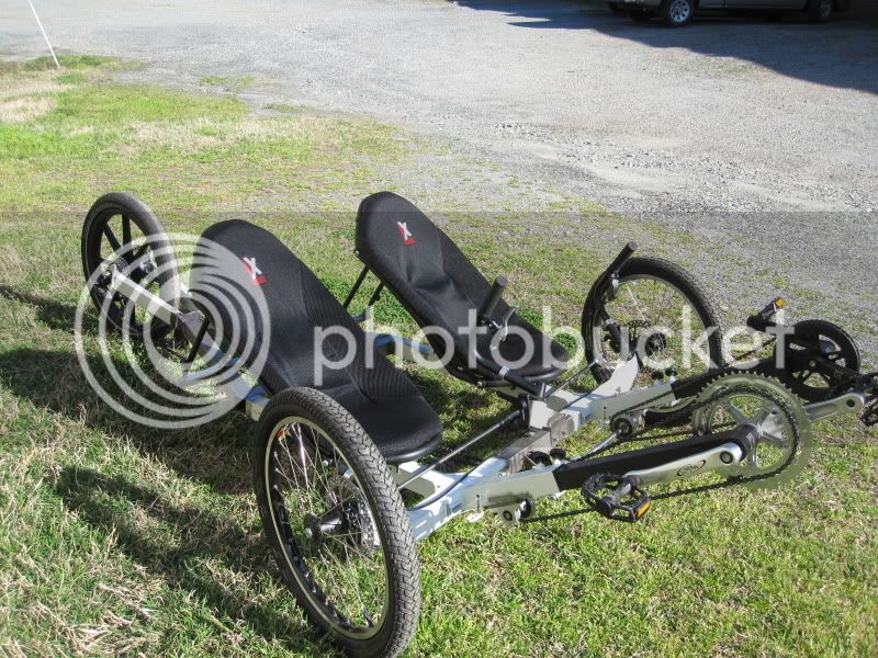

Hey guys and gals,

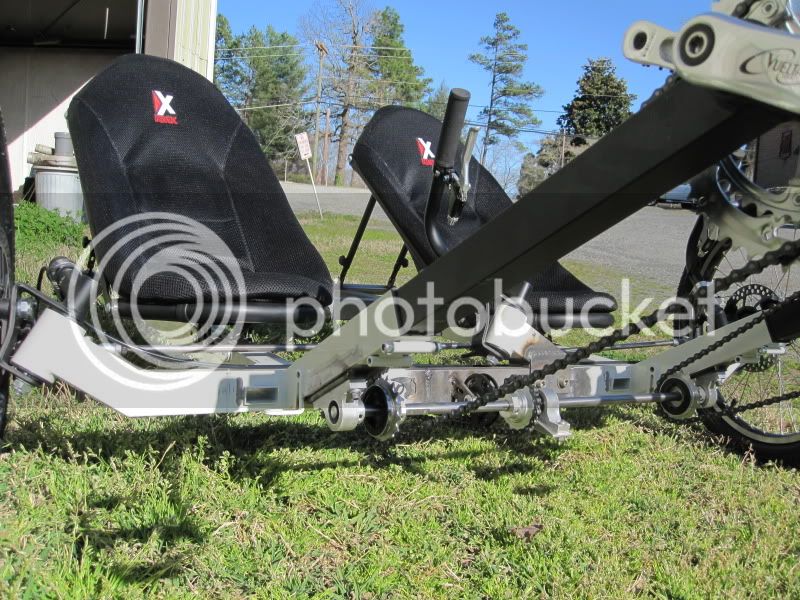

VRDubLuv(Tommy) and I have been working on a project on the weekends for several months now and it's time to show our progress. I'll give a little background for it first.
It all started when a student at Elon University found Tommy's website (http://www.ffrtrikes.com) and contacted him about a fundraising project. The project is to build a tandem electric recumbent that has a hub motor and uses solar power to charge. They are going to ride across the country on it in an effort to raise money to buy some solar panels for some universities Sri Lanka so they can consistently power their few computers.
I know it's not a "Non-hub Motor Drive," but I figured it would be greatly appreciate here.
The website for the project is http://www.wix.com/trivelo/the-trivelo-project
We started with two KMX trikes and now we have this!
Anyways, enjoy the pics!
Way, way cool!

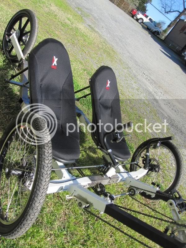

Looks like you could make it a little cleaner looking if you change the way the seats attach in the back. You could come out of the square holes there at the cross piece and go up. Then you'd have two larger supports instead of 4 smaller ones and you wouldn't need that extra little pipe running across the frame...you'd have that whole triangle for cargo.
I guess you could always add a rack over the rear wheel if you needed more cargo space too...so, yeah..I love it! later

How wide apart are the front wheels ? tire size ?
wheel base ?

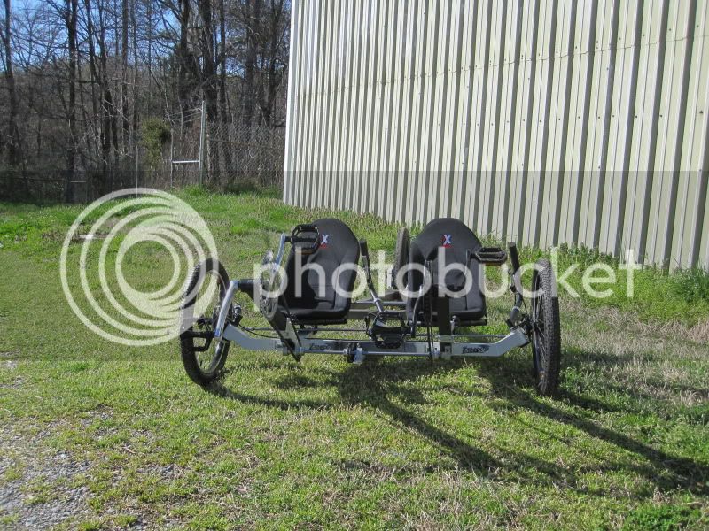

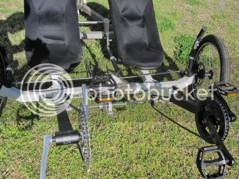

It has 20" wheels all around. It weighs in at around 83 lbs. It's about 53" wide, 80" from the front of front wheel to rear of back wheel, and about 93" from the rear of the back wheel to the tip of the boom. It's pretty big and long! We have been pedaling it around and have had some traction issues in the gravel, but we don't have all of the weight on it yet. However, we capitalize on the traction issue... who doesn't like to slam the rear brake and do a 180?
I'm not sure exactly which Crystalyte motor Tommy is planning on purchasing, but I'll see if I can get him on here to give some more specific details.

That is one wide trike excellent job fellas!
I too noticed the seat supports looked a lil 'rushed' or 'tacked on'
Here's a lil photochop that would free up more room for
cargo/panels etc

That does look good! That really smooths the flow of the trike. We wanted to use the existing tubes on the seat to maintain adjustability, but if we could figure out a way to rig it up like that and keep it adjustable, we just might have to. Maybe on the next tandem - RC powered one :twisted: .
We are a little rushed :( . This thing has to be ready by June 7th, the start of the trip. I work full time and Tommy is a full time student 90 miles away. I will definitely think about that though.
We don't have any plans for any sort of a roll cage, however, the solar panel will be mounted over top of the trike. We are trying to get a 440 watt solar panel from a company called ASP in Florida. It will cover the footprint of the trike and weigh about 60 lbs. We'll have to have some serious bracing for that, so the outcome may pretty much be a roll cage.

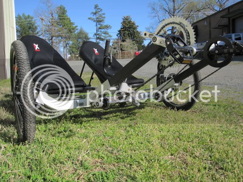

I'm not sure how fast we've had it pedaling yet. Probably around 20. We have some more decisions to make about gearing and probably some adjustments to the location of our common shaft to fit a larger sprocket (the one that drives the rear wheel).

My thought would be to use a 24" hub motor and 20" wheels in front like the KMX Cobra

What is the distance center to center of the seats ... same as center of crank to center of crank ?
24" ??

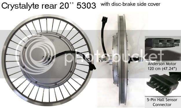

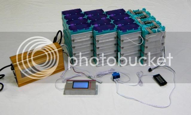

I went ahead and placed the order from Elite Power Solutions for the 48V 60Ah LiFeMnPO4 battery with BMS, charger, and LCD Display. That will put us right at 3 kWh of capacity. With 80% DOD, with will have a usable capacity of about 2400 wh. We're hoping for about 50 wh/mile, so that would put us at 48 miles with no solar or pedaling input. In good sun, we're thinking that the 400 watt input from the panel could almost double our range, to nearly 100 miles. That would allow for about 5 hours of riding at an average speed of 20 mph with no stops. With some stops to let the panel soak and our legs rest, some pedaling, and an occasional plug in, we hope to ride about 150 miles per day.

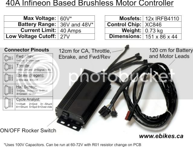

Next week Justin from Ebikes.ca is getting some more Crystalyte 5303's back in stock, so I plan on ordering a 5303 laced in a 20" wheel from him next week, along with a 40A Infineon. I wish we could get the 5303 and wheel in black :( But it will work all the same! :D
24" ??
Sorry, but I just got a chance to measure that for you yesterday. We have them seats at 23" apart on center. That gives us more than enough shoulder room. It could probably be .5" to an 1" narrower and be almost, or maybe even just as comfortable.
