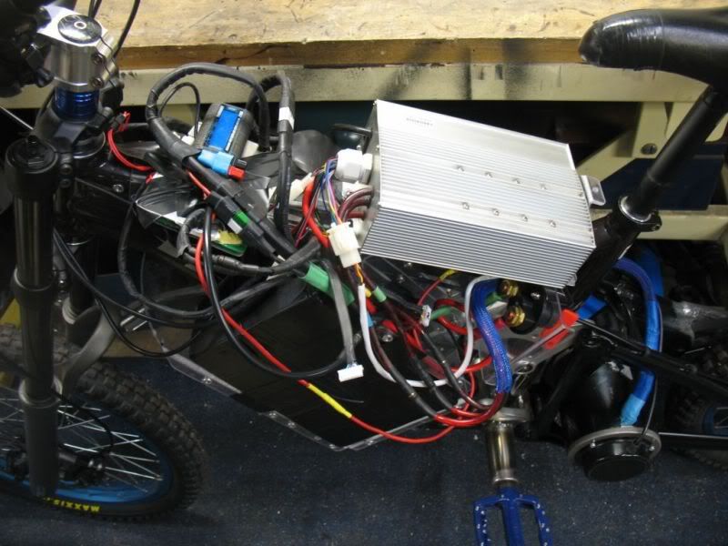

I've made some progress with the battery and controller mounting. I'm using the same lexan material and set up that I used on my Giant NRS build.

Postby 1000w » Fri Jun 15, 2012 12:22 am
I have basically finished the battery box now, other than covering it with the carbon fibre vinyl which should be in the post.
The box appears fairly large however it all feels fine between my legs, not too wide.
1000w
Posts: 353
Joined: Sat Apr 26, 2008 6:24 am
Location: Western Australia
Re: Belt driven off road bike (Giant Reign)
Postby AussieJester » Fri Jun 15, 2012 11:09 pm
When the CF is on she will look the business...really looking forward to seeing her rip, turn the juice up on that 24Fet and the EV grin well be HUUUUUGE.... LOL
KiM
AussieJester
Posts: 9416
Postby 1000w » Thu Jul 12, 2012 10:14 am
I have now got this bike running, well thrown together, so I can test the belt drive and idler pulleys.
The original set up with an idler on both sides of the belt proved to be no good. I couldn't get the belt to track correctly and stay on the drive pulley so the tension side(top) pulley had to go.
So I had this.
And now I have this.
This involved some more modification to the top chain stay so I could get a straight belt line.
Some material removal.
And some material addition, this is some 6mm plate shaped to fit inside the chain stay.
Plate inside the chain stay.
This is welded in and partly ground smooth, still a little rough here.
I decide to add some material to the outside as well, this is 4mm plate bent 90 deg and shaped.
Then welded up.
Now I have a straight belt line.
This is how it all looks in testing mode.
Now how does a Cyclone 3000watt motor go on 66volts and 100amps?
Unbelievable! This thing is a monster at 6500watts. The front wheel was lifting just with throttle ie with no help from me pulling back.
Loads of torque, it doesn't seem to slow down on hills and the speed is right where I calculated, 50kmh or just over, I'll put a speedo on soon.
I have only ridden it for about 10min tonight so I still have some small things to sort out, but it gave me a sizeable EV grin.
