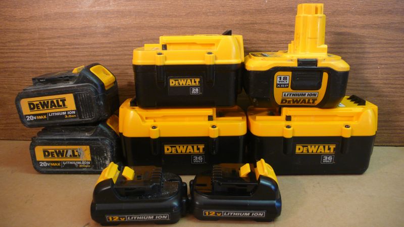

You might check stores that collect batteries for recycling, including toolpack batteries at hardware stores, places like Sears, Home Depot and Lowe's, etc, as you might be able to make a deal to take those away so they dont' have to deal with recycling them. ;)
Computer stores and repair centers also often end up with dead or old batteries, and may be willing to let you have those, too. When I worked at CompUSA and Computer City before that, we would have given them to anyone that wanted them, as long as the manufacturers didn't require a return of them for warranty purposes.

Postby MattsAwesomeStuff » Fri May 04, 2012 6:55 pm
amberwolf wrote:You might check stores that collect batteries for recycling, including toolpack batteries at hardware stores, places like Sears, Home Depot and Lowe's, etc, as you might be able to make a deal to take those away so they dont' have to deal with recycling them. ;)
Someone said Dewalt, I called, he said I could have all they have, and to check back in a while if I want more. Bingo. They're dead-ish LiFe, but, beggars and choosers and all that.
These are the ones that are the least cooperative. There is an industry consortium that runs many of our provincial (and your state) "recycling" programs that is corrupt. Their goal is to destroy the second hand market by having free "electronics dropoffs" and such, so that people don't give or sell them away... so everyone has to buy new.
Even the "good guys" recycling programs, volunteer run charities, are jackasses. The big setback that had me discouraged earlier today was one big such group telling me if I wanted their dead batteries, $10 each. I was like "But, they're garbage to you, you're literally paying to dispose of them aren't you? I don't want the used ones that work, just the dead ones". Nope, $10 or stop wasting our time. Great, thanks, so much for the protecting the environment, maximizing re-use mission statement for this "charity". It was more the attitude than anything that got to me.
But I'll keep asking around for individual stores, maybe they're not as big of jackasses.

Out of each pack, 1 or 2 cells dead. 70% working just fine overall.

A word of caution about Ebay buys of extracted batteries. Out of the box, 34 chargeable, 78 dead and gone. 30% success rate. (Compared to 70% from disassembling packs I rescued myself). These packs have clearly been picked through already, likely by the sellers, and the ones on top were, by far, the more often working ones than lower down. I suspect they threw in a few questionable ones and padded the bottom of the box with ones they knew were dead (visibly leaking electrolyte or chained to ones that were). So, buyer beware. You'd be better off buying packs not disassembled yet so you can be the lion rather than the jackal.
Batteries were all 3V+ or under 0.1V anyway, so that made Keep vs. Scrap easy.

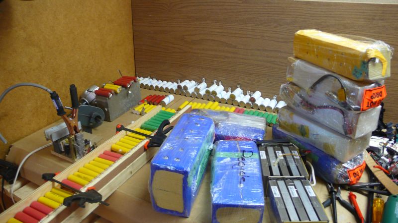

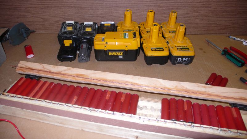

Built a massive parallel charger for the 18650-sized cells.
And picked up another load of "Dead" batteries. Still about 70% recoverable:
And then the motherscore. Had a contact hook me up with some "dead" LiPo packs and their BMSs:
65 pounds worth of LiPo. $5000 worth of cells, if new and functional. Which is somewhere around 4000Wh. Which is somewhere around 1000km (600mile) range at 25km/h (15mph) with no pedaling.
A few issues:
1 - I presume for them to be "dead" that some cells are overdischarged and gone. But they're stuck together with adhesive powerful enough that I think I'll tear (or at least bend) the bags if I try to actually remove the dead cells. So, I'll probably just disconnect them and haul their carcasses around.
2 - Cells are maybe not all matched, and with cells so large this actually matters (8 in parallel at a time averages out, 1 does not). Many of these cells seem similar, but I might find myself limited to the capacity of the smallest cell.
3 - LiPos are fragile.
4 - Charging might be an issue now, I might have to build a gigantic switchmode power supply to regulate current.
5 - I don't know how to configure the BMS in each of them, so that they'll cooperate with each other (multiple BMSs in.. series I guess).
I'd hoped to be riding back in April already, but, feature creep is having me lean towards building a better bike later than a crappy bike sooner.

MattsAwesomeStuff wrote:Built a massive parallel charger for the 18650-sized cells.
Just beware of it not actually contacting all the ends at the same time. If you use enough clamping force, fully parallel along the wood, it should "indent" the wood wherever some cells stick up a teeny bit more than others and then get them all connected properly. I ran into problems trying to do the same thing using only two inflexible metal bars, where the cells didn't all make contact properly at both ends, as they are not all exactly identical (even the ones from the same manufacturer), sometimes because of torn-off tab welds and such.
Denatured alcohol (or even isopropyl) will usually at least temporarily "deactivate" many adhesives, and usually permanently remove them. Just test to be sure it won't damage the cell casings first. (almost certainly will not, but check...).
Outside or in a well-ventilated area, put DA in a bowl or container big enough to partially immerse the pack in, and let it soak a few minutes, then try a plastic shim (about like a credit card but with no stamped-raised stuff on it) to slowly insert into the gaps between cells. Once a gap is enlarged a little, re-immerse the pack and soak, and keep repeating till it's all done. Alternately just use something to apply the DA to the adhesive areas/gaps and enlarge with the card, if you don't have a container large enough for the pack.
You could test them once assembled into groups, under load, and see which groups of parallel cells have more voltage drop or run empty faster. Mark each group with this info, and then build a pack with the best groups. The other groups you then troubleshoot with a binary search to find and remove the problem cells, and repair with any spare cells.
If by "LiPo" you mean "pouch cell", then yes, they often are. But remember that LiPo doesn't specifically mean that type of cell. ;)
Look around for old lab power supplies; usually adjustable voltage and adjustable current. FInd one that will handle all the current you need, evne if it's voltage is not high enough. Find other power supplies (with isolated outputs) that can also supply at least the max current you want, even if they have no current limiting, and can do it at at least (or more) the difference in voltage between what you want the pack to charge to and the lab PSU's max voltage. Then series all the PSUs, and use the lab PSU to adjust the final total voltage, and the max current limit.
Maybe, but you might need diodes for that. There are several discussions from the last few weeks about that; sorry I don't have a link. Might be a wiki article with the links.

Just beware of it not actually contacting all the ends at the same time. [...] as they are not all exactly identical
*takes a better photo*
Not a problem. There's at least 1/8" of compression from each, and I clamp the whole top bar anyway.
This was the plan when I was using many LiFe cells and had extras and an infinite supply of them. But my supply of LiPo pouches is probably, at least for the foreseeable future, limited to what I already have. So, "extras" might be hard to come by. No matter, I'll have to make do.
I have enough electronic knowledge to build my own power supplies, for free, from dead appliances and such. At least, pegging a constant voltage anyway. But adjustable current requires actual dynamic electronic control and isn't easy to build.
The bigger problem is that my LiPo pack might be as large as 4000 Wh. The fastest I can drain a home circuit is at 1800W, so that's ~2.5 hours to charge if I'm flatlining the breaker. Charging at home, overnight, whatever is a trivial task for me. But charging on the road while making rest stops isn't as easy. An 1800W charger would weigh ~20-40 pounds.
Versus, if I was using LiFe batteries, you don't need to bother with current control on the charge cycle, I carry a power cord with a built in rectifier and smoothing cap, and a big run cap in series to limit current and I'm done. No transformer, no regulator, just right out of the wall at 120vac --> 170vdc.
Good news: Of the first 43 cells I tested, 42 of them seem in perfect condition. I'm not even sure how these got reported as "dead", even cells marked as dead show identical voltage to the others. *shrugs*. Maybe the BMS left on them for weeks/months slowly revived the dead cells.

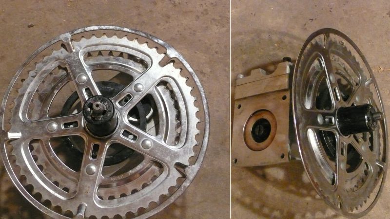

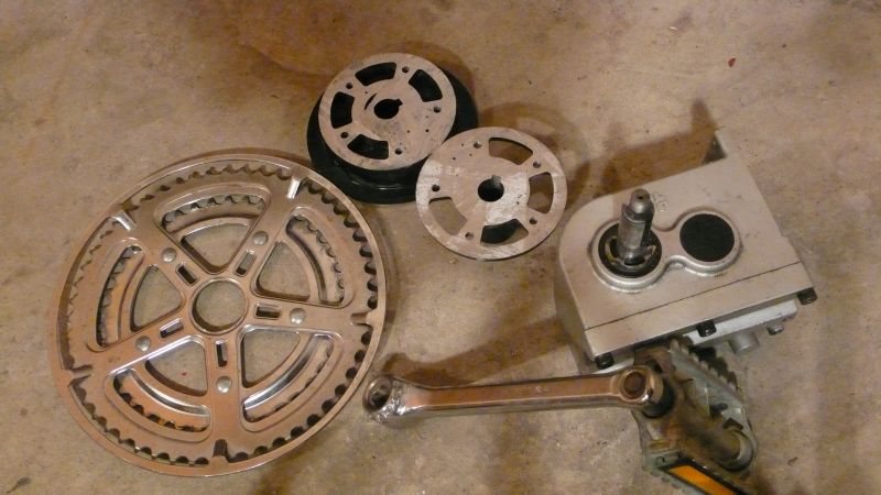

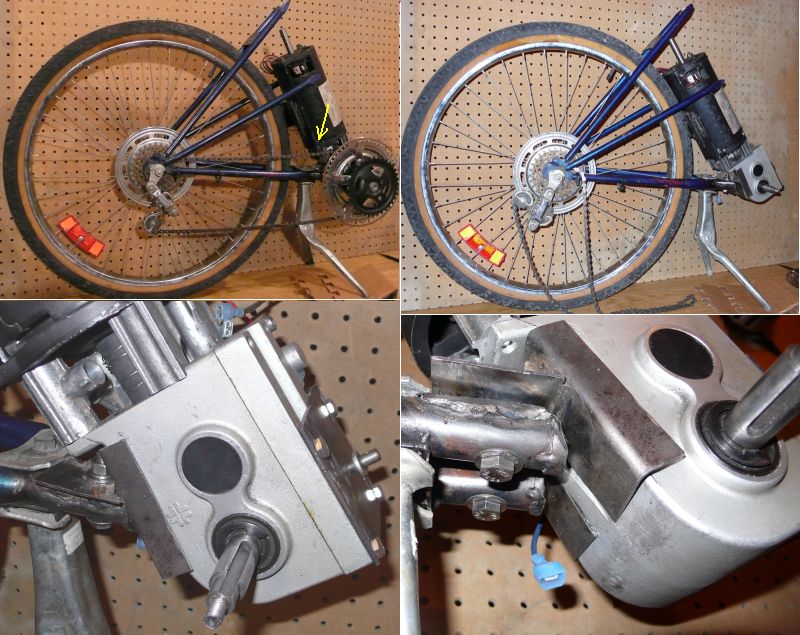

Picked up the powrechair gearbox today.
I pounded the wheel off, am left with a keyed shaft, and a 32:1, 90 degree all-in-one gearbox.

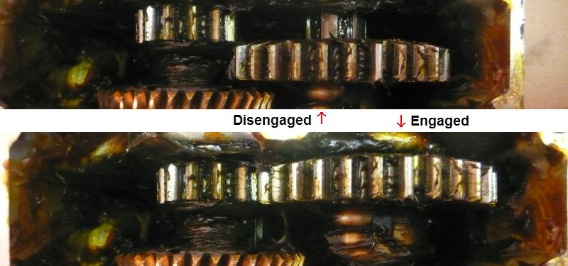

Note it also has that other shaft protrusion on the bottom left there. That is a shaft that bends like a hockey stick about an inch into it. I know it's supposed to have a manual freewheel engage/disengage so you can push it without cranking the motor. I'm not sure how it works, if you pull on it or twist it. I would definitely like to use it though, to disengage the motor when batteries are dead (4000Wh and 1000km range at 25km/h probably never, but..).
Anyone familiar with powerchairs?
Other feature: Where the output shaft (long one) comes out, next to it is another rubber plug thing. The opposite side also has this pair, (with both plugged). So 4 options total. I presume both sides is to make the gearbox flippable to the other wheel. But what is the 2nd plug on each side for? The box is literally packed with grease so I can't see anything, would rather not scoop it out without reason. Is it likely to be a two stage geardown and the other position is for using only one set of the geardown?
At full open throttle I'm at 4200 RPM (170V) off the motor, so, at 32:1 geardown, that's 131.25 rpm on the drive sprocket.
Ideally, I want 200-600 RPM on the rear wheel using the rear sprockets (25-75km/h, 15-45 mph).
So, I should have a drive sprocket that is a ~50% bigger than the largest rear sprocket and it should all match up. Except this is stupid, I'm gearing down to 131 and then gearing back up almost 5x for high speed. Would make more sense to remove one stage of the gearbox, same problem as before.
But, it's at least doable, since I don't have to contend with the extra 2:1 geardown from the prop gearbox. I have chainrings of the appropriate size. If I go 32:1 down and then back up, so be it.

MattsAwesomeStuff wrote:Note it also has that other shaft protrusion on the bottom left there. That is a shaft that bends like a hockey stick about an inch into it. I know it's supposed to have a manual freewheel engage/disengage so you can push it without cranking the motor. I'm not sure how it works, if you pull on it or twist it.
Tha'ts the clutch. Most of them twist. If it has a lockingpin hole in it, just stick a screwdriver or allen wrench in there, and turn it, usually 90 degrees. Sometimes you have to "rock" the output shaft a bit to engage or disengage it.
I used the clutch frequently on CrazyBike2 when I had the "350W" motor on there, but when I switched to the "650W" motor, it's gearbox did not have a clutch. :( So I could not rol the bike backwards hardly at all.
AFAIK it's to access a bearing for installation/removal. Most of these gearbox cases seem to be flippable, but the parts inside may not all be--some seem to be made specifically for left or right operation. Even the lid can be used either way--you just drill out the other "cap" for the clutch rod and cap off the first..
That's what I did on CrazyBike2; the only issue I had was the massive torque capability at the low speed, which could and did destroy about any bike parts that were misaligned, espeically since it had the power to twist the frame. :(

Scooped out the grease for a look-see.
1 - From the motor coupler shaft, a loosely toothed worm gear.
2 - A saddle/helical cut gear on a jackshaft, meshing with the worm gear at 90 degrees (not sure of tooth count, but 12x).
3 - A small (12) spur gear on the same jackshaft.
4 - A large (32) spur gear on the drive/wheel shaft.
5 - A spring on the driveshaft to hold the large spur at the edge of the box so that it connects to the small spur gear.
6 - A hockey-stick lever that can shove the large spur gear so that it compresses the spring and disengages from the small spur, when twisted from outside the case. (Amberwolf was right)
Notes:
A - The freewheeling action is best for when you want to disengage the motor from turning the wheels, not the reverse. While either way holds the gears apart, if the wheels are moving it will scrape the lever against the large spur as it rotates, whereas with the reverse, the small spur rotates freely in the air with no scraping. (Crappy for me, I want the reverse, so I can pedal when the batteries are dead without cranking over the motor).
B - There's no such thing as moving the driveshaft up to the jackshaft, at least not without changing everything else out. The large pinion is incompatible with the worm. The shafts themselves are different sizes (drive shaft is larger). The rubber plugs are just there to serve as end caps.
C - Unlike most worm gears (like the one Amberwolf mentions that couldn't go backwards) this one does not lock up when the helical gear tries to turn the worm. The angle is sufficiently steep that they mesh without locking. But it's not easy.
D - Overall geardown is 32:1. Most of the geardown occurs on the worm (12x) stage. The remaining (32:12 or ~2.66x) is in the spurs.
32:1 isn't great but is workable. 12:1 total is ideal for me. In a perfect world I would use the jackshaft as my output shaft and skip the spur pair altogether (since the freewheel is only emergency-usable in reverse anyway). But it's cut off flush. So, I need to gear back down by ~50%. I'll muck around with it a bit more before deciding.

MattsAwesomeStuff wrote:Scooped out the grease for a look-see.
You can also see the insides of another type over at my http://electricle.blogspot.com if you're interested enough to find the post with the pics. But I dont' remember the title of the post or exactly when it was. Should be tagged with motor or something like that.
The clutch is actually designed for "freewheeling" the output shaft, so that a helper can push the chair around without overcoming the motor and gearbox reduction drag (which is quite a lot).
So it can do what you want, but there will still be drag on the system.
What would be better is to use a freewheel on the output shaft of the motor. Take the threaded part of an old rear bike hub or a threaded bottom bracket cup, and weld *that* to the ex-wheel hub, and thread a freewheel onto that. Then just use the motor in the direction that allows the freewheel to drive from the motor but just spin with the pedals.

Postby MattsAwesomeStuff » Tue Jun 19, 2012 12:38 am
Well, I went searching/reading for a couple hours. Interesting stuff but didn't find any disassembled pics of your gearbox.
Well, I'm no concerned with the drag as I am the abrasion wear (and the ensuing particulates) from the large spur gear scraping on the lever for miles on end. In a wheelchair scenario, it's meant for a little bit of walking only, not miles.
Yeah, but I was looking forward to the simplicity of it already being done. I have those two expensive overrunning clutches to use, but no way to replace them.
Oh, locking up the helical wasn't the problem--just that the force necessary to reverse turn the motor via the reduction gearing thru all the bike's gearing too was so high that it was beyond hard to move the bike backwards
Well, I can twist the shaft with my hand, so, throw a gear on there I should be able to move it even easier. I guess my angle is pretty slouch.

Postby MattsAwesomeStuff » Wed Jun 20, 2012 5:50 am
Ah; I wonder if there is a fix for that. Perhaps a pin in the casing (outside if possible) that prevents the lever from flipping all the way over to the spur gear, yet still fully disengages the clutch?
Hrm. One of three things: I'm misunderstanding you, I'm misunderstanding how the mechanism works, or you're misunderstanding how the mechanism works.
The lever is bent. When you rotate it, the bottom part swings out and makes contact with the spur gear, which is held where it is by a spring. If you keep twisting the lever, the bent part shoves the gear back, compressing the spring mounted on the shaft. This eventually moves it far enough to disengage from the other spur.
If at any time the lever is removed, the spring shoves the gear back to the end of its travel, re-engaging it.
So, the lever has to remain in contact (with moderate pressure too) of the large spur gear. If that gear rotates, it will scrape along the lever.
So, I don't understand where a pin could go.

Another month, another lack of progress. Bit the bullet and got to work tonight.
Some progress:
Up top is the old wheelchair wheel hub (thanks again Amberwolf for the fantastic suggestion to re-use it!). I need to fit two things on that shaft, so I spent a half hour hacksawing an inch off the outside so only 1/4" is left. I'll trim the other side later.
I also drilled around the old crank, dremeled, chiseled, until I got the chainrings off the crank. A bunch of filing and it fits onto the wheelchair hub.
Bonus, both are 5-spoked and the holes line up perfectly.
And they fit nicely back on the gearbox.
Bolting is nice because if I pretzel up the chainrings or go with a different motor or want to gear it for different speeds later, I can just unbolt it again.
Next, I have to mount one of my overrunning clutches to the same shaft. One would require the shaft to be built up, the other lathed down. Annoyingly, the difference is enough that it would bite into the shaft key, so that makes things a bit complicated.
Sort of a milestone, it's the first time any parts have been assembled together since I started the teardown.

Postby amberwolf » Wed Aug 22, 2012 11:58 pm
If you look at my CrazyBike2's old powerchair drivetrain, you'll see that I spread the center frame stays out and welded a plate across them, then drilled slotted holes in the plate for the powerchair gearbox to bolt to with it's six mounting bolts, using large washers under the boltheads to the plate for extra friction so I could loosen them, adjust chain tension, then tighten them to keep it from slipping around.
So depending on what your bike's design is going to be, you could do the same thing.
Alternately, if your frame tubing is small enough diameter to fit into the powerchair gearbox lid's tubing indentation, you could use that plus a mounting plate off another gearbox to make a pinch-clamp, with six long bolts between them, and mount the whole thing on the downtube--but that would make a mess of the chainline unless it's the downtube of a rear frame that is then bolted or welded to the stays of a front frame you'd actually be riding on (similar to the way my CrazyBike2 has been built, or more like the way Dogman's FS Longtail is made).

Postby MattsAwesomeStuff » Thu Aug 23, 2012 3:03 am
Y'know, one thing you never did was amalgamate all your info in one place, in a concise but thorough way. I find all of your stuff quite interesting, and you and I line up very similarly in terms of "make it work", "do it cheap", and "be resourceful", but it's spread so far and so thin it's hard to find any specific thing. I wish I was around while you were building it, archiving is not so great on forums/blogs. Of course, doing this takes time and has little benefit, so, not being critical, just wishful thinking.
Good to hear, that was my plan too. I hadn't thought of slotted holes. Thanks, I'll probably incorporate that.
I don't have multiple gearboxes, (wouldn't ruin one just for the lid anyway) but I can make a plate easy enough. The downtube will be behind the seat but it's on the wrong side. The gearbox cup has to face forward. I'm not sure if I'll even include the downtube at all or just create a mounting frame directly from the stays to the motor/gb assembly. The main tube will just be 1.5" box steel to the front fork.
I think I like the plate idea better though.
Thanks again for the feedback. Half the time you confirm my ideas as serviceable, the other half of the time you can tell me the better and easier way. :)

Progress is slow. Getting demoralized 'cause I won't have it done before the frost line hits.

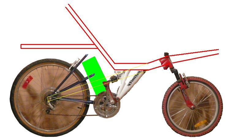

Made another rough sketch of where stuff has to go:
And since then worked on fabricating a way to mount the gearbox (aluminum, no mounting points and not thick enough to tap) to the rear frame:
The brackets will be JB Weld epoxied to the gearbox. I welded a mounting plate onto the chainstays that bolts through the mounting plate for the gearbox brackets.
I also cut, welded, and drilled the mounting plate for the pivots to attach to, and ground away a clearance hole for the clutch lever.
Around this time I noticed the mother of fails. Note the yellow arrow. The chainline does not clear the motor. In the small chainring and smallest casette it clears barely, but nothing clears on the big chainring and only a few gears clear on the small one. That means I'll need to have a power-side redirection pulley/sprocket right next to the chainrings. ARG. Unnecessary stupidity.
Next up is mounting the pivot to the gearbox plate (it needs to mount right inside the clutch lever, wonderful)... and figuring out mounting arrangements for the top and middle of the motor to the old seat stays.

Postby amberwolf » Tue Sep 25, 2012 1:54 am
you may be able to simply use a plastic tube over the chain to redirect it around the motor. Attach the tube to the side of the motor so it doesn't drive around. HDPE or similar should work well, and it will probably be quieter than a sprocket to do it. It's common enough on various recumbents.
