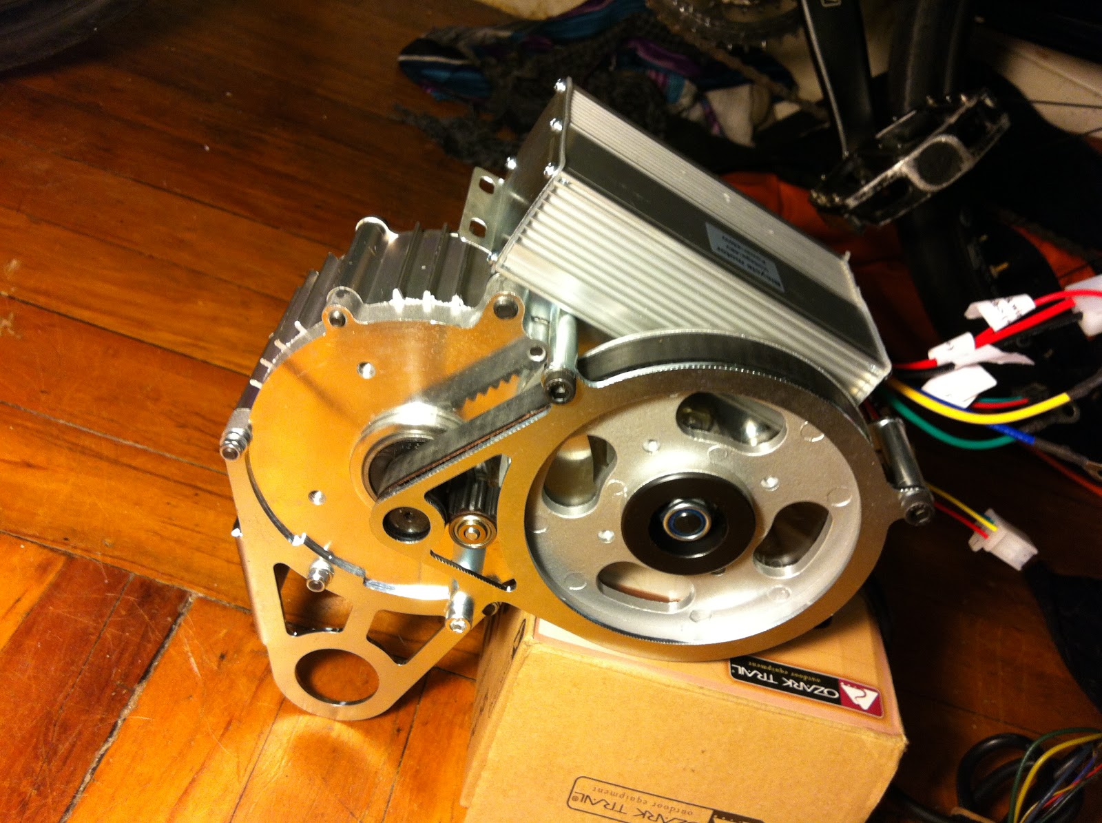

With no shop space and no options for getting any in the near future I thought I might have a go with something a little less custom and a whole lot less power. Seeing all the really cool GNG builds has inspired me to go the same direction, so I kept a keen eye on CL for a decent full suspension bike and sure enough a 2004 KHS FXT comp turned up in providence for $325 so I jumped on it. Since then I have spent most of the time mocking up a nifty battery enclosure and what I came up with was something big enough to throw in 15ah@48v worth of makita cells I bought from the good doctor.
I'm thinking aluminum for the enclosure that will be strapped on so it will be easy to remove and charge/store indoors.
I'm also looking to mount the controller almost directly the the gng bracket so I can keep the front fender and easily cover all the components that would not prefer to be covered with water, salt and mud.

It was just going to be too cramped in the frame of the KHS for all that battery, so I took a page from the 'ol 4X4 PVC fencepost playbook and put the battery case over the top tube.
I used a chunk of the 6X6 fencepost to craft a nifty motor cover that doubles as a controller mount and protector. This really made it plain how easy this material is to work with, all you really need is a dremel and a heat gun and you're good.
this thing is ready to go for the most part, it is all wired up and only needs a battery to make it go. Let's just say I'm getting what I can only assume is the usual lessons one learns with their first foray into the wide world of DIY cell salvage and pack building.
