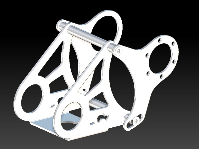

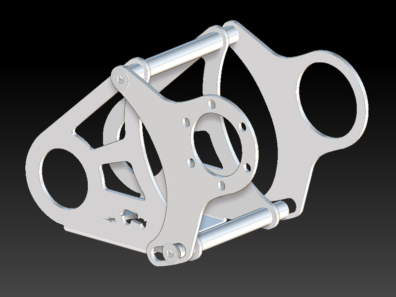

I've had several people PM me asking for adjustable sheets for the Gen 2. I finally had a customer that wanted a commuter bike and I'm building a Gen 2 for them. The sheets are being fabricated now and will be available in a couple of weeks. They're made from the same high quality American 12 gauge steel as my Gen 1 sheets and have more metal in key areas, especially around the BB where the GNG sheets are weak. I also designed an alternator type swing mount for chain adjustment. This will get rid of the wimpy red wheel tensioner.
PM me if you're interested in a set of these. The initial run should be back from the laser cutter in one to two weeks and then another week to ten days for electroplating.

This bracket set, and adding oil-cooling with a temp sensor...will make the Gen-2 (using 36V) one of my most recommended commuter kits. As to possible competing kits, there is a lot of buzz right now about Bafangs new BBS01 BB-drive, which is aimed at countries with low power restrictions in Europe and Asia. It is clearly designed for mass-production in order to compete against the high-quality (but expensive) Panasonic and Bosch BB-drives.
http://endless-sphere.com/forums/viewtopic.php?f=28&t=50104
I think the BBS01 has a bright future, but it simply doesn't have the copper mass of the GNG-Gen2. The BBS01 has two power ratings, 250W and 350W. Although ride reports about the 350W here on ES are good, The North American market is allowed to legally use 500W in Canada and 750W in the US. A true continuous 750W might be too much heat for the 350W BBS01, but that remains to be seen.
The Gen-2 is advertised as using 48V, but the tiny drive-cog is simply too small (engineering wise), and even using the stock chainrings at 48V, the rider may not be able to add pedaling to ease the load on the motor (or extend the battery pack range). Clearly the motor will work at 48V, but the higher RPMs make it a scooter, instead of something that you can pedal along with (if that's important to you).
If the motor was available in several windings, a slow turn-count motor would be a great option for those that want to use 48V. However, with the existing motor, I would be comfortable selling these to friends using 36V and a continuous 25A, which would be 36V X 25A = 900W.
The flexy and weak stock bracket was slightly reinforced by the factory recently in the newest versions, yet they are still clearly just an "adequate" solution to a kit with a lot of untapped potential. These new brackets by LightningRods are extra strong for only a small weight penalty, and based on recent past customer service reports and actual production build quality, I can recommend this bracket set without hesitation.

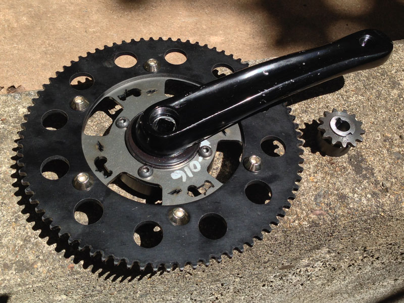

I've been working for weeks developing a #219 secondary drive for the Gen 1 kits. I designed a 3/4" to 11mm adapter so that I could fit a 12 tooth 219 driver on the secondary. I also designed a freewheel to 5 1/4" kart sprocket adapter plate. The 3/4" to 11mm will work with 12T, 13T and 14T 219 sprockets with a 3/4" bore. There is a HUGE range of kart sprockets available from 65T to 93T. A 75T is almost identical in diameter to a 48T 1/2" chain sprocket. The difference is the .3" link pitch. Because of the quality and side plate thickness of good Japanese and German 219 chain they are good up to 15+ horsepower. More than enough for the GNG.

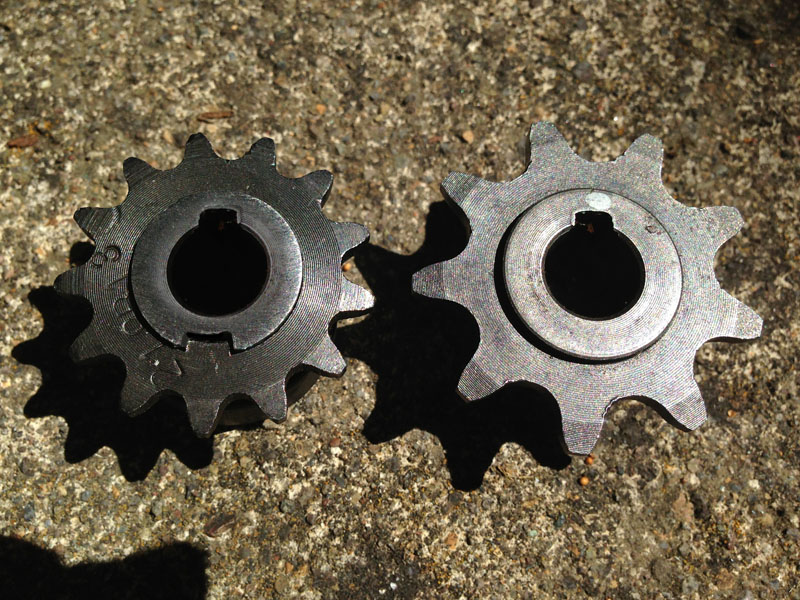

My 219 adapters with sprockets:
Just by coincidence these parts will also work on the Gen 2. The Gen 2 driver also uses an 11mm keyed bore.
The stock Gen 2 driver is on the right.
You can see the difference between the pitch of 1/2" and .3" 219. Even with more teeth on the driver (12T is a good minimum anyway for decent chain life) you can more than make up for it on the driven side. I'm going to use 12/80 for 6.66:1 on my own bike. You can make the gearing on your Gen 2 pretty much anything you want by mixing drivers and driven sprockets.

The increased reduction provided with this #219 chain set means to me that 48V (and the increased RPMs that result) would finally be a good option. I would still limit the amps on a Gen-2 to 25A because of the poor heat-shedding (the Gen-1 has excellent heat-shedding in stock form), but...if someone was willing to experiment with oil-cooling I may revise that amp-cap recommendation in the future, dependent on the results.

It was pointed out to me that the early Gen 2s had a different motor mount than the one I just bought. The current one connects to the center section of the motor near the sprocket and motor shaft. The early Gen 2s had a large ring that attached to the perimeter of the motor case. Since I have a couple of customers with early Gen 2s wanting adjustable sheets and the new style bracket won't fit the older motors, I designed an adjustable motor section that connects to the same BB bracket. Both styles of Gen 2 sheets should be available by mid August.
Oil cooling huh? Sounds like fun...

I picked up the adjustable sheets for the Gen 2 from the laser cutter today. The quality of the cuts are the best I've seen. These are pretty mounts. I need to countersink some screw holes in the shop and then off to the metal plater.

My adjustable sheets for the Gen 2 are back from the plater and ready to ship. They have a simple alternator style swing/slide adjuster and better quality steel than the stock sheets. I've also beefed up areas that I felt were weak in the stock design. I have both the new center mount motor brackets and the original rim mount motor brackets. These sheets eliminate the cheesy red plastic tensioner wheel. PM me if you would like a set.

bryn wrote:New build using the 400w Gen 2 , using the Nuvinci Harmony auto shift hub. 29er Tomac flint frame and a few other nice little bits.
Weve been pottering around with this build for a while, ordering little bit as we went. Its designed for major offroad use and
has proven itsself to be a real hill climber. Were running it on a 48v 16.8ah lithium ion battery from QB Bikes in Spain,(nice and light!! and lasts forever)
Were just running stock controller as the power is ample for steady hill climbs not wasting too much battery power in doing so.
We opted to get a 13tooth sprocket made for the motor to engague more teeth. And put a smaller chain wheel 22teeth on the primary side. The stock freewheel from the chain wheel crank set up, has been changed for a GT 120 click one, a lot stronger.
We stayed standard 38t on the chain wheel secondary side delivering power to the 22 tooth on the Nuvinci Harmony.
Lovely set up.
