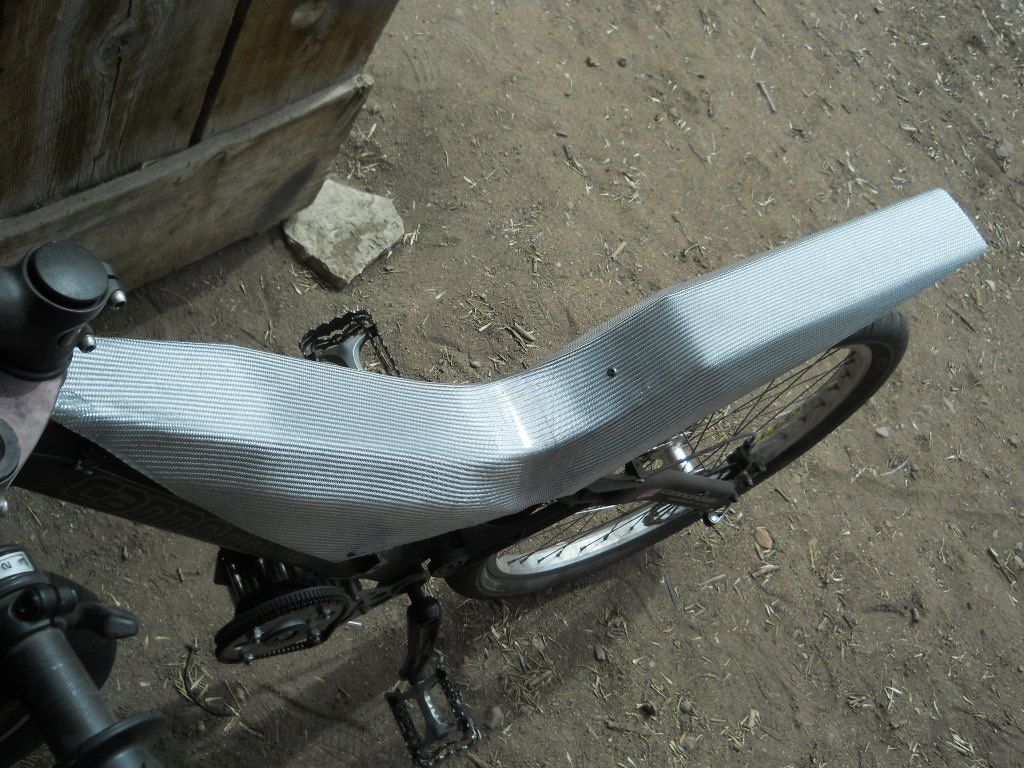

Due to boredom more than anything else I ordered another GNG kit and put a Cannondale super V frame into a roller with a Lefty fork. Let the butchery begin !
First thing to do is cut off the seat pedestal.
Then start building the fiberglass seat/tank/fender and battery tray, the idea this time is to make easy access to the electronics, the first bike requires some dissasembly to get to the battery and electronics, this one will have the entire fender assembly come off with just a couple fasteners.
So thats as far as I've got in two days

Today I finalized the position of the bodywork , got things trimmed up and mounted, Color scheme still eludes me, I'm thinking dark greyish silver for the bodywork with some carbon fiber accents, I just dont know :| , hoping batteries will arrive tommorow so I can figure out the electronics arraingment. motor wont get here till next week.

I've been a bit slack with this build but have made some progress, electronics are mounted and I finaly got the magura throttle to work well, the motor required a bit of frame clearancing to fit properly due to the huge down tube and the setback bottom bracket but it worked out fine and the bodywork is mounted with just 3 fasteners for easy access, one big bummer is that I had a nice piece of carbon/kevlar in yellow and black weave which I intended to do the bodywork with and left it out when we went for an afternoon of duck hunting, I guess the dog was pissed that we didnt take her hunting this time so she attempted to eat the kevlar, it is now a useless lump of wadded up material. at least we had duck for dinner.( kinda had thoughts of having dog for dinner !)
Still need to make a chain guide, do the primary chain conversion, finish the bodywork and a bunch of other details, Getting there.

I dont really have anything in the works as far as fiberglass is concerned, the easiest way to create a one-off fiberglass part is to shape it from styrofoam ( which means you must use epoxy resin), then layup several layers of cloth, I find laying out the cloth on plastic sheet and wetting it out with resin using a sqeegie the easiest, this allows you to see that you have fully wet the cloth, then just drape it over the styro mold and sqeegie it into shape working out all air bubbles and getting any excess resin off ( you will be able to feel the weave of the cloth rather than having a shiny surface), you can layup as many layers as you want all at once, for a really rigid part use fibeglass matt between layers of cloth, the cloth allows you to sqeegie the resin thru without distorting the matt, after the resin has setup enough to not be sticky use a razor blade to trim the excess cloth from the mold.
Once cured simply pour gasoline , laquere thinner or acetone on the styrofoam and watch the stryo dissapear, ( disspose of the residue properly), you are left with a part just bigger than the mold by the thickness of the cloth, all thats left to do is final trim the edges , sand and paint or put on a layer of decorative cloth such as carbon fiber, or in the case of this bike I used Texalium and then clearcoat. here is a pic prior to the final sanding , clearcoat and graphics ( which I havnt done yet, still looks pretty good though).
You can also use a hard material for the mold and use mold release like PVA ( polyvinylalcohol ) but you then must have a shape that wont trap the part on the mold which is why styrofoam is easier.
It really is just a matter of getting the materials and making a simple mold to do a test on, you will learn as you go, the above methods turns out a part without using paint brushes and more important, without having to sand the fiberglass itself therefore avoiding the dreaded seven year itch :evil:

That looks incredible! Is it strong enough to sit on or no?
Yep, plenty strong enough.
