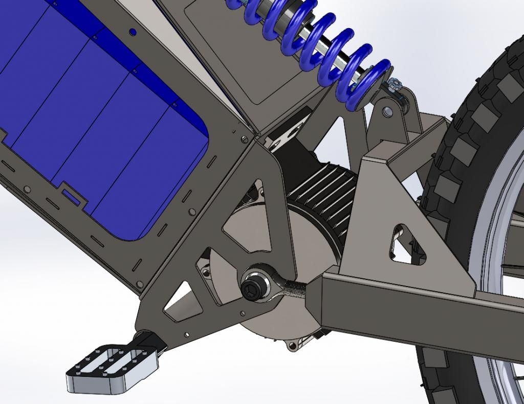

Here is my previous design which I may revert to. Main difference being the motor position is angled down lowering swingarm pivot point and lowering CG. I am also considering designing an all sheet metal frame similar to the Stealth bikes to see if I can come up with something that will work.

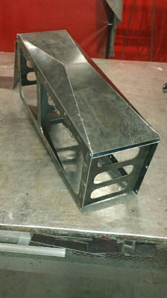

I thought the upper portion of the frame could use a little more bridging and it would make a nice place to put the controller potentially. This also helped move the seating position a little bit further back. I also stuffed it with the 20s 20ah worth of lipo packs to see how it fit.
Any input on what kind of range 20ah might provide in trail conditions?

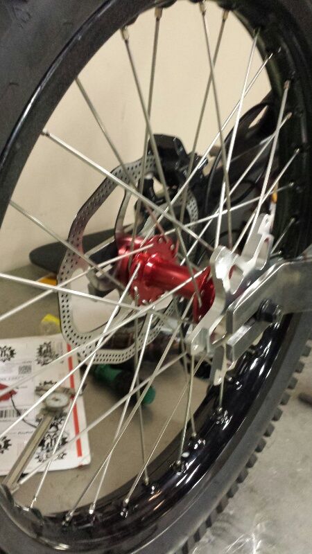

Got the wheels together today. Made some nipple washers on the cnc turret punch yesterday afternoon. Worked out well.

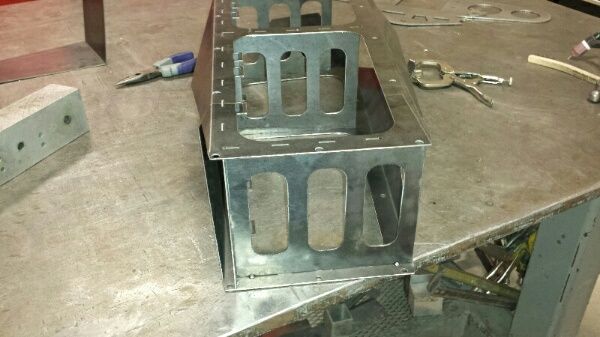

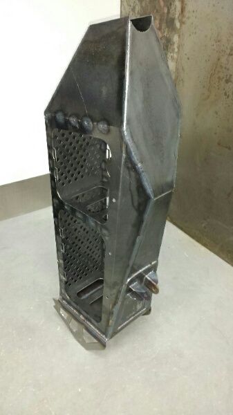

Here is a shot of the sheet metal frame.

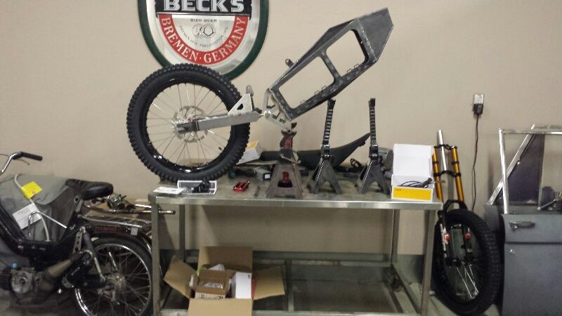

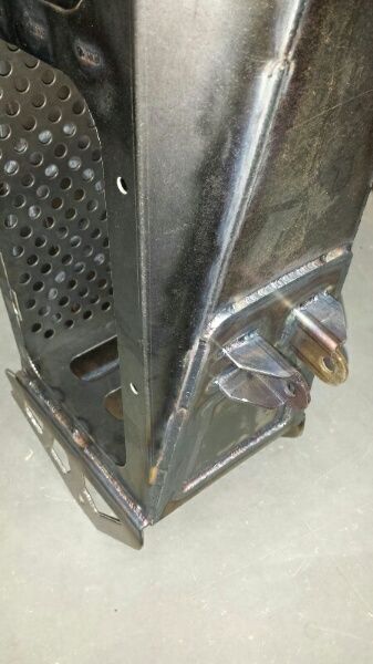

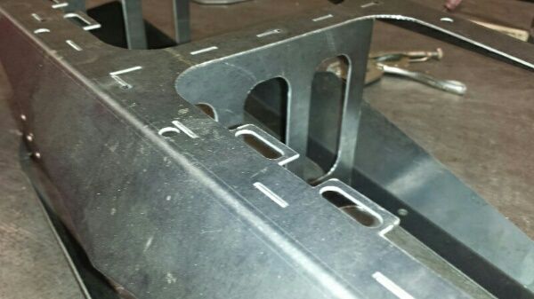

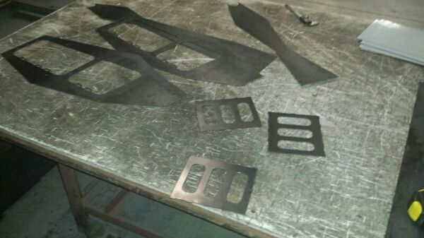

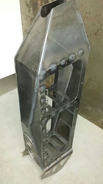

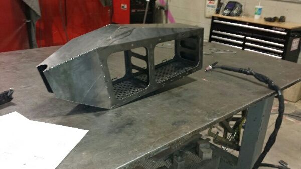

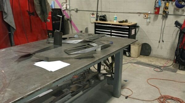

Got most of the sheet metal frame built on Saturday. Punched out the parts, bent them on the press brake and welded them up. Went together smoothly and was fun, I haven't welded in about 4-5 months so that was fun to get some under hood time. Still have to build the swing arm and machine the head tube. Hopefully I will have enough time after work to get some of that done this week.

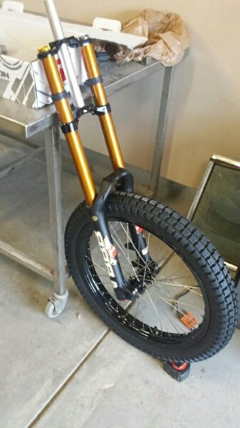

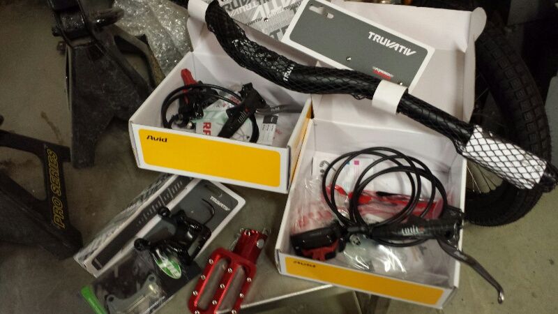

Fork and batteries came in too! Startin to get somewhere finally!
Wow, that's awesome progress for one day!
I know it helps having the high-end tools, and obviously the skills and experience to use them properly, but even so that's impressive.
Keep up the good work!
Dave
Having the design figured out ahead of time saves a lot of time fiddling. Unfortunately the seat mounting will be the part that will require tinkering to get the mounts correct because the seat mounts are too complex to measure accurately so just building to fit is how I will have to deal with that one. I will have to document it though so it is sorted for the next one because now my wife wants me to build one for her.

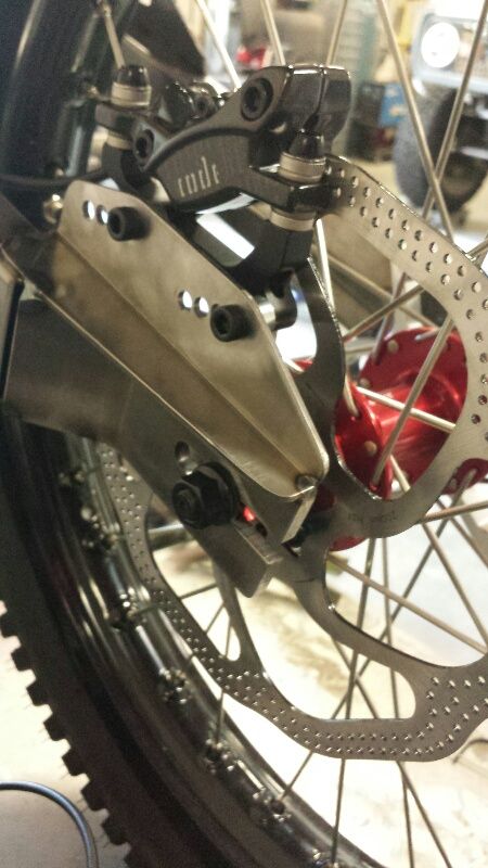

Swing arm tacked up.Caliper mount is sorted. More parts came in. Little more progress made. Ordered the rear shock today along with the sprockets. Getting closer!

bzhwindtalker said:
Is that the OSET 20" hub? could you share some specs? thanks!
Adam
Yeah it is. EP-OSET-HB32H Alloy, anodized red, 12G (spoke dia.) x 32H(spoke QTY) x 3/8"(axle) x 139mm(drop out width) x 180mm(total axle length)
http://osetbikes.com/gb/20-0-parts-2/wheels-and-tyres-2/
I got it from my local Oset dealer who happened to have it in stock. There is the standard 6x44mm disc flange on both sides. The sprocket side flange is about twice as thick as the disc side. Oset sells the sprocket adapter that is on there as well and it adapts to standard kart sprockets. The hub is about $75 US and the sprocket adapter is around $35 US. I used a 18"x1.85" Accel MC wheel on back and a 19"x1.85" Accel MC wheel on front. I used a DMR 20mm thru front hub. Spoke size I ordered from Holmes was 12ga x 210mm for the back and 12ga x 217mm for the front and they fit perfect with concical spoke washers.

Motor will be mounted like this.
I was real close to building a tubular frame but I wanted the option to add a lot of battery for commuting to work and this was gave me more space and a cleaner look. Especially once the side covers are on. I have built a lot of tubular race car chassis and suspension components before and this was something different to try. Truth be told I have built A-arms and trailing arms for desert race cars like this before already too. Most of it came down to battery. I am pretty sure I can get this thing street legal here pretty easily so a good bit of battery will be necessary to make it practical to use. Right now I am limited to you and bhz's experiences to gauge how much battery to use. I built the frame big enough to hold 30ah 20s of hard case Lipo but I am going to start with 20ah 20s. I am hoping that will be enough to get me 40-50 miles of street use and 30 miles of trail use. I can take either the roads home or the trail that runs along side the Rio Grande river to my house. I wanted the option to take either round trip without having to charge at work because I don't want to buy or lug around another charger setup. My total round trip is about about 20 miles on dirt or 16 miles on road but would like the extra juice to play or run errands.
