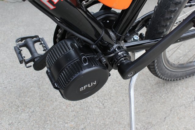

My build page is here with more info, I'll post a quick cut paste summary below. The conversion process took 4 hours, and the cost of conversion was about $600. Internal hub has held up to about 10 test rides from friends, and a weekend of use with my kid on the handle bars.
http://etischer.com/ebike/
On flat ground, at full throttle this bike will run 31.8 MPH without pedaling.
This is the bike I converted. I bought it on Craigslist because it had an 8 speed internal hub which allows you to shift while stopped, and also shift while you pedal. It also has a very clean look, no front or rear derailleurs, and no tensioner. The motor is barely visible behind the crank and main gear.
The motor is a Bafang BBS02 750 Watt, it's a Permanent magnet DC brushless motor, the controller is built into the motor housing, and the gear box uses helical gears so it is almost completely silent. The motor is rated 20 amps at 48 voltes peak.

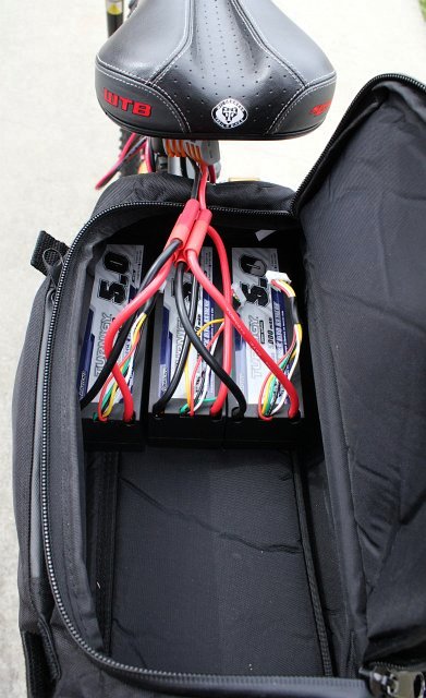

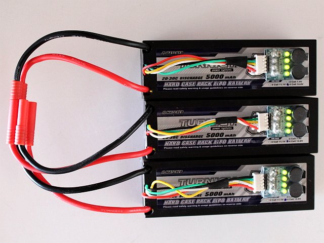

I'm using 3 RC car batteries (4S Lipo) wired in series to get 44VDC, 5Ah. This gives me about 15 minutes of full current, at full throttle (typically just a few seconds of full throttle gets you up to 25mph, then the bike uses less current). Real world experience, I get about 15 miles using the highest pedal assist mode which gives me a cruising speed of 20 mph. Battery cost was $25/each

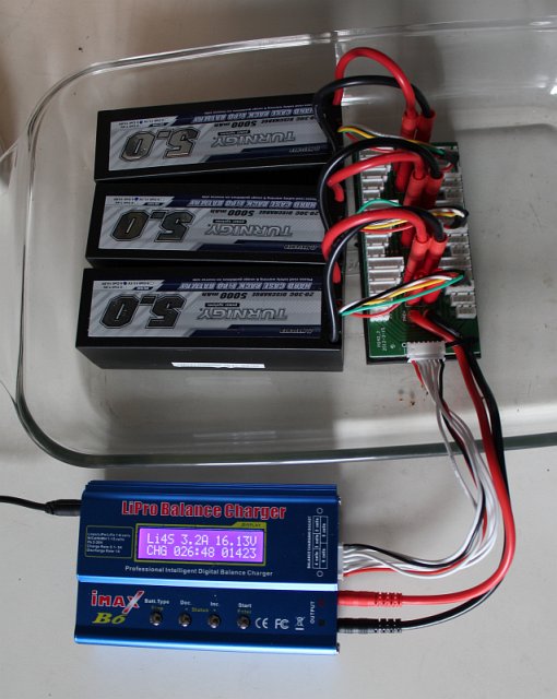

Batteries hooked up in parallel for charging, I can hook up to 6 in parallel and charge at once. The charger I'm using keeps track of how much energy (mAh) has been put into the battery, so I get a feel for how much capacity I have used up.

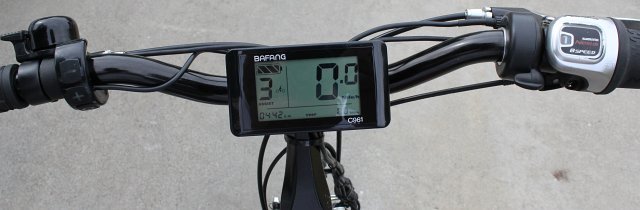

Pedal Assist Mode (PAS) (+) and (-) buttons on the left allow the motor to amplify how hard you pedal. The thumb throttle on the right will let you run the motor at full power without pedaling. The display is back lit at night which is nice. The brake levers that come with the Bafang kit include a brake switch that instantly shuts off the motor.

Do you know what peak amps you are drawing ?
You will be giving those cells a hard time and they will return the favor with shortened life if you ride them hard.
I may be wise to double up the cell count to relax the load a bit.

The cells are rated 20C/30C, so that would be 100A continuous rating (150A for 20 seconds), the motor should be drawing only 20A. Not too worried about the batteries, they don't even get slightly warm even long runs at full throttle. I haven't measured the peak current draw, but I assume it's around 20A, the rating stamped on the motor. Not too concerned about current draw, I have a 5x factor of safety. I kinda like my little pack, it's easy to connect, only 3lbs... so far I haven't used more than 50% capacity on a ride. I'm a bit of a minimalist, I don't want to add weight unless it's necessary =)

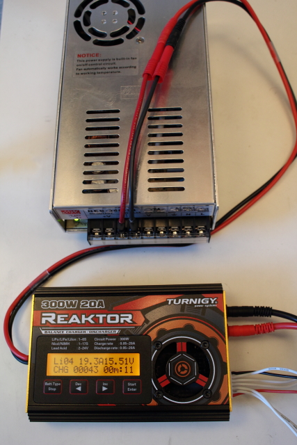

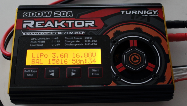

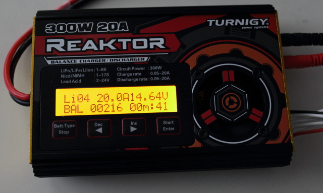

Upgraded my charger, I can now charge at over 19 amps, where my old charger maxed out at 3. Charger was around $60, and 24V power supply was around $60.
My low voltage monitors also arrived today
I've been climbing some super steep hills lately to the point the front wheel was barely touching the ground. Pretty impressive considering the comfort bike gearing.
I did 42 miles today, 36 straight though, then another 6 miles after a charge. Terrain was fairly flat, I tried to maintain 19 mph, using mostly assist 2.
My charger puts a full 20A into the pack.
I'm putting in the full 15,000mAh in 50 minutes.
