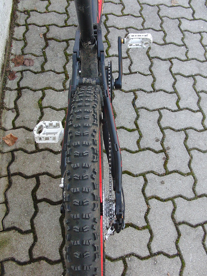

So here's the chainline - the picture form the top doesn't look too bad in the photo but it doesn't do it justice - the one taken from underneath shows it a little more clearly.
Thanks for your pics, thats what I thounght, your chainring is sitting at the outside of the adapter.
My adapter is made so that you put the Chainring on the Inside and have spacers to adjust the chainline the way you just about clear the plastik gearcover with the chainring bolts:
Here is a picture with two spacers liing on the adapter:
Here is my chainline with a 38T one spacer mounted up front:
With a 38T you need to grind a little bit of the nose of the Plastic Cover and get the tidest chainline. A 36T might just about fit if you grind more away or you use two Spacers without grinding.
On your pictrues I allthough seen that there is space between the right chainstay and your motor housing. I would recommend you take out the motor, go to a good bikeshop(check before if the got the tools) and let them mile down the right side of your BB housing by 5mm. (The frame could still be used with some spacers and the stock bb) Your motor is going to be more centered and has a better chainline.
You get at leased another 5mm with a adapter that is made like mine. This way you gain 10mm in the chainline and everything is perfekt :)

Ah, that's a lot of effort to try to use 3 sprockets I don't use. ;) Thanks for the ideas though - maybe I'll take another look at the adapter and see what can be done.

Have a look if you can mount your chainring to the inside of your adapter, if that is to tide, put one washer under each screw and so on untill it fitts. that will improove things and does not cost anything ;)

I pretty sure I tried it to mount the chainring the other way when I was putting it all together but I will check it out again when I have a chance - life and 2 year old kids have a habit of limiting my spare time these days though. ;)
Oh, and if anyone is interested, the Dillinger 4 studded tires I put on have been great - no more falls or even slips even on wet ice. Fantastic purchase even if they cost a silly amount of money for a bit of rubber.
You need to put washers between the adapter and the motor, to get the adapter a little out, then you can fit the chainring on the inside. with one set(5) of washers the chainring will fit, but the chain will rub and grind on the nose of the plastik cover, grind 1,5mm of the nose of the plastik cover and everything will fit.
