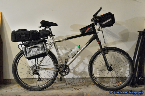

Old Bike being replaced: XL Gary Fisher, 26"

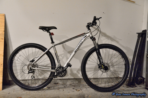

Frankly I didn't give a lot of thought on the base brand/model. My old Gary Fisher 26" had served me well, except it was too tall for me in stop & go situations. I knew I wanted a 29" and I wanted something that fit me better. I looked at several and decided on a HARO Sport 29er. which felt good and was available at my local shop at a good price.
New Bike: HARO Sport 8 speed, 29er:

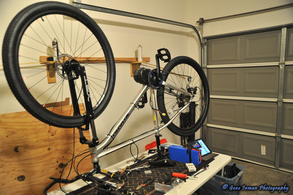

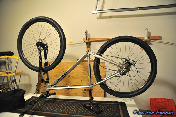

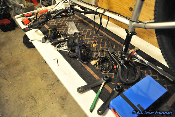

The Kit & Install:
The install was as most readers here on ES would expect, fairly easy, only special tools are those needed to remove the crank & arms. Kit comes with everything you need to get on the road in about an hour (in theory). For the first-time ebike builder, it is a good kit if simple is your goal. Can easily be installed in your kitchen or in the field with minimal tools.
However, I was a bit surprised that the kit came with NO instructions!! I didn't panic because after 2 years researching and lurking on ES, I pretty much knew each step to installing the BBS02 without worry. But for the uninitiated or garage build consumer, not having a single instruction could be intimidating. Now I'm not sure what instructions come with a standard BBS02 system?... if any?? But not including anything except an invoice, is a major CON for HPC. At minimum it should have an inventory list and some basic install instructions!
Also at around $800 for the included 52V battery, at minimum the battery and charger should have instruction on how to charge correctly and such. The kit contained none. Because of which I still have some questions, which I'll get to in my next post.

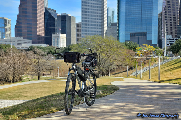

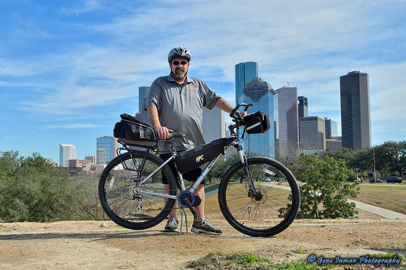

First impressions - Fantastic!
Within 2hrs of starting the build I was zipping around the neighborhood at speeds of +30mph testing the ride.
Stripped of all photo gear & bags the bike's base weight is 26.2 lbs, add the mid drive & battery and the bike weighs just at 43lbs ready to ride. Add 30lbs in photo gear, 10lbs in racks & bags, and a stout 250lb rider, and the whole rig weighs in at about 330lbs !!
With this weight, the bike can easily get up to around 23mph, faster than a fit non-Ebike rider who rides daily. My riding buddy, my wife, has completed the MS150 several times in the top 25%, and my Ebike fully loaded both accelerates and cruises fasted than she can maintain with only mild or no peddling. Perfect!
Using the gears on flat ground, fully loaded, with average peddling, I can get the bike to about 30mph in PAS 4 in about 200meters. Using throttle only it takes about 600meters to get above 30mph on flat ground. Top speed so far has been just above 40mph (slight downhill) throttle only. Way too fast for a aluminum bike with this much weight. But perfect for my needs.
I have stated a log on my test rides and will update as I fine tune riding style and do more range & incline tests, but for the most part it really shines in stop & go (red lights) traffic and hill climbing overpasses, levees, and city trails. My first few rides have been around 12miles with a mix of throttle only, PAS cruising, and various acceleration and climbing test.
