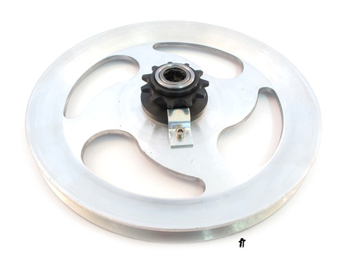

Now on this particular moped, the 41T sprocket is driven by a 14T cog on an 8" v-belt pulley. That pulley is driven by the motor, but here's where it gets interesting.
The motor (on "V" designated models) is fitted with a continuously variable pulley, tensioned by a spring on the motor mount. Like so:

Also, I ordered a better driven pulley, should see it next week:
I hear what you're saying about the loss in efficiency. That IS a concern, and should be looked into. I wonder if there's another way to change gears before the rear hub? Anyway...
