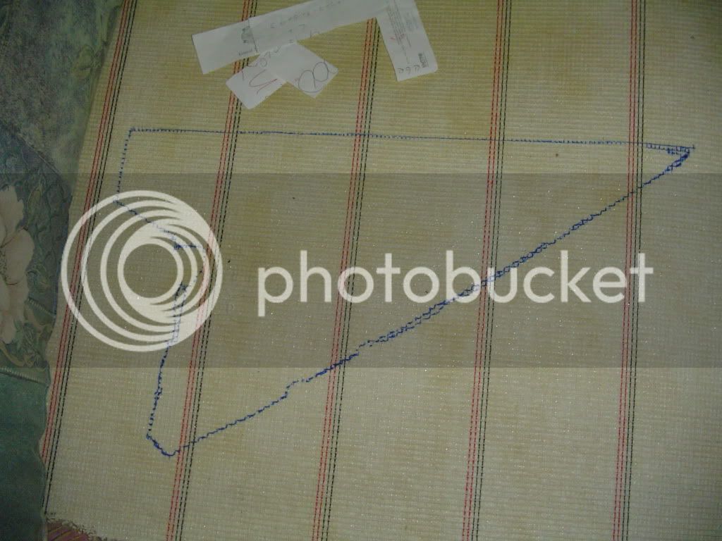

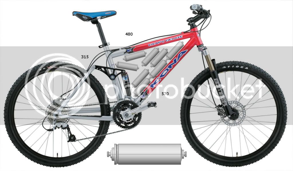

My kahuna has quite a decent sized triangle, and using my mildly primitive cad software I've worked out I can get a 20s pack on and below the triangle without too much difficulty. The width will depend on the number I go in parallel. I'd love a 20s10p, but might need to settle for a 20s8p.

If you go 20s8p, based on 18650 cell dimension, you may be able to fit it into the triangle, but it depends on your frame size. I am doing a similar project, but it is not clear how our bikes compare in size. My "CAD work" is based on simple scaled photos and Visio drawings, but it works OK. I can fit 20s8p into my triangle with no sweat, or 24s8p with no margin. My frame is a Raleigh Ram XT 2500, which is similar in configuration to the Kona (here is the catalog shot):

wanders wrote:If you go 20s8p, based on 18650 cell dimension, you may be able to fit it into the triangle, but it depends on your frame size. I am doing a similar project, but it is not clear how our bikes compare in size. My "CAD work" is based on simple scaled photos and Visio drawings, but it works OK. I can fit 20s8p into my triangle with no sweat, or 24s8p with no margin. My frame is a Raleigh Ram XT 2500, which is similar in configuration to the Kona (here is the catalog shot):
BTW, doctorbass has an excellent thread on building LiMn packs which is germane to this discussion.
Nice looking bike Wanders, it does seem similar. I measured my triangle, it's roughly 48cm x 31.5cm x 57cm. It's a medium. I'm sure I could get 20s into it with clever packing. How are you planning on mounting the batteries. I'm looking at building a plastic box and using some stainless steel zip ties to keep it on the frame.
I think I'm going to go a different route to what doctorbass went with his pack. I'll most likely be using the white inserts from the makita packs, and then keep the twenty 10 cell packs individually packed into their own pigeon holes. If this is a bad idea would someone let me know.

patrickza wrote:How are you planning on mounting the batteries?
I'm going to build a custom fiberglass box that will fit in the triangle to hold batteries, BMX/LVC and hopefully controller as well, although I will probably mount the controller on the outside in the breeze to cool it. I'll use a foam mold covered in waxed packing tape. This fiberglass technique is well documented elsewhere on the web, though I will also do a photo document for ES.

Thats a good looking doner bike. I'm running a Kona Stinky Myself, which is the same design with beefier componants. the frame isgreat for batteries.
have you considered Lipo over limn? hobbycity.com has some great (read that cheap) deals on RC grade Lipo packs. 4 packs of 18.5v 5ah cells fit easily in a frame bag sold by Ebikes.ca
I'm working on a custom bag like the one you drew out ...wait, almost exactly like ... have you been spying? :twisted:
Seriously though, I'm putting together a hard framed bag, it will be bolted and strapped on, and hold the cells ridged, but have cloth sides for stealth. I should be able to get 720 watts of battery in there with room for spares, tools, and the occasinal sandwich.

I have decided to go for 24s1p headway cells for now. The konions are taking forever to come in and I'm keen to get moving so I've ordered the headways for now. 72v10ah should hopefully get me the 20 miles I need for my commute.
I've also received my 5305 with disc brake, 72v48a 18 mosfet digital controller (apparently with fake 4110s) and a split grip throttle. My cycle analyst is on order.
It's getting closer and I'm getting more excited, but I'll have to keep things under control until I have everything I need. I'm hoping to do a triangle mount for the headways. If I use 3mm abs for my case it'll be very close, so I just hope I can make it work. This is how I hope it will fit:
As you can see it'llbe very close. The triangle will have a frame, and each 3 cell group will be in individual pigeon holes with either silicon or hot glue (any opinions on those?) to keep things steady. Case width should be 12cm, and I've tested pedaling with a cardboard cutout and I just seem to clear it.
