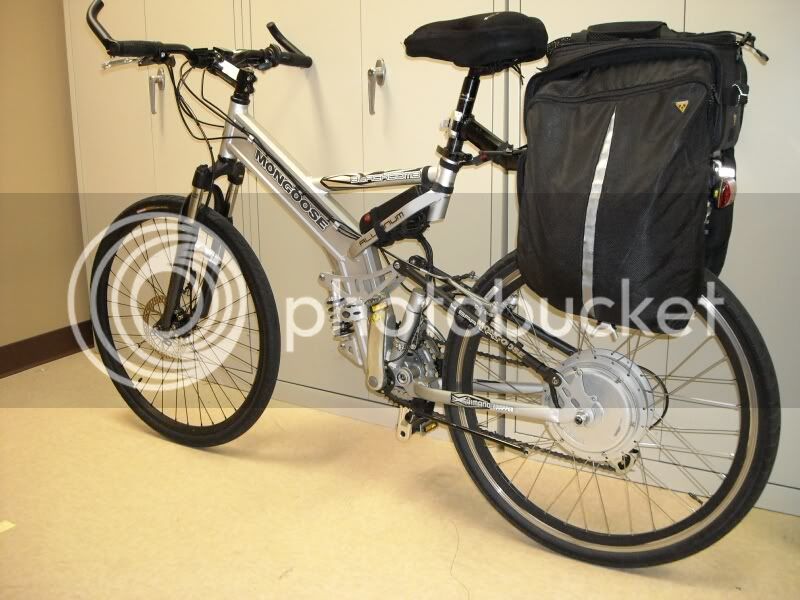

There is still something that i need to solve about full suspension bike rack.
Most of them are rated 10 kg and some are 15kg (I mean the seat post model)
Butthey are generally made of aluminium. and when we put let say a 48V 15Ah lifepo4 battery on it that weight around 17lbs + the charger 4 lbs + the bag 2 lbs that weight become more like 23lbs load
I still think this is borderline eventhough it is rated 30lbs.
The movement of the bike with every shock due to many crack or put holes on the road often create violent movemebnt on the seatpost and the battery mass may add stress because it just can't follow that fast movement of the bike frame via the seatpost.
I broked 3 rack tube rack from now and i NEVER overloaded them
(never carried more than the max recommended load).
R.I.P. seatpost rack:
-Topeak 25 lbs rated price 49$ …..load was 22lbs
-Voyager 25lbs rated… load was 15lbs
-Canadian tire 20lbs rated.. load was 20lbs
Every time the rack broke at the same place: just after the clamp on the seatpost where the rack tube is soldered on.
Aluminum can’t be bended and I think that it’s the multiple shock that created the stress and weaked the rack tube.
Now.. I’m searching for a STRONG seatpost rack.. the best would be to get it made of steel !
Any idea or recommendation?
Thanks for any of your recommandations

battery weight is deff an issue, the static load my not be over weight, but as soon as you hit a bump, the load goes way up, the bigger the bump the higher the load, like maybe double. Ive all ready torn 2 sets of bags do to bumps and 40lbs of batteries, and my rack looks like a pretzel. The recent post using 2in wide Velcro straps was great, (for bag support), just stick them to each other (peel and sticky back)(walmart $7) and it makes a great strap.
I'd double up the tubing somehow, or configure a triangle support in some fashion.

Ur pic doesn't show enough, but you need a brace on the bottom, to make a triangle. Doesn't take much, just enough to spread the load

Are you thinking about just putting the cargo and/or battery load on top of the rack or are you planning to hang them on the sides (possibly in panniers)? If you hang them from the sides you then have to worry about the rack's ability to resist lateral sidesway so that it doesn't get mis-aligned and the load doesn't end up hitting or rubbing against your rear wheel.
I used to have the Topeak Rear Beam Rack with the side panniers. It's rated only for 25 pounds but it held 35 pounds of batteries just fine. The problem was this was a quick release clamp system and no matter how tight I clamped it to the seatpost it would eventually swing sideways and mis-align itself. The rack and cargo would end up rubbing against my rear tire. I think if you're planning to carry that similar kind of load you need to stay away from the quick release clamps and get a rack that you can bolt on tightly.
I put a couple of braces on my seatpost rack, after having one break where it clamps to the post. The braces make a triangle to the bottom of the seat tube so at least half the weight is not cantilevered. That setup has had no problems with a 16 pound ping, and two more nicads for a total of 32 pounds on the rack.58 tooth commuter.jpg
The electrical conduit supports also make a handy attach point for my closed cell foam rear fender. They just attach with a couple bolts through some holes I drilled. I picked out a presumably stronger rack, since it has pannier supports. When riding cross country, I have put about 4 water bottles on a bag on top of the battery box too, another 10 pounds?
All this makes the seat height not adjustable, but nobody but me rides this bike anyway. Got another one for the wife or freinds to ride. It seemed to help with the tail wagging effect too. There are a lot of side to side forces on the rack too.
dogman, can you do a close-up picture of that brace?
I think that's really the best kind of solution. On many bikes there may be an existing bolt hole for the suspension that could be used to anchor the brace, or you could use a second tube clamp.

Ok, back from fun, and here's the pix. It's stupid simple, the way I do things. Just two pieces of steel tube, I had 1/2 inch electrical conduit laying around but anything would do. Angle stock, square tube, old ski poles, even horrors, wood. The angle is very steep, but as long as you form a triangle it's pretty good support, transfering a lot of weight to the bottom of the seat tube on the bike frame. Avoids the bent seat tube issue too.Post rack support 1.jpg
And from the other side, aslo showing a good veiw of the ghetto foam fender.Post rack support 2.jpg
