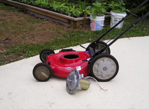

Here's a story from the http://www.builditsolar.com website. Lee has a solar-PV powered shop, and wanted to convert his gasoline lawnmower to electric.
Ended up getting several non-working 120V corded E-mowers very cheap, and added a DC motor. Once he got that working, he figured out how to charge it off of his shop battery. Probably many ways to skin a cat, and this isn't the only way. Might be worth a read...
http://www.builditsolar.com/Projects/Vehicles/LeeMowerCharger.htm#Update2
