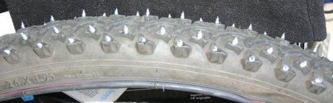

Picked up a pair of Innova studded tires ... cheap ... in July. (ebay)
Cost me about $40 for the pair, including shipping. I wasn't very impressed with design, but hey, couldn't beat the price. Have to give them a try.
First, there are plenty of studs, 1 every 3/4", but I feel they are placed too close to the center. I fear they will wear down from constant abrasion. Ideally they should make only minimal contact on a straight run. That way they will be fresh and sharp on any sort of turn, where they are most needed. Presently, both rows of studs contact, on the straight, any turn lifts one set, effectively halving the, "stud" traction.
Just started snowing yesterday so I winterized one of my EZip Mountain trailz. The studded tires make a very noticeable noise, not sure what to compare it to, but at slow speed it sounds almost identical to microwaved popcorn.
The tires are only 1.75" but that should make them cut through the snow and let the studs cut into the underlying ice. Unfortunately, with no snow, I'm a bit fearful of cornering too fast. I keep thinking about steel studs sliding on cold wet blacktop, ... maybe I'm just paranoid?

Drumroll please, ......... and now, the studded tires, apparently designed to showcase, every flawed design possibility!
attachment.php
What's so wrong about them?
Well, first off, these studs are aluminum! Not only will salt eat them away, quickly, but they will wear away almost immediately on blacktop, even faster on concrete! AAAND! As soon as the studs are worn away, the pan type "stud holders" will let you slide easily, even on the driest roads.
file.php
It appears that they used a fairly large drill, which cut through many of the threads that give the tire its support, strength, reliability, etc. Oops!, looks like it will need about 3 layers of liner, to protect the tube. Yes, the studs, are actually, aluminum pop rivets!
file.php
It seems, someone might, actually be proud of their design!
file.php
I plan on keeping these, as a novelty. But, if anyone dares to claim this to be a good design, I will threaten to sell, to them!

you have the best tire man with carbide but they almost 100$ each here
i just see innova tire are not good on pavement road , they wear very easy because they use regular carbon steel
You're correct about the Innova wearing. Being so close to center, and the studs being of a less durable material, the rear studs have worn nearly flush to the tread. This after only a couple hundred miles of clear road. Possibly the wear was accelerated by the extra weight and extra torque on my rear wheel. The front wheel still has substantial stud protrusion.
I am waiting for the arrival of my 3/8" screws before trying my "homemade" studded tires. Protrusion on inner ribs will be reduced from 1/4", to a more reasonable 1/8". Still, initial trial will be on ice, or at least, accumulated snow. At full pressure, studs will still make heavy contact on level travel. After normal wear, contact should still be reasonable on the straight and substantial on any lean, (turn). Better contact can be supplied with a minor pressure reduction. Re-pressurize for clearer roads ... etc.
