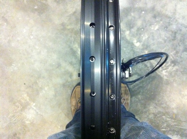

My goal was to build a 30mph commuter for my 23 mile one-way commute. Charging at work is OK. I went with the front hub motor because I wanted the Internal Geared Hub (IGH) in the back. Disc brakes & IGH should be much cleaner in the winter, than rim grime & exposed sprocket teeth. Also, the bike has to fit in my girlfriend's SUV for the morning carpool.
Quick Summary:
Bike: Surly Karate Monkey 29'er (steel, rigid); Schwalbe Big Apple 700x60 (29 x 2.3) tires; Shimano Alfine 8-speed internally geared hub (45:16); Avid BB-7 disc brakes
Motor: BMC V2S Front from Ilia (ebikessf, http://ebikessf.com/)
Controller: Crystalyte Analog from Ilia, with Cycle Analyst & Crystalyte cruise control & Tektro e-brake levers
Controls: Shifter and cruise control on the right, thumb throttle on the left.
Battery: 12S4P LiPo, 20AH, ~900WH. Using (8) Turnigy 6S 5AH packs and GGoodrum's 12S4P BMS & single-plug charge setup.

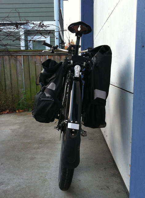

With the current limit set to 20A, it cruises at 28-32mph on the flat in 6th or 7th gear with 45:16 gearing. I only use top gear above 35mph on downhills. I'm using 14-16AH for my ride home (in the mornings I carpool & have a shorter ride). Best of all, my commute time is now 55 minutes, instead of 90-105 minutes. This bike is saving me 45-60 minutes a day round trip!
