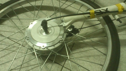

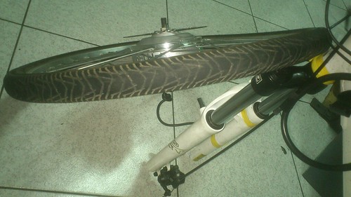

LI-ghtcycle wrote:A friend of mine forgot that both suspension and aluminum front forks are a bad thing with front hub motor and learned the hard way!

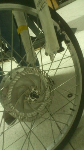

I wish I did read this message a week ago. I started to use 2 years ago a 180W motor on my aluminion fork MTB. After a year a changed to a 250W motor and a week ago to a 500W Bafang BPM (with controller giving ~1500W). I just had 30 seconds to test drive this 3rd motor 500W Bafang BPM!! It just broke the aluminium fork dropouts and luckly it as just after a start so I were at no more than maybe 10km/h.
Right now I am aware of the need of torque arms and already bought a pair and I will use next time (I am still afraid after a week but I am thinking I will go back to this Bafang "monster" motor on the same aluminium fork/bicycle but this time with the torque arms.
My original message:
PUTA MADRE, I almost killed myself!!
I went to make a quick test drive after my mechanic got the motor laced and the brake disk ready. The first thing I verified was that the wheel skidded (and I weight near 100kg). I drove for 60 meters and my mechanic told me after that I went for more than 50km/h, that I were quicker than a motorbike!! He told me that he were afraid.
At the end of the 60 meters I braked and turned back, were I decided to pull the throttle to full and again the wheel skidded and I quick decided to make a small raise the wheel so it could run at full speed and than skid even more when touching in the road, BUT, when the wheel touch the road it instead broke the fork!!! I took a fall, and I am ok but I could be dead for now if this happened when I got high speeds.
http://endless-sphere.com/forums/viewto ... 60#p548462

Glad you lived to tell. Yep, when they snap, they snap...

Building anything powerful with a front hub motor is dangerous, and alu forks are only adding another danger to the list. Build with a rear motor, or build legal power if you really want to go front. We are not on 4 wheels, there is absolutely no advantage to front traction, other than saving the cost of a freewheel.

dogman wrote:Something to think about, whether the motor is front or rear. Say you pop a small jump, the motor starts spinning faster in the air. Then when you land, that's going to be a serious spike of torque.
That was exactly what I did on the only first 30 seconds I had the bicycle with me - I lift a bit the front wheel because it was funny to get it skidding, and when the wheel got to the ground/road, the wheel/motor went ahead and left me and the rest of bicycle to behind :-) -- well, in reality I did jumped over the handlebars.
