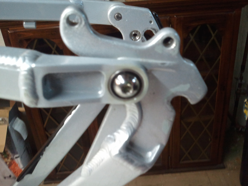

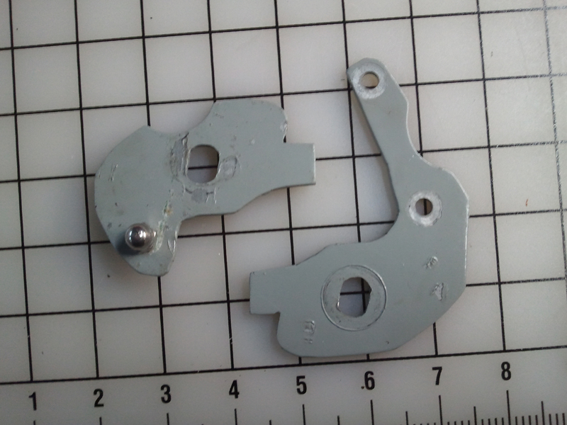

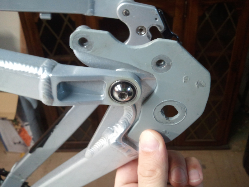

shock wrote:Hello Fellow E-Bikers. So as of today I have embarked on my first ebike build. I've always wanted to build a bike from the frame up so I will slowly be building this bike over winter, starting with an Motobecane frame in XL size. Parts I have ordered so far are the E-biktkit.com rear geared hub, and half grip throttle. Right now things are more in the planning stage, but this thread will serve as a build log. I come from an electronics background, and recently got into brushless motor and LiPo battery R/C helicopter technology. After being astounded in what LiPo and brushless can provide in terms of power, I decided I wanted an electric bike to put around on during the summer months here in Michigan. I've been reading this forum for awhile, about different builds, approaches, wiring, construction, etc. I hope to have this bike running by may 2012. Here are some pics of what I have cooking so far. First one is a pic of the frame I am using as a starting point. Second one is an engineering drawing I am working on for component layout. Black is a fabricated aluminum case, red is controller, blue is Turnigy 6 cell, 5000 mah LiPo packs in a 12c2p arrangement. I'm looking to get 50v at 10mah for pushing the ebike geared hub.
I also want to have a 3 cell LiPo on board for central lighting and Android recharging :)
This bike frame was previously used in an eBike build so it came with nice custom torque arms already built.
Looks like a nice frame mate. mind if we get a look at the torque paltes?

Postby shock » Sun Nov 13, 2011 11:45 pm
@kfong - I am in Harrison Twp, Near Metro Park.
@sn0wchyld - Attached are pics of the steel torque arms
