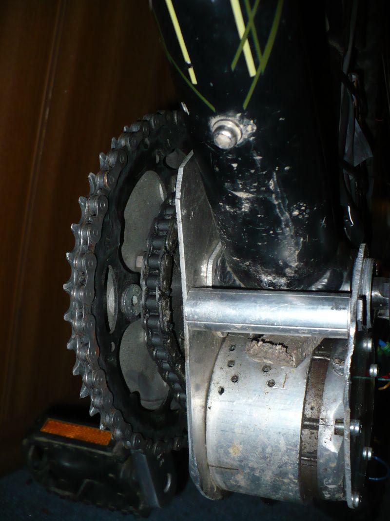

Postby crossbreak » Wed Feb 29, 2012 9:49 am
The mounts bend too much, thats why the chain makes noises and sporadicly jumped off. I fixed this problem by adding 2x20mm aluminium bars between the housing and the bracket to keep the distance when the motor pulls on the chain. It's a kind of a chain tensioner, it's not final, but it now works completely silent, the noise from the wheels is louder :D No cyclist or pedestrian I pass recognizes me first if I don't bell
another bar on the tension side of the chain:
The last problem to solve is the load on the front freewheel. It sometimes stalls, it''s bended to hard. the distance between it and the chain ring is too large (I marked it in the picture below). Another bearing between the shaft and the chainring could take this load (it's also shown in the cad picture below)

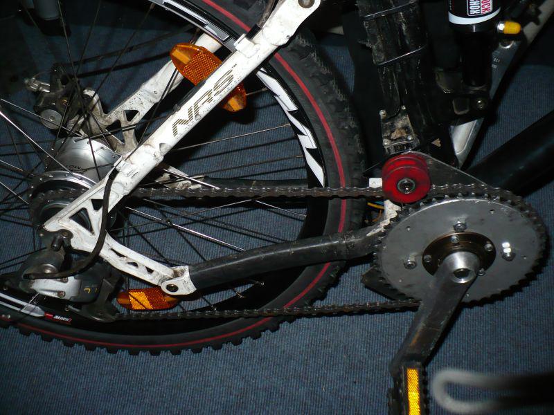

Postby crossbreak » Wed Feb 29, 2012 7:16 pm
here you can see the bearing between the chainring and the bottom bracket that i meant.
The 8mm chain was waste after about 90km :( I'll try a 3/8 x 7/32" chain with 13 to 32T now.
the swing arm isn't where it should, but it shows the principle.

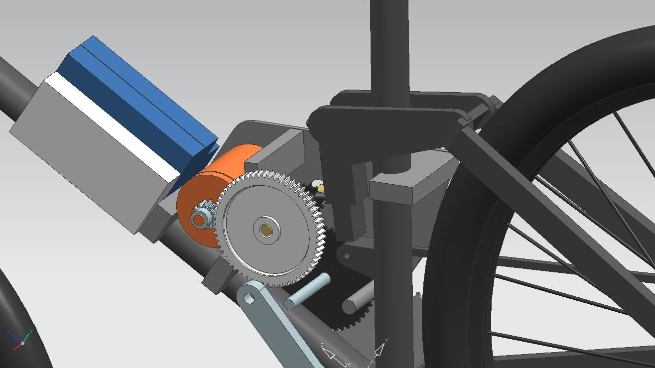

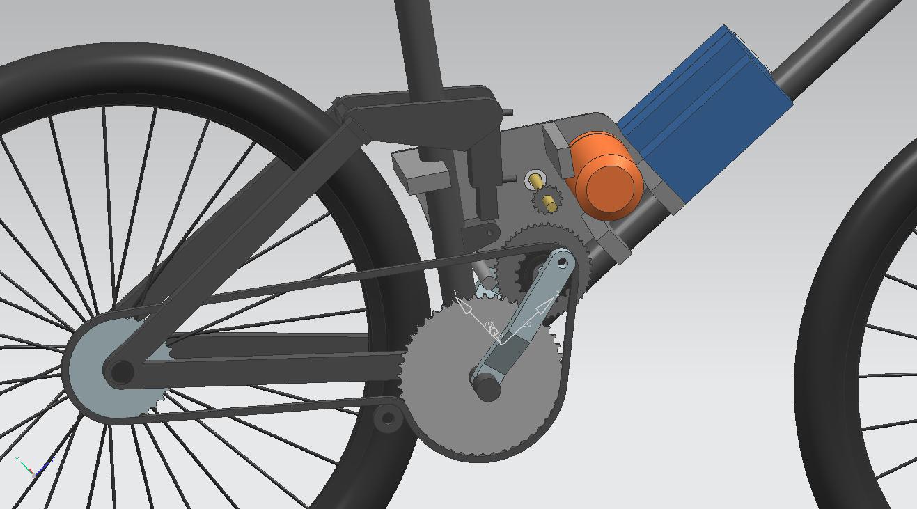

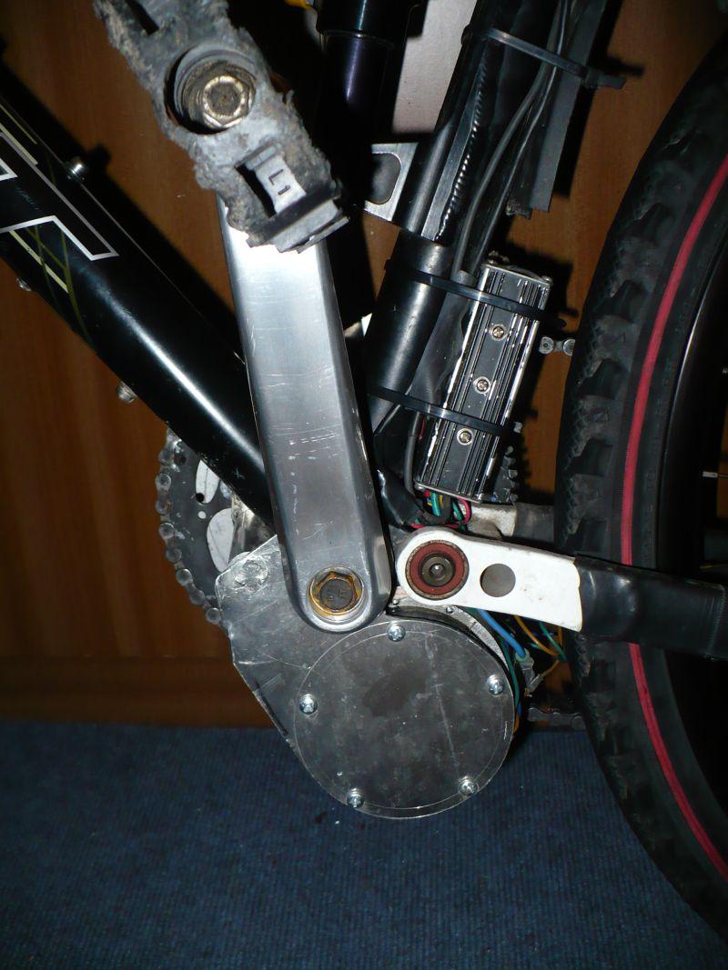

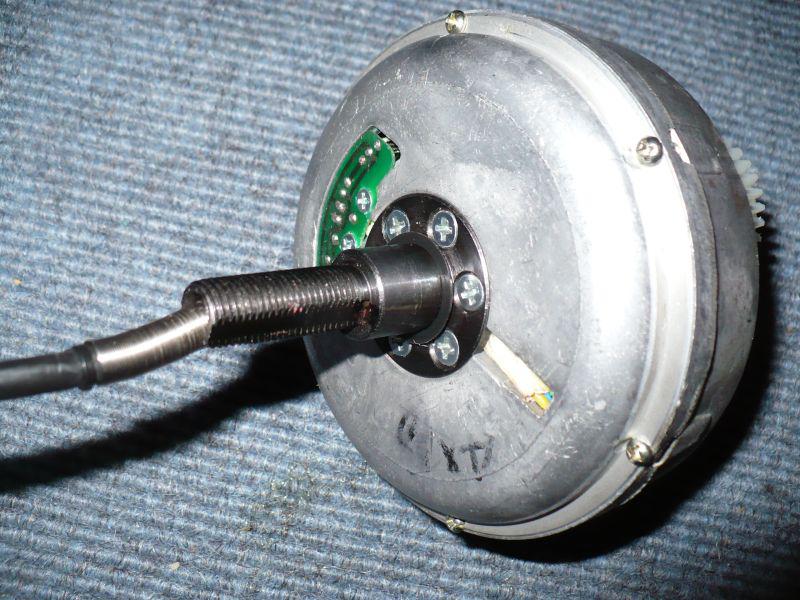

Postby crossbreak » Thu Mar 15, 2012 7:03 am
The chain cracked again due undercharged chain tension. A roller type chain tensioner cannot work good with a short chain.
Also, fastening the motor with it's housing on any frame part radially will always lead to bad alignment. So I decided to directly mount it on the bottom bracket by a 5mm alloy sheet on each side of the bracket. The right sheet will be fastened by the bracket directly, the left sheet by three bushings and screws on the right sheet.
The motor will the be fastened on the right sheet axially by twelve M3 screws. The left side will just have a hole in which the motor fits in.
I decided to use a spiral type chain tensioner now, which varys the distance between bottom bracket and motor axle. I've got one on my motorcycle which works great. Should look like these:
Edit: they are also called " snail cams", as denise told me.
I also shortened the Tongxin by one centimeter:
As you can see all the holes, I tried hard to radially fasten the tongxin with M4 screws and get the chain aligned. It worked so bad I cannot recommend at all. I thought, there are so many on endless-sphere who did it similar, it just has to work. It does but not very long, since it's not stiff enough. The green plastic spacer I made, sucks. It was just a bad idea. When I got the new sheets done ( I ran out of alu alloy :( ) , I will post the plans for everyone whos interested.
Last edited by crossbreak on Tue Jan 08, 2013 1:12 am, edited 1 time in total. View post history.

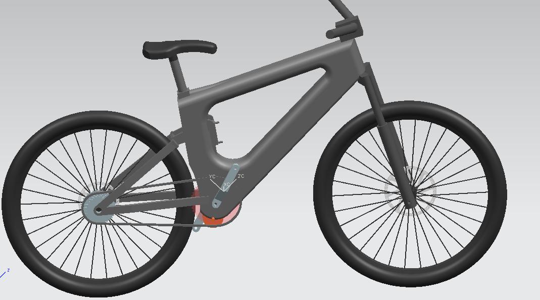

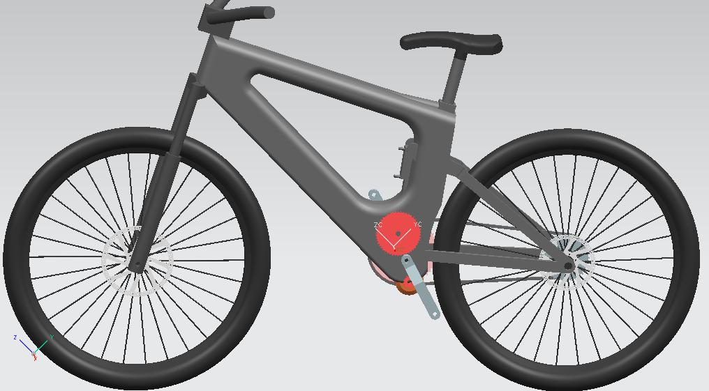

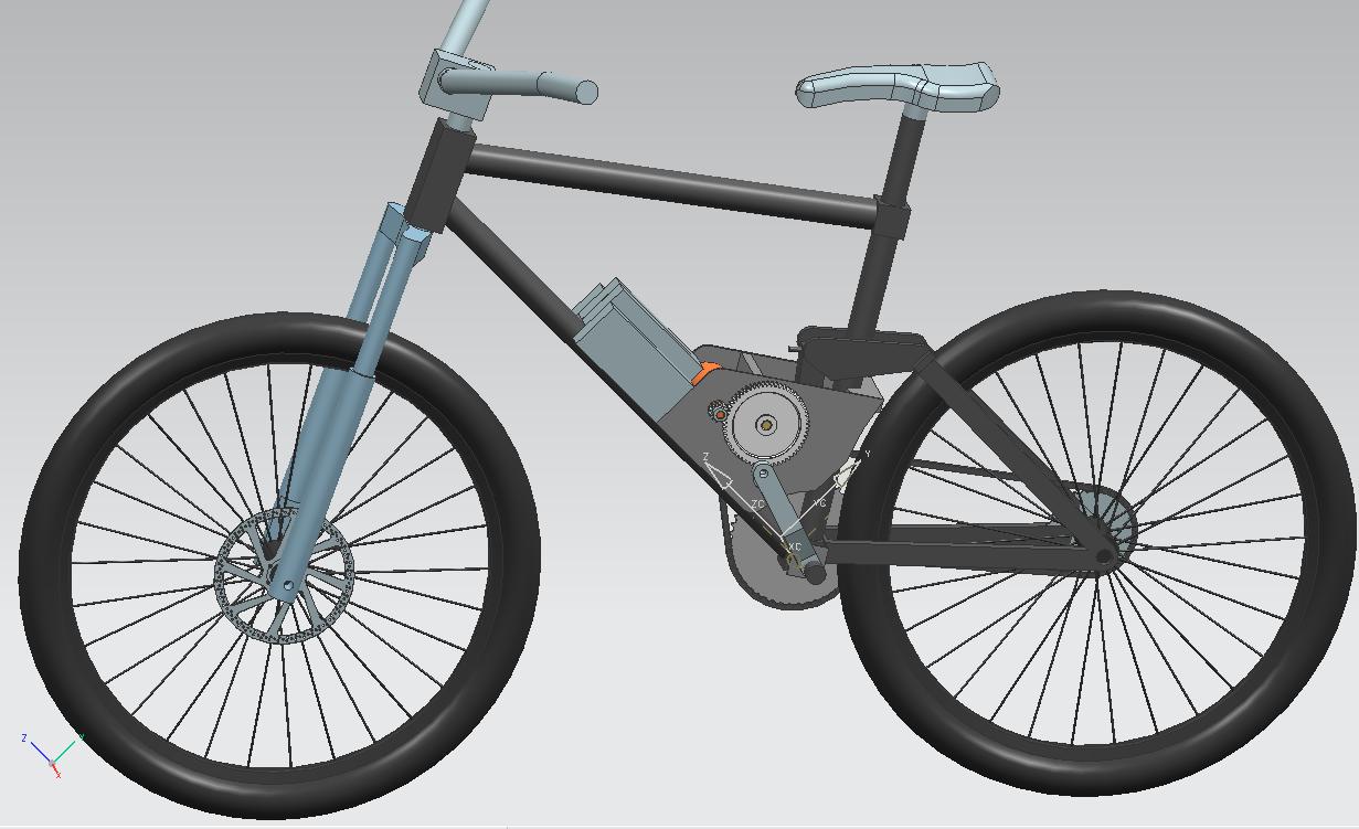

the motor could be mounted under the bottom bracket, the hubgear above. Inside the frame. I imagine a two sheet design like the tripendo (http://www.tripendo.com/) with blended edges. Wouldn't that be a beauty without an cables boxes mounted to the frame etc...
Such a frame souldn't be to hard to make if one has a good master plate like a great existing conventional frame 8)

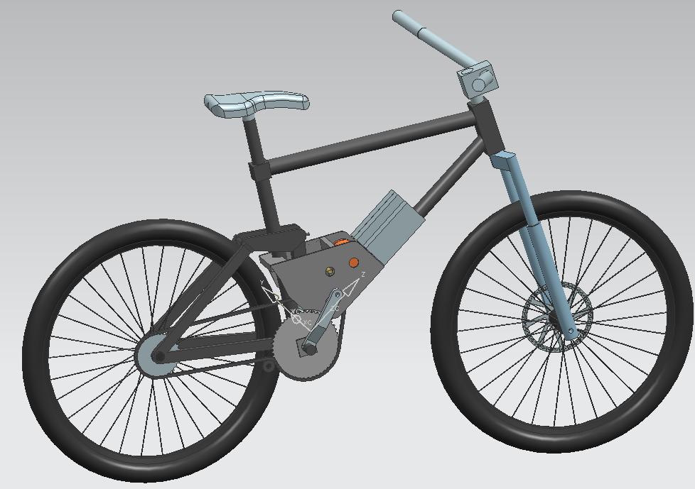

Postby crossbreak » Tue Apr 24, 2012 7:48 pm
It ran good for 450km, now my 8th and 7th gear are waste :( I get 35km/h in the 9th gear. Hill climb is also great. yet i could not find a hill that i didn't drive up at less than 22km/h.
now i got an i-motion 9 gear hub . I want to install a 52t chainring in the front, thats thi largest i can use without loosing more of the 20cm ground clearance. I hope it will survive this little motor and me...It's not yet completely installed.

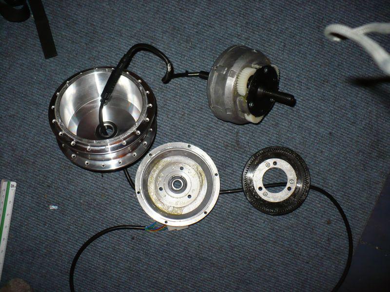

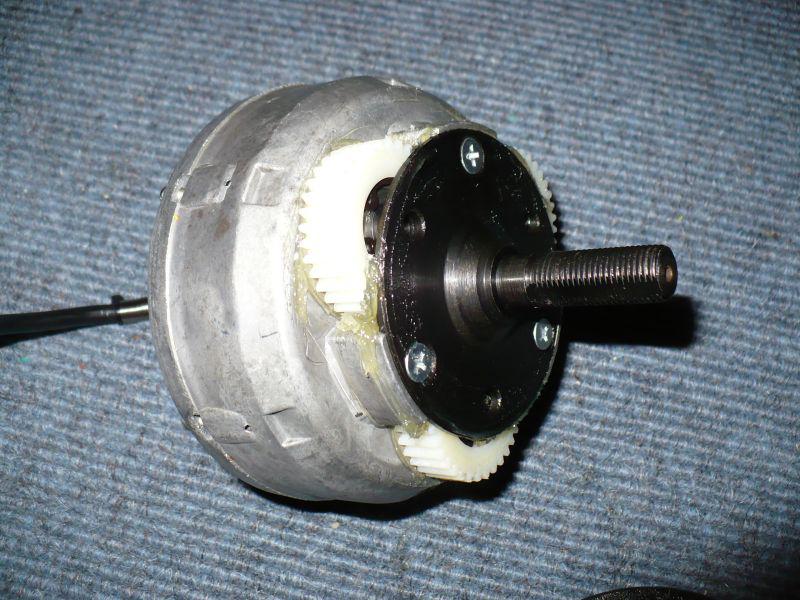

Postby crossbreak » Thu May 17, 2012 5:25 pm
A maintenance disassembly after 1000km (the motor has about 5200km on the clock now):
my parts for the next drive, isnpired by slawek's angle grinder drive (will be continued in another thread):

Postby crossbreak » Sat Nov 10, 2012 1:47 am
the motor has gone out of service in september 2012, since a grain of sand got into the friction reduction drive. I tried to repair it by turning the sun"gear" shaft around but it only worked for a hundred km. Then the struggling noise returned and I inspected the friction reduction drive again. It looked like a grain of sand got the drive stuck and all of the motor torque worked against it. The planet rollers got a punch indentation :? that's why I now abandoned the drive due decay :( It still works but sound horrible. The
motor is still fine, maybe i'll reuse it on another drive.
after all I can say this motor is great, but the reduction is not as efficient as it could be. A bafang is a much better choice IMO, even if it's heavier. The new keyde nano friction drive maybe special. Plz post info about it if you own one, into a new thread or the wiki.
plz don't post into this thread again since it's finished.
